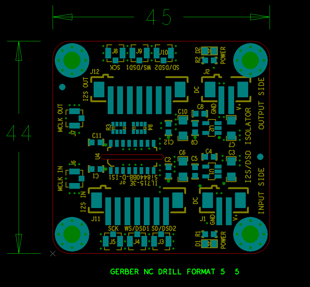

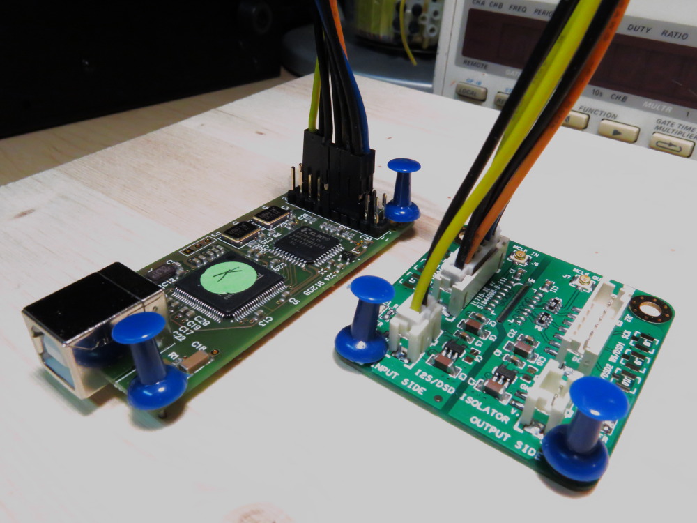

Universal I2S/DSD isolator for Amanero and other I2S/DSD sources
I have a WaveIO USB. But I’m not happy with the 2.5ns jitter problem on I2S output caused by XMOS, though it’s no longer an issue working with my FIFO. So, I bought another USB, the Amanero. But I did use it until today because there was not an isolator comes with it. I like PC music, but the PC ground.

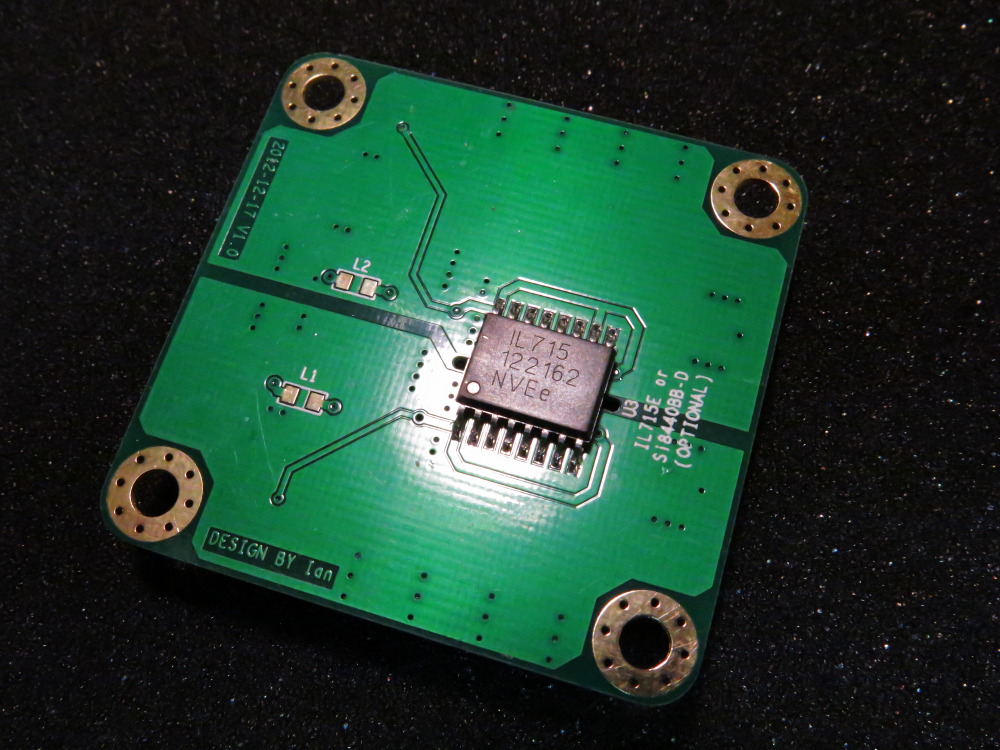

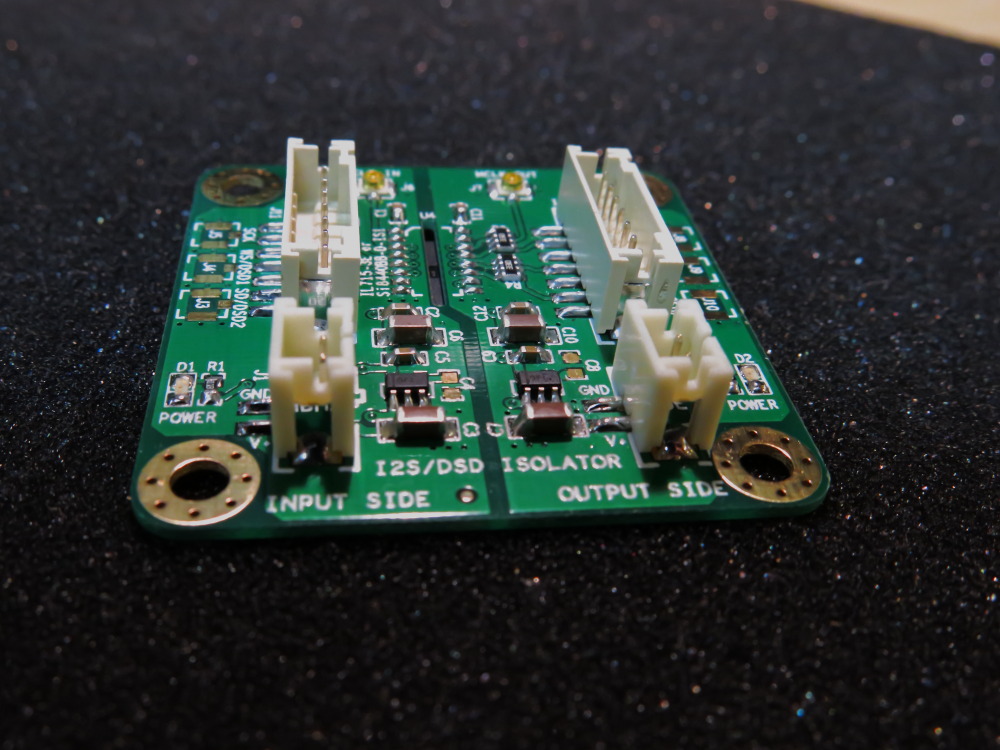

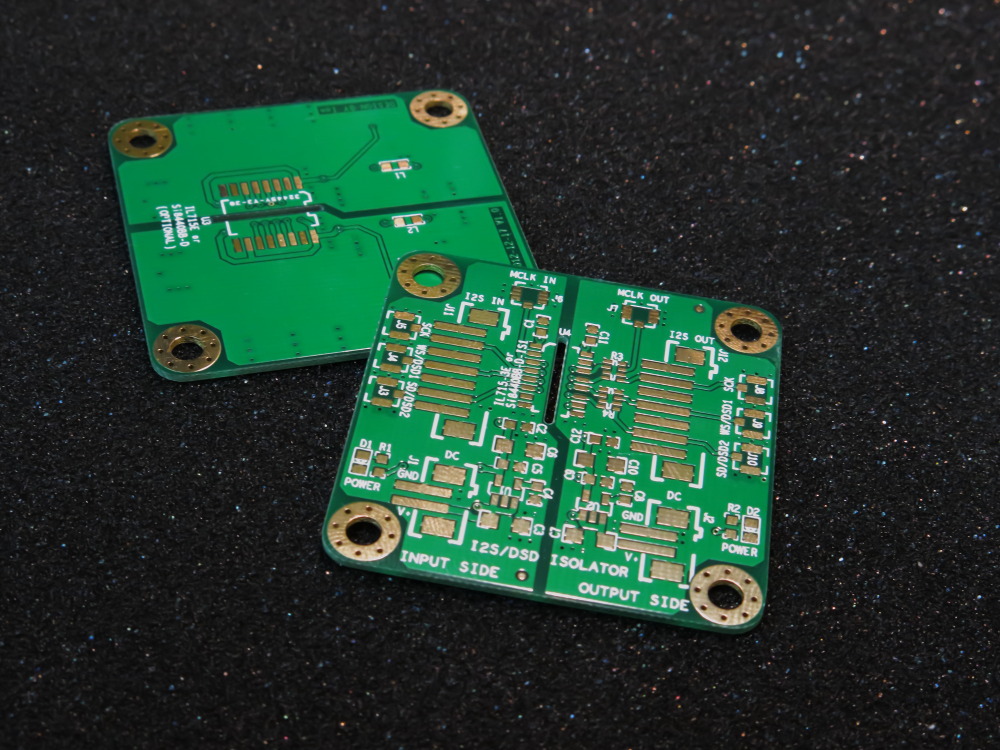

I realized a universal I2S/DSD isolator is a must for I2S/DSD sources like Amanero and others. It took me a couple of weeks for prototyping. Now you can see it .

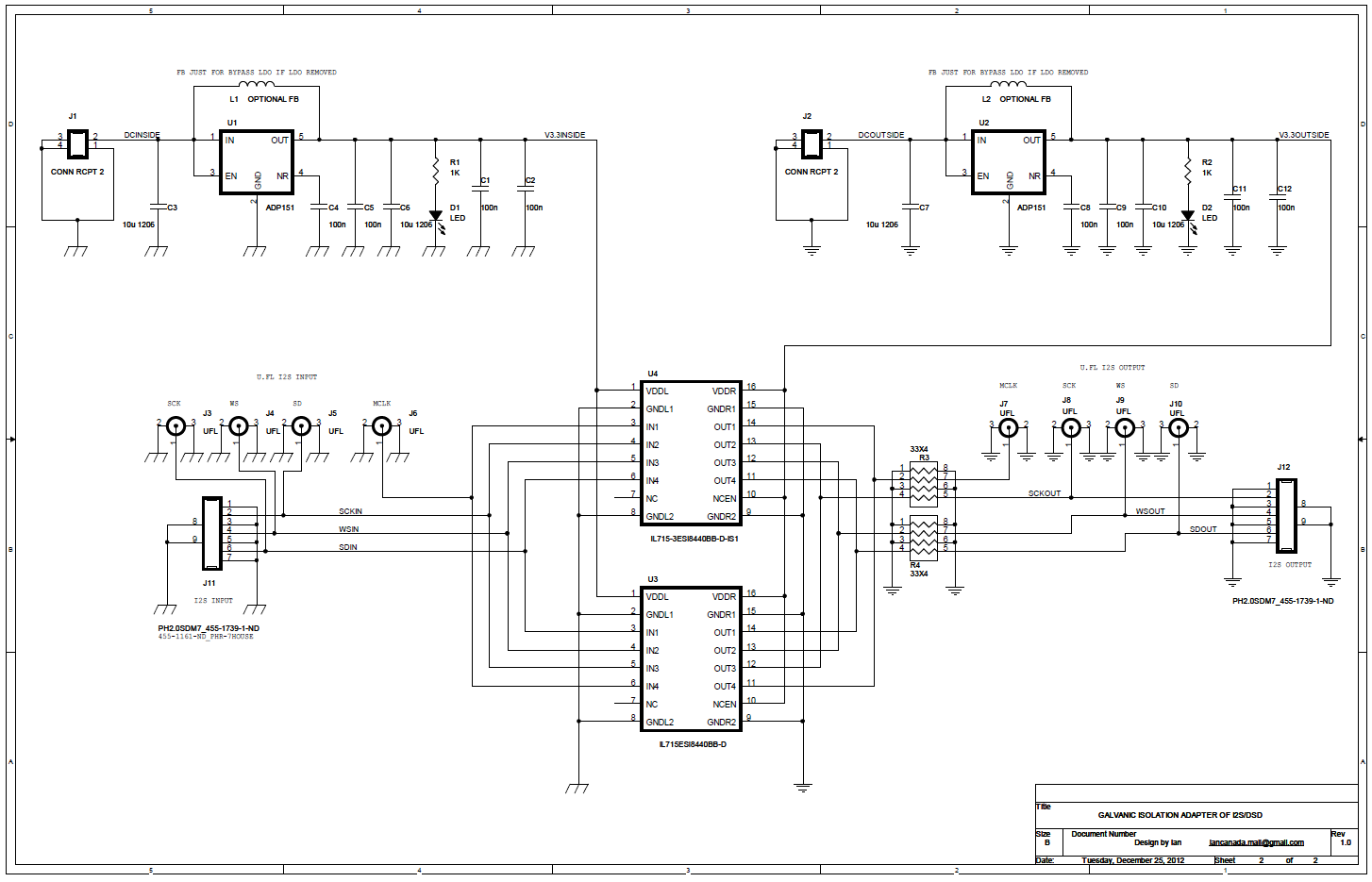

This isolator is nothing special, easier than the FIFO isolator because it just uni-direction not bi-direction. Four isolated signals including MCLK, SCK, WS/DSD1, SD/DSD2. PH2.0 and optional u.fl connectors are available for I2D/DSD signals. MCLK is in u.fl only. Two independent bypassble onboard LDOs for both input and output with LED power good indicator. I attached the schematics.
Almost all kind of 5 channel 16-SOIC-W and 16-SOIC-N isolators are working for this small board, including IL715E, IL715-3E, Si8440BB-D, Si8440BB-D-IS1 and others. 16-SOIC-N on top, or 16-SOIC-W on bottom.

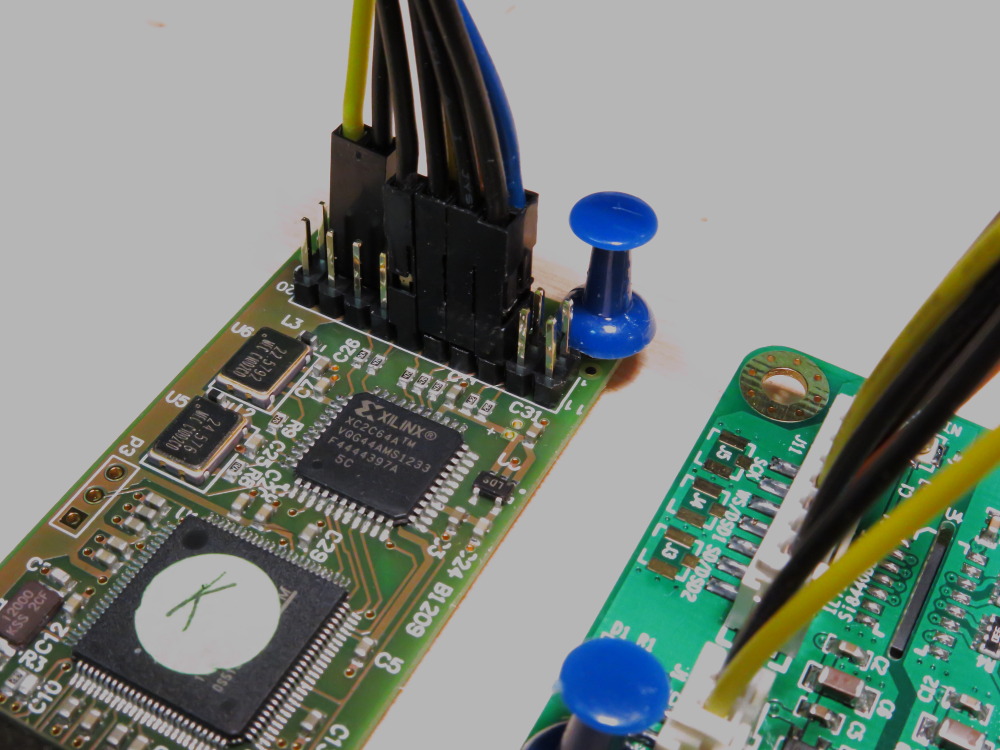

It works perfectly with my Anabero, right away without any hesitation. I’ll try the DSD later on.

Isn't much better to isolate the USB port rather than I2S? I mean using a true USB galvanic isolator capable to provide to the output USB port power from a battery pack or from an external power supply and not from PC.
why is it any better? the i2s is isolated then reclocked, certainly it seems as though the ESS prefers the clock domain to be powered/grounded on the dac side. here it makes no difference where it happens as long as its before the reclocking stage.
weve been through all of this. there is a theoretical benefit to isolate the i2s input as well, and then again before the reclocker, but both of these isolate the reclocker from the USB ground, for the same result. isolating the USB is not cheap and does not provide additional benefit as far as can be told.

Why I2S/DSD isolator is better than a USB isolator for digital audio interface
I can see there are two reasons:
1, Most of the USB isolators we can touch currently are for USB2.0 full speed 12MHz, not for high speed which is 480MHz. In this case, it will degrade the performance of many good USB audio interfaces which were designed optimizing for 480Mhz high speed, especially for higher Fs application as 192KHz and 384Khz.
2, Even when high speed USB isolator becomes popular down the road, I2S/DSD will still be the better solution than the USB isolator. The reason is very clear. Since we have to power the isolated section from DAC side, powering half I2S/DSD isolator comes with much less noise than powering a whole USB interface. The USB interface usually needs a couple of clocks with different frequency running at same time, not only drawing more current, but also introducing much more EMI noise from power supply and ground.
