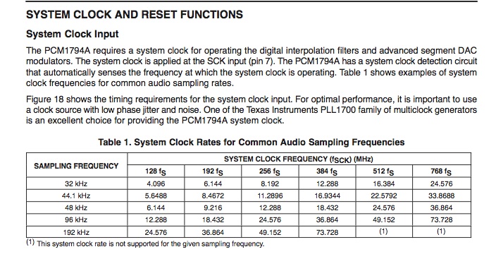

yep, I reckon thats your problem, this is with the digital filter enabled, it wouldnt seem to be able to deal with 1024xFS even with it on, with it bypassed all bets are off how its going to react, but it doesnt surprise me at all that its not liking the 45.1584/49.152MHz with 44.1/48kHz program material
and here in the first few lines....
someone really should have picked up on that....
try again with the faster crysteks but playing 88.2 or 96khz material, even if you have to manually upsample it on your computer somehow. what player software are you using? what computer and OS?
in plain language, the max clock speed even with the digital filter section enabled, is 768 x FS, so 768 x 44100 = 33.8688MHz or a more usual multiple that fifo actually does, 512 x FS = 22.5792MHz which is why the generic clocks are working.
System Clock: 128, 192, 256, 384, 512, or 768 fS With Autodetect

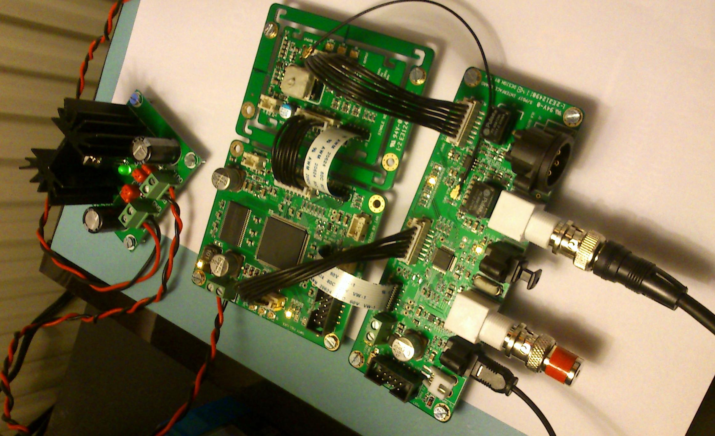

Hi all!
First of all I should thank everybody for the lot of suggestions! Great forum!
After a lot of experimenting and trying things I found out that my outputs
are Working....
After changing the clocks(45.1584and 49.152) for the generic ones (22.xx and 24.xx) I get output. I tried the singleboard before as well, but that did not work out, don't now for what reason.
My problem of thinking was that I expected the same frequency of the input
device. The fact is that it outputs the frequency of the Fifoclocks. In other words, in my case with the higher F clocks it outputs double frequency.
So I could not get locks on the expected F.
Other words, when I play 44.1 material, I expect the same 44.1 on its output.
But with the double speed clocking this is not the case.
But I am glad that the Fifo is working at least.
Maybe someone has an idea if or how this could be solved.
Thanks again,
Ed

The max MCLK of DIT is 512Fs, That means you can't generate spdif output for 44.1KHz with 45.xxx mclk which is 1204Fs.
http://www.ti.com/lit/ds/symlink/dix9211.pdf
I rember there was a note in the doc of dual xo clock double speed mode, please read it if it is possible.

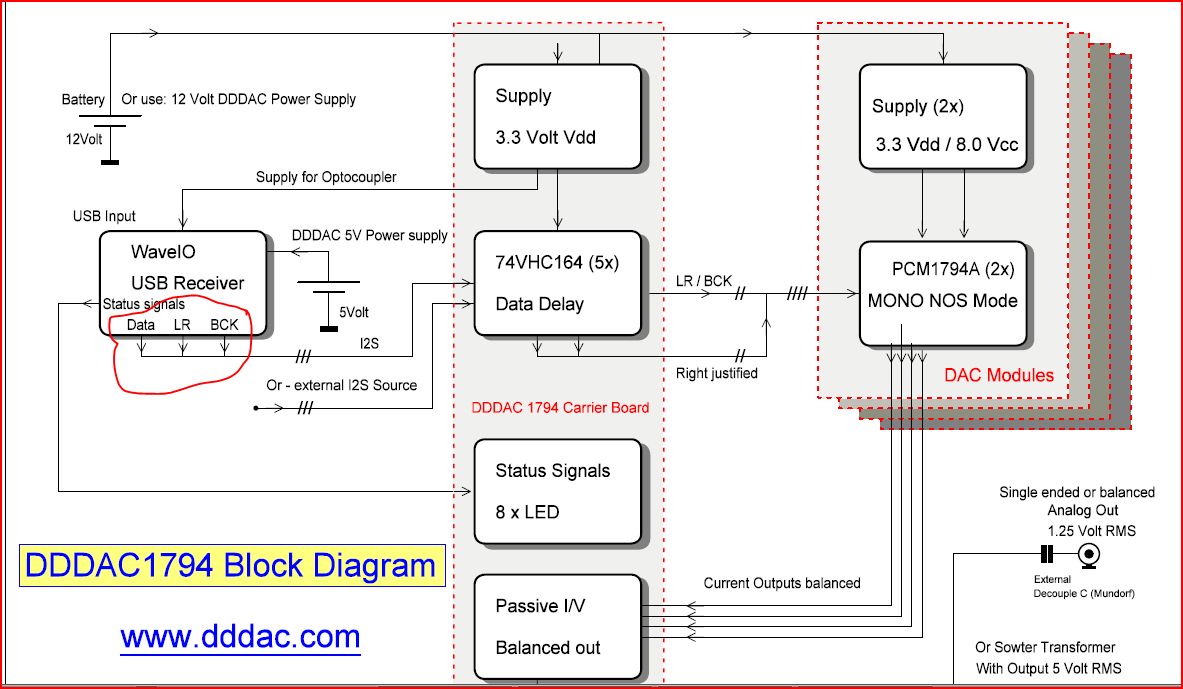

Hi Qusp,
The only connections to the Dac are: DT, LR, BC, Gnd. that's all. See picture.
Agree that the DDac1794 is a somewhat special solution. But it's sound is supurb! I can compare it with my BIII.
Besides the output frequency is not influenced by the Dac in my setup. When disconnecting the Dac totally the rusults are the same. DOUBLE clock F,
DOUBLE output F!
I can play any resolution with the dac connected. Even 384! No glitches. The static I had appeared not to have it's origin in the whole setup. Although I, on first sight, thought it came from de dac-fifo-setup but it proved to come from the computer.
For recording I used audacity and Audition 3.0 on W7 sp1.

I had a long detailed reply explaining this written out and the fuse blew outside on the electrical circuit so lost everything I was working on that wasnt saved, not much but I never remember to save long posts (its summer and everything is on) very annoying. this is hard work alright....
no Ed, you missed the point, the DIX on the fifo spdif is also likely effected. in fact its clear you didnt understand any of my post, the problem is not sample rate, it is the number of times the sample rate aka FS, is divided into the master clock frequency. to play 44.1khz with a 45.xxMhz clock, it needs to multiply 1024x aka 1024x FS, but the DIX chip which handles the spdif out and in, may be limited to 512x FS (unless the doublespeed mode Ian mentioned works) as almost nothing, including the 1794a will allow 1024x FS. ESS dacs do, maybe some others I dont know about do, but wolfson, Ti, AKM dont on any of their dacs, so the spdif chip really has no need to either.
so its actually using too LOW a samplerate with too HIGH a master clock, high samplerate will be normal, I bet you can output 96khz or 192khz just fine with the 45.xx/49MHz clocks.
is THAT clear enough?
I know now that the DDDac does the strange thing where it clocks both BCK and SCK from the same source.... in order to fool the dac, thankfully you are using the fifo because usually bck is higher jitter and the design asks it to drive 2 inputs. the flipflop on the dddac doesnt have termination either. interesting combo....
I had wondered where the clock was on that board, I did not even consider that it would be expected to be supplied by the source bck by default without any other option and mostly from 20cm or more away at the bottom of a stack of headers... that means some sources will supply the dac with pretty huge jitter. not fifo of course.
but on the upside, that means the bck and sck are the same, so wont be effected, thus why it works. similar to using ESS with the oversampling filter switched off, same deal.
its an intriguing design still, but wow... not even an optional onboard clock.
so potentially the si570 will allow this to work if it can be programmed to optionally supply a lower clock with lower samplerates, like supply 512 x fs for 44.1 so the DIX works. Until then you may have to use 22.xx/24.xx clocks if using the spdif out at lower than 88.2/96khz
