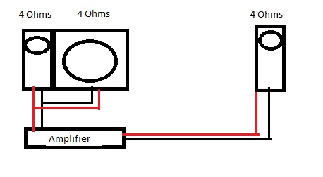

Asymmetric speaker system.
Satellite subwoofer systems are an effective solution to the problem of reproducing the bass frequencies in a speaker system without using the space that the more common two speaker system uses.
Having built a satellite subwoofer system in the past, I was able to appreciate the decent performance afforded by even a rudimentary system, however the placement of the subwoofer on the floor proved problematic.
One solution I have been looking at is the placement of the subwoofer adjacent to or inside the enclosure of the satellite speaker, either in a forward firing position as shown in the 3D graphic here or as a sideways firing driver, since directionality is less important for the lower frequencies.
What are the possible problems that could occur in such a system, and also what sort of dummy load is to be used if only one subwoofer driver is to be used - for example attached to the left speaker which will have an impedance of 8 Ohms for example?
Some info here, but I have not found answers yet to my questions.

The satellite subwoofer system I built was hooked up to speaker outputs of a CD-Casette player, by cutting the speaker wires and re-routing the wires to speaker terminals which I fixed to the case. It worked well enough, but having 8 Ohms impedance on one side and two 8 Ohm loads in parallel on the other side. I detected no soound level difference on the left/right speakers, and the amplifier section survived several years usage.
So this was a single amplifier circuit driving two speakers as well as a subwoofer (actually an 8 inch speaker in a box) hooked up in parallel to the right or left speaker terminals.
Apparently the commercial systems are different, using two amplifiers ? This one for example puts out 14 Watts:

Satellite Subwoofer wiring
So it comes down to how to connect the subwoofer driver without damaging the amplifier or quality. Will this work?
Any additional components to be added - resistors, inductors, dummy loads etc?

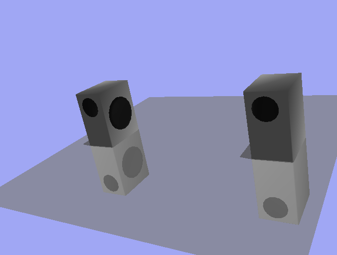

Updated design with side firing woofer
I updated the design: the earlier design looks too cumbersome.
I have only once seen a commercial system with a side - firing woofer, and it seems like a good idea to save space and preserve appearance. The woofer will be probably 8 inch and the front speakers will be full range. There is a the motivation to add a tweeter. As before, the asymmetric loads on the amplifier is what I am concerned about.
Looks like there are some out there:

I would not suggest a dummy load of any kind for a transistor amplifier. That's just wasting power. The amp channels don't care if they're loaded differently, but you don't want the impedance to get too low.
If you want to stick with a passive system, a more common approach is to use a dual voice coil woofer for the bass section. Both left and right amp channels can then be used on a single woofer.
A passive crossover on the various speakers will prevent the impedance from dipping too low and also improve power handling/distortion performance.
Can I get a rough estimate of impedance using a multi-meter, that is, 8 Ohm speaker will measure 6 Ohms across its terminals.
For a raw speaker, yes.
For the combined effect of multiple speakers with crossovers, no. What you are missing in this scenario is impedance at various frequencies. When you measure resistance with a meter, it's DC (0 Hz), so all you see is the resistive contribution of the speaker/crossover at the lower end. There are also reactive effects, but that's a more complicated topic.
If you try to measure impedance the old-school way (voltage divider method) with a signal generator, resistor, and multimeter, you'll need to ensure that your meter has decent accuracy across the audio range. Many don't.
Hopefully you're not taking any of this as discouraging. Many people start out with minimal testing abilities, but still have fun and produce speakers that are useful and enjoyable as long as they respect some basics and are willing to tinker a bit.
It sounds like you got away with the setup you ran previously, where maybe you didn't use a crossover at all? Assuming both your satellite and extra woofer were 8 ohms, the combined load was only 4 ohms, which most transistor amps will handle fine. If the amp doesn't get hot or have other problems, you're typically OK.
