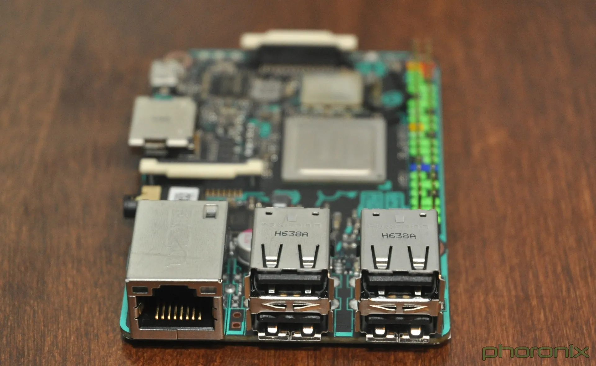

I recently found a nice site that compared the Pi 3, Tinker board, and some other platforms:
ASUS Tinker Board Is An Interesting ARM SBC For About $60 USD Review - Phoronix
The Tinker has about 2x to 4x the floating point processing horsepower when comparing single core processing. For example, the FFTW benchmark (FFTW is the core of FIR filter processing code) has the Tinker at 4x the Pi 3. For the software DSP processing that I do, that's nice because it's all FP operations. Also the Tinker has separate USB and ethernet chips whereas the Pi runs the ethernet through the USB interface. I tend to use USB based audio interfaces, so its another area that is an improvement over the Pi 3.
I like the Tinker a lot. If the OS can mature one more cycle I think they have a very nice product. Even as it is now, it's better than the Pi 3 for audio DSP type work.
