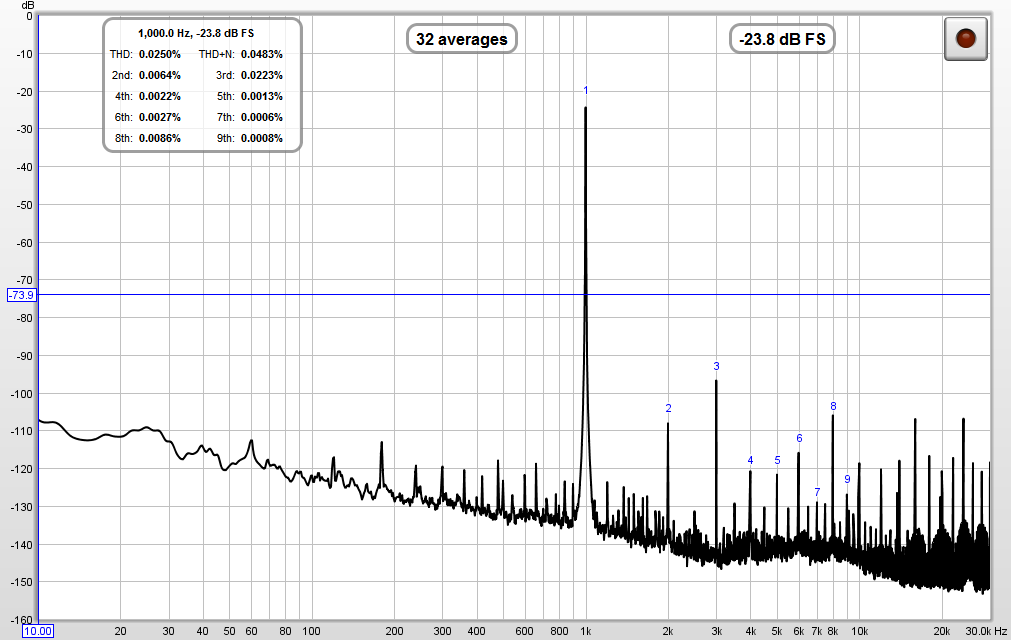

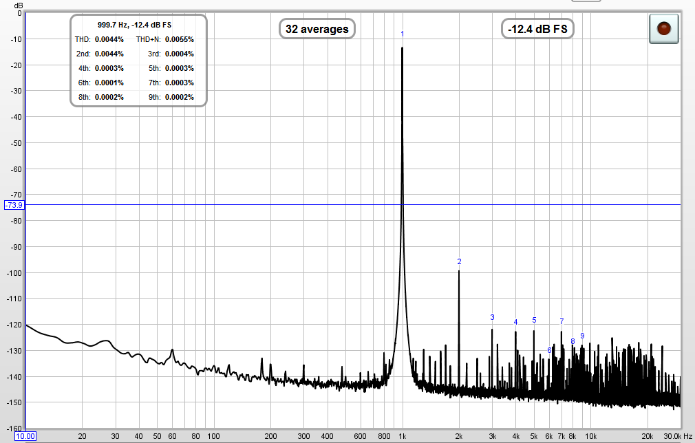

I finally set up the Tinker board that I bought. The process was easy, and similar to the Pi. In general use it seems much more "snappy" (responsive, faster) than the Raspberry Pi 3. All of the Tinker board hardware testing posted to the web bears this out - it's several times faster than the Pi, both CPU and GPU. At $50-$60 the Tinker board is worth the upcharge over the $35 Pi when using it as a small computer. The Tinker board does run hotter than the Pi by 5deg C or more, when using included heatsink (just sitting out on the desktop and not in a case it was over 50C after very light use).
I ran a quick tests both on the onboard sound, and using an ES9023 USB stereo soundcard that I know works pretty well on the Pi (so that I can compare measurements). This is just a spectrum and THD on a 1k test tone generated internally on the Tinker board. Conclusion: the onboard sound is somewhat noisy and not all that clean (not low distortion). That is about what I would expect for an onboard sound codec on a SBC, honestly. Even an under $50 external USB soundcard smokes it. On the other hand, for casual listening via headphones the onboard sound is just fine but I would not use it to send audio to my stereo.
The ES9023 card was almost exactly the same as on the Pi 3, so no difference there.
Measurements attached. If you are not sure which is which, you aren't paying attention.
- PC Based
- Asus Tinker
