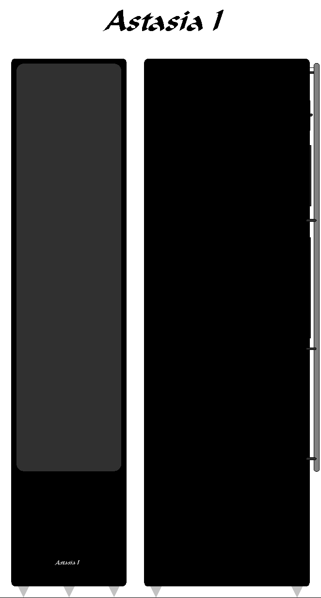

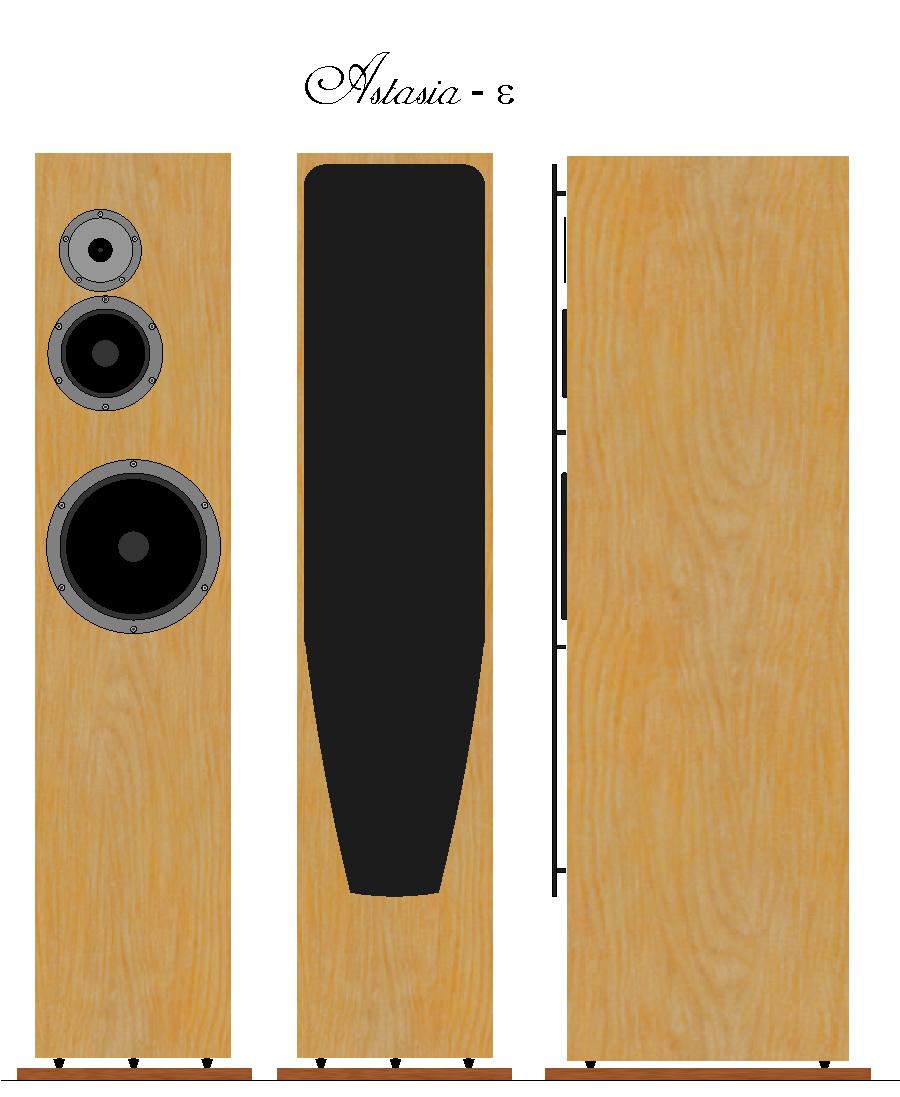

Regarding the look and feel of the loudspeakers, Originally i was planning to have a wood finish : (my first simulation)
but finally Madam Waf ... decided .... (we all have to negociate sometimes... i manage to have new "BIG" loudspeakers, she decided the color of the Loudspeakers 😎 and everybody is happy

Hi Gilles
Nice sketches. I own MONITOR Audio RS-8 with cherry wood and the look is fantastic (it passes the WAF). I was wondering if you have a plan to design a smaller version of speaker for peoples with a smaller listening room...

Hi Fab,
In fact Madam was ok with wood finish, but she prefers "piano" black.
On top of that as you mentioned it these loudspeakers are "Big", so the black color helps to "optically slim " these loudspeakers.
