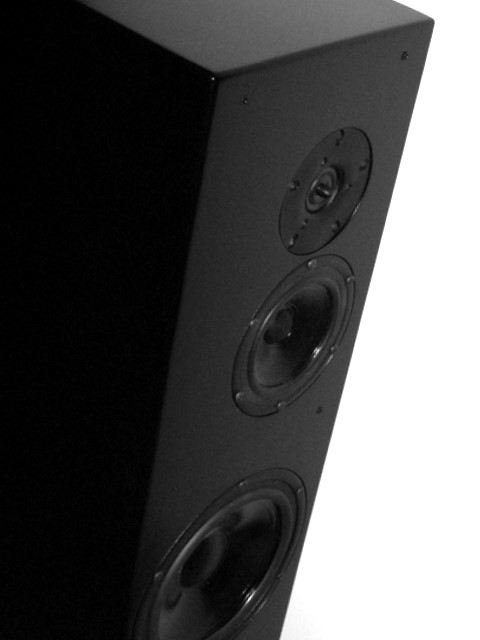

Regarding the look and feel of the loudspeakers, Originally i was planning to have a wood finish : (my first simulation)
but finally Madam Waf ... decided .... (we all have to negociate sometimes... i manage to have new "BIG" loudspeakers, she decided the color of the Loudspeakers 😎 and everybody is happy
Brgds - Gilles.
Hi Fab,
In fact Madam was ok with wood finish, but she prefers "piano" black.
On top of that as you mentioned it these loudspeakers are "Big", so the black color helps to "optically slim " these loudspeakers.
A Small Version of these speakers ????
I've no plan at that time, but you can if you want reduce the BR volume down to 40-45 liters (copmpares to the actual 62-65liters), using the CA22 - you can do it . But in that case you will not have the same level in Bass ... As a reminder, troels Gravesen for its PMS Loudspeaker did a cabinet of 40 liters with the CA22. - So it is possible.
Another option could be to use a Ca21, that requires less Volume than the CA22. the filter is exactly the same (slight change in the Med and tweeter level) - Note that I've simulate this filter as I've the CA21 measurement files.
BUT, you have to know that I've done a diffraction study on these speakers, and the position of each speaker has been determine precisely in order to minimize the diffraction - And everything is linked to the shape of the front panel of the loudspeaker.
In Clear .... If you want to reduce the volume with almost no impact on the xover, the unique way to do it is to reduce the depth of the loudspeaker. If you change the height, this will have an impact on the diffraction study I've done. I don't say that it cannot be done, i just say that this will have an impact.
I've just calculated that you could have a 25cm x 25cm x 116cm Loudspeaker with 40 liters. it is better than the actual 25 cm x36cm x 116cm.
If you want something even smaller, then the concept of the Astasia does not fit. ... or you will have to find a speaker requiring less volume, but in that case this is another story.
hope this will help.
Best regards. - Gilles.

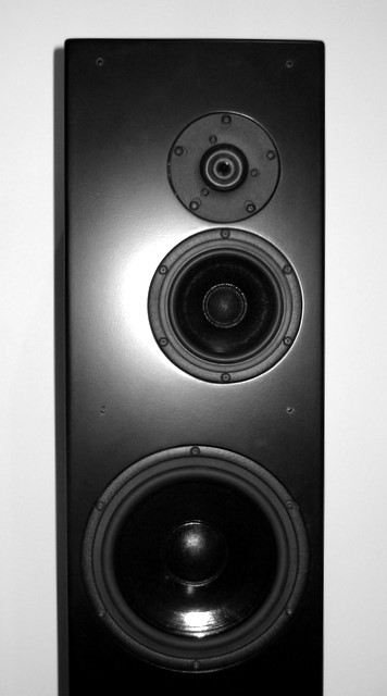

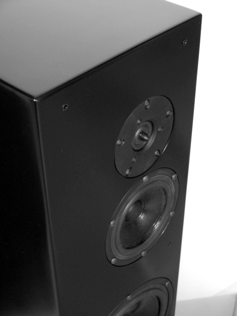

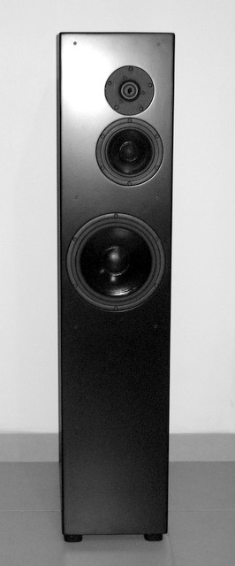

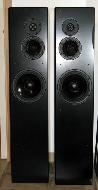

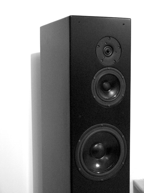

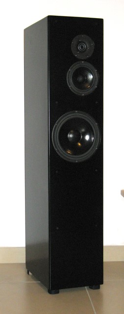

I have finished my Astasia 2 weeks ago. They sounds awesome. It's the best DIY speakers I ever ear. You can easily compare them to commercial speakers of $4 to $5K. for the price of $1.2K (CAN).
Thanks a lot Yuli_35 for your fantastic design. You did a great job. I hope more DIY will start an Astasia project to feel the pleasure of earing a sound of high quality.
Here's mine.
[/IMG]
Reactions: e_fortier

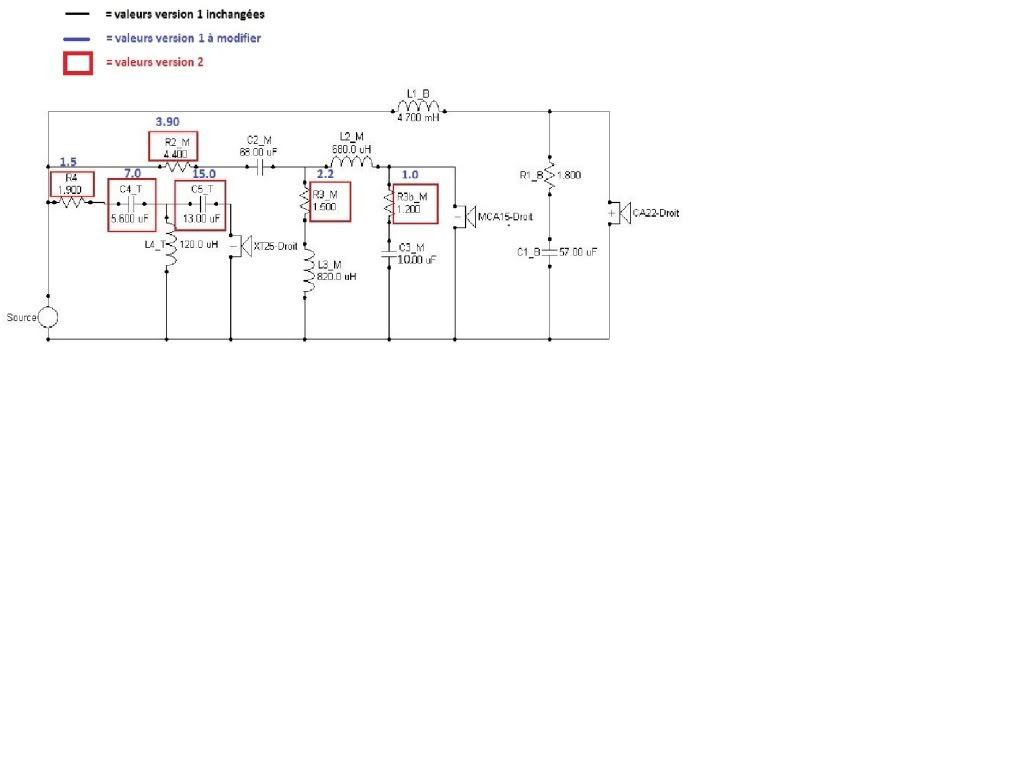

Here is the revised schematics of the XO after a year of earing and tuning by Denbret. In the red box you have the new value. In blue, above the red box, it is the old value.
I have done those modifications on mine and I assure you that it is a +
