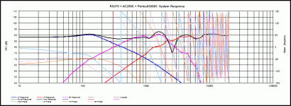

I recently revisited my Lambda build. I wanted to try an AMT (ac 2560) tweeter in place of my SB29. So I started by using PCD to completely reevaluate the original design and XO and make changes as necessary. Please keep in mind i am still learning so I am asking for patience for my beginner abilities. I am trying to include the graphs from the tool but I am having difficulty figuring it out. Anyway the response is ragged and I tried lots of ways to try save/upload images of the summed Fr I am having trouble. Help? Thanks 😱

Go it. I was looking elsewhere. Ok so this is a 3 way hybrid OB sealed RS270 1.6cu ft, 830883 OB, and recently wanted to try an AST 2560 in place of my SB29. XO points are 300/2500. So I tried to sim the XO using different slopes, frequencies and it looks ragged no matter what I do and doesn't sound so great.
OK I forgot to mention it is LR2,LR2, LR4,LR4.
In the past (with the SB29) it was all BW2. I know that the peerless has some cone resonance at around 5k so I tried to put a sharp filter on it or XO lower to avoid it. ALso the AC has a shelf 9-12khz

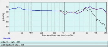

sorry to keep clarifying, but I meant phase "for each" speaker, so the three different phase lines, not "total phase". We need to see exactly where each speaker is phasing with the next.

I'm looking for the graph in PCD that you posted, but instead on total phase, uncheck that and check individual driver phase, so you will have 3 FR lines and 3 phase lines (1 of each for each speaker). Post that graph so we can see the actual FR and phase relationship for all the drivers.

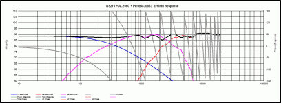

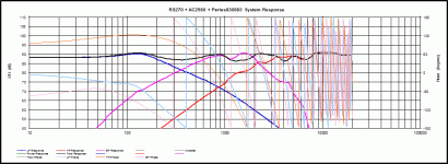

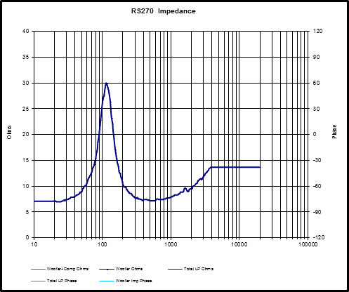

Ive attached the ZMA and individual phase. Looks cluttered.Could/Should I declutter it and do single graphs?

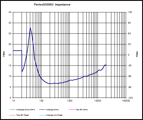

Can you reverse phase of the mid and tweet and post that graph w each individual phase? It doesn't look too bad right now but there may be an off axis problem with the OB.
Also how are you measuring? Distance? And window in ms?

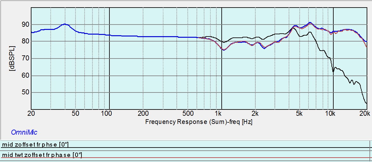

After going back into omnimic and summing and overlaying I get a z offset of 1.22inches. Sounds reasonable, no?
Although I have not used PCD, I wouldn't be asking it to adjust the offset if you didn't move the mic during the measurement, because the delay would be included in the measurement. I'd set the Z offset on both to be 0. Would you agree bullittstang?
