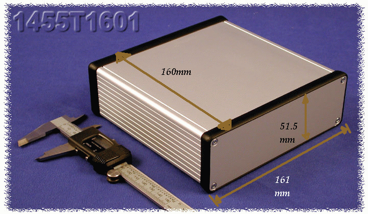

Here is an URL to: Hammond 1455 extruded aluminum chassis. These are available as either anodized black or natural aluminum. Mouser stocks them.

Hello Carl
The Hammond case 1455T1601B do have 160 L x 161 W x 51.5 H mm
It's one of the larger case, they don't go more than 161 mm of width for the flat face side.
Bye
Gaetan
Thanks Carl for finding the boxes. Those are definitely not die-cast, it is extruded and very nice. I like this one, there is a lot of space inside and the size ratios make it look very attractive.
