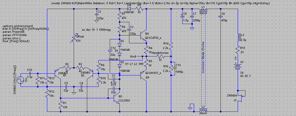

I think there some things regarding grounding that need to be agreed upon.
1: Is our ground connected to the chassis, which is basically a huge antenna unless connected to earth ground? Some houses, mine included, have no ground connection! So perhaps we should treat the chassis as an RF shield rather than absorber. Does someone have experience to offer?
2: How are our signal ground and earth ground isolated, or are they at all?
We need to come up with our grounding scheme. Then we can decide whether we need virtual earth and how to implement it.
This is what I suggest:
1: Signal ground connected to negative rail.
2: Power ground connected to capacitive virtual earth as in schematic. (I deleted the top capacitor in the schematic since it improves PSRR)
I don't know if signal ground and power ground being connected is a problem for a headphone amp. I see nothing wrong with this. I think we could still get better PSRR if we removed decoupling from the input and made it so that it followed the virtual earth.
In any case I like my virtual earth solution better than the EF virtual eartth because it has lower impedance and is more cost effective, and think it should be used if we decide on a virtual earth grounding scheme.
PS. We should hold an official vote, we really should (possibly through the poll system?). Things to include: relay-switches, multiple headphone outputs, multiple headphone impedances, onboard or outboard supply, etc. I'm sure there are plenty of silent viewers who would vote.

Hi KT,
I would be quite OK to connect virtual ground to chassis but NOT to IEC ground. This would also scotch any RF if it is induced.
You could join signal and power ground, but keep IEC ground from the power socket connected only to the chassis.
I will go with Nico's suggestion, KT, because it has been used before with great success and the transistor virtual earth also offers a DC as well as an AC path which has to be good for bias currents.
Both transistors can be TO126 BD139/BD140, very cheap, while the complexity is higher, it's a belt and braces approach and covers all current bases.
You should have a cap on both VE resistors, not just one, and the signal and power earth could then be taken off the negative rail and placed on the centre, Virtual Earth as originally suggested. This will deliver the current nulling for very quiet noise outcome, and ensure that there is no asymmetrical switch on pulse.
I do not believe a vote is appropriate; we are seeking the right answer, and truth is not always amenable to a vote! In any event, I'm knackered, so my answer is short.

So your reasoning is that the socket ground is polluted with all sort of garbage? I was wondering why most plug-ins only have 2 prongs...
You are right about voting... In this case it should be fine to bring up a list of things to ask you about, and if anyone has a reasonable argument changes will be made if necessary. I won't have time until 4:00 (GMT-6), but someone will have to read through posts a few or more pages back and write up a list.
I'm not sure whether this is significant:
What does it matter that we connect chassis to either power ground or signal ground? We could also connect the chassis to the positive rail, but what affect would this have on the circuit, or is it significant at all?

Hi KT,
I actually thought Carlos was lurking in the shadows somewhere not sharing his thoughts. (I am just kidding, I wanted to see your response)
Anyway, the program that I use for schematic capture and PCB design is called Easy-PC from No.1 Systems (Number One Systems :: PCB CAD Software :: Home of Easy-PC PCB Design)
And I use MicroCAP9 (Main Redirect) for simulations.

I agree with only the safety ground to the chassis, we will have the least interference problems but comply with safety standards.
Hugh you may want to specify your transistors as well, then that is out of the way. I am convinced that this is of sound design as it stands.

The VAS is Toshiba 2SC3423, bias diodes 1N4148, outputs 2SC4793/2SA1837.
I have decided to go for BC557B (or C) for the input devices. This is a 300MHz device with very high gain and very low noise. It's rated to 45V Vceo and 100mA cont, more than enough. It is optimsed for 1mA-20mA collector current and widely available.
I think that's enough to get started on the pcb?
Hugh
Hugh

Good point. Here are the eight significant voting features, the rest are technical parameters now set in stone. This will make it simpler for Gareth to do a spreadsheet (polite request??) and tabulate the results for all to examine:
1 Line out
2 Crossfeed (switchable and adjustable)
3 Multiple output (two sockets)
4 Selectable series output resistors (120 Ohm & 10 Ohm)
5 Wall wart 24V regulated
6 Muting switch
7 Ipod input
8 Tone controls
Hugh
