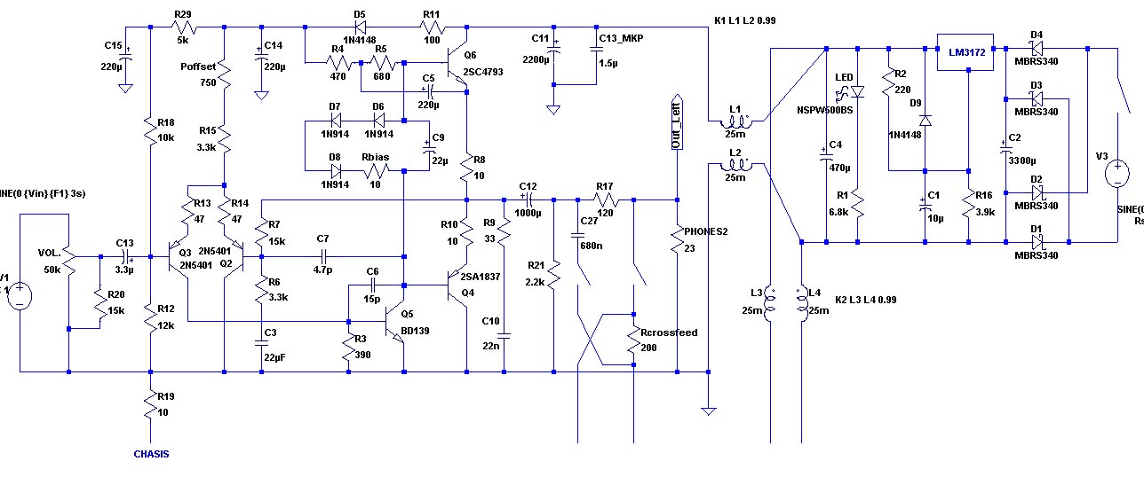

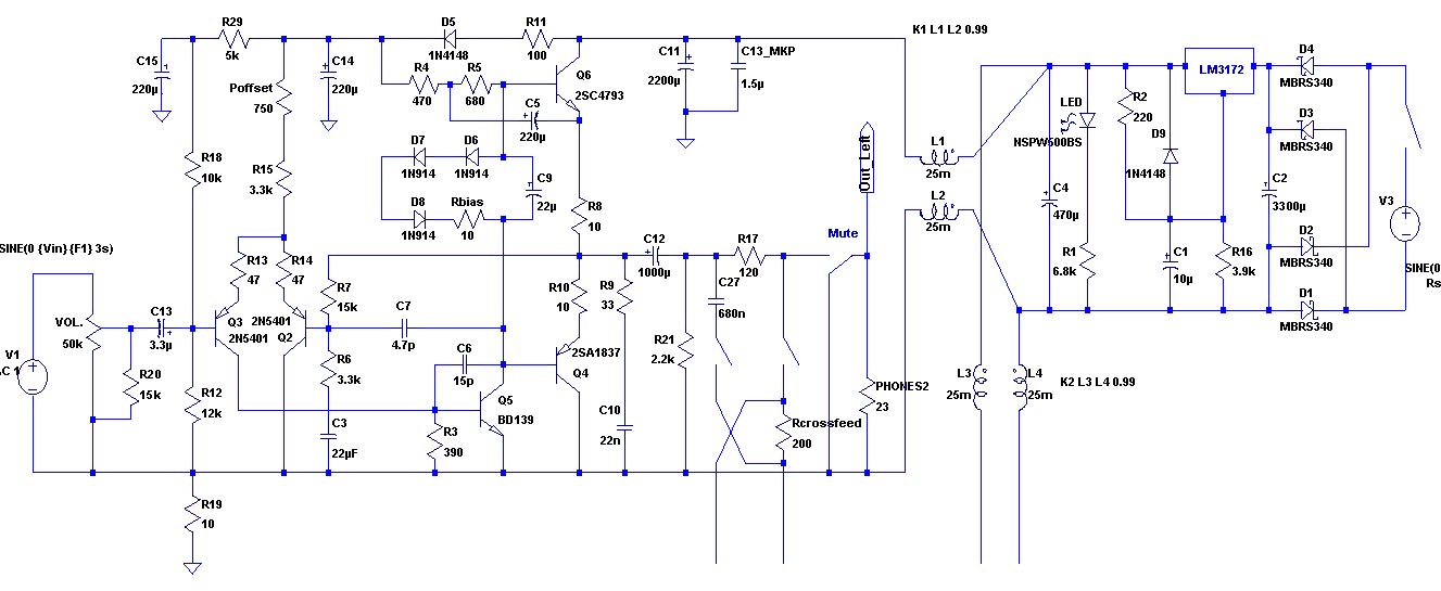

How are we doing with the overall schematic now ?
I've attached a kind of summary - probably has several errors but perhaps now's a good time to start pulling together a 'reference' plan. KT has most of this in sims already which might be a better starting point - I don't even have the regulator placed properly !

Hi Gareth,
It needs a resistor to ground after C12 to bleed the DC voltage that can build up. 2.2k should do.

What is the purpose of mute if R21 is present? I was under the impression that mute was for headphone protection during cap charge-up.
Gareth, which coils are you using, where can I see a footprint.
Furthermore I see a number of ground signals, where is ground? It is tied through 10 ohm to negative, why?

If you tie the capacitors all through 10 ohm to ground then you forcing the caps to have ESR = 10 ohms, this is not good.

Furthermore I see a number of ground signals, where is ground? It is floating somewhere in space.
Nico
I'm half-expecting some further discussion on R21 as to whether it should be smaller, adjustable or swithable, but you are right, if we leave it as is we might be able to simplify further.
Coils - I haven't looked at all the suggestions yet, sorry no footprint
Ground - This needs some discussion to avoid 'hum' etc. I had envisaged both channels floating above the chasis, the 'lower rail' connected to the chasis through a bridge rectifier, which further separates the channels from each other. I saw this somewhere on one of Nelson's designs - should I draw a diagram ?

I don't think I've understood my error yet ? - I'm looking at caps as being between rails or between 'a' and 'b'. I don't worry about where ground is at all, I only look where currents flow. The idea is, I can put ground anywhere on the circuit - it's just a point of reference ?
Hi Gareth, because of the single supply, the "ground" is effectively the negative supply. Now looking at C11, C13 they are tied through R19 forcing their ESR=10 ohms.
Also have a look at the signal current, if the signal swings negative (in other words Q4 turns on) how does the current flow?

OK, here's how I see it. C11 and C13 are there to decouple the 'upper rail' with respect to the lower rail and NOT with respect to the chasis. So R19 is no hindrance ?
Ask away, I'm not a shy person 😎
But that's not what you have drawn. C11 and C13 are shown as connected to "earth" and R19 connects the negative rail to earth. If you connect C11,13 to the negative rail instead, then R19 is not in series with the caps.
Do you need an earth connection with a 25V rail? It's already isolated in the power supply. Also, if a wall wart is used, it won't be earthed anyway.

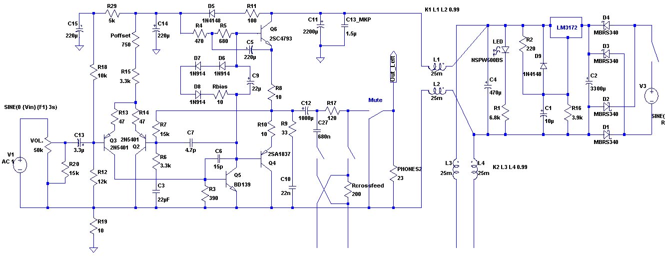

Yes - you're right. I said the right thing but didn't draw it that way.
Here's an updated drawing - I've remove the mute switch - we'll put it back if the 120R resistor is questioned and removed before we finalize.
Note that the "Rcorssfeed" is supposed to represent a potentiometer for user adjustment.
