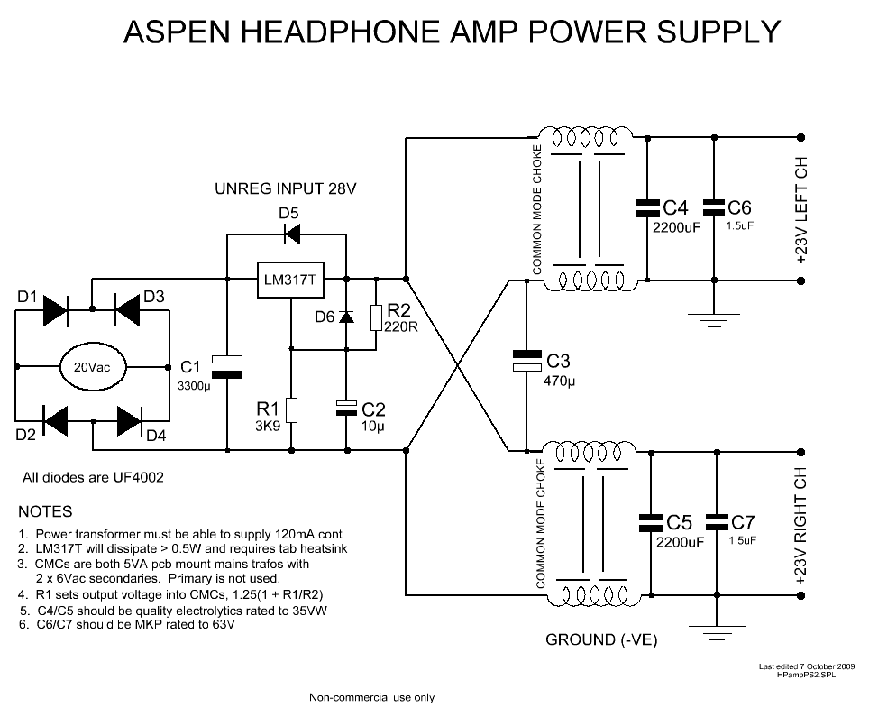

there is maby beginers who read this thread and could not go into very much more than the basic schematic gived by Hugh.
If the power supply is not more complicated than the amp, and the parts or substitutes readily available, then this should not be a problem - especially so as boards or board designs are intended. I think that the hardest thing is sourcing all the right parts, in all the right sizes. If you can, design the supply with as many of the same parts as for the amp. The assembly with a labeled board is straightforward.
I like these simpler DIY projects as learning tools to try some different things. If others like to do the same, this may be a good reason to have some flexibility in power supply choices.
Sheldon

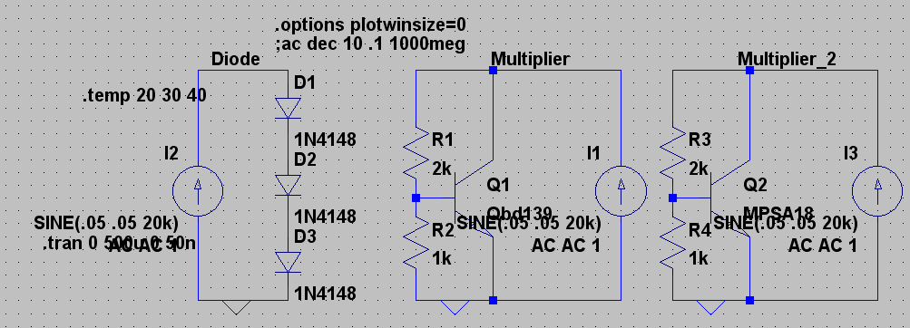

I know this is out of sequence as we're talking 'power supplies' but I got a little question on the amplifier that's on my mind...
The bias set up. We have 3 diodes because it is simpler than a Vbe multiplier. I have only used the latter and find that it's easy to mount a transistor on a heatsink. How do you mount 3 diodes on a heatsink ? - would we actually be better off with a Vbe multiplier ?
(Either way, I'd want to keep a resistor in the string so that we can 'set' the bias current)
Hugh just provided this.
Looks good to me. If we go fancy we can mount the chokes at right angles. 🙂

I once did a comparison between the Vbe multiplier and the diode string.
For some reason I cannot fathom, with the same circuit, same bypass cap, etc, the diode string sounded a tad more refined.
I suspect there is less variation in voltage with current change.
Hugh
You're going to tell us that you can hear the difference between bi-direction and uni-direction speaker cables next 😉
Maybe we should simulate.
In this team, you are the guy for this - it's an interesting question as to the differences, a much wider topic than the headamp and quite possibly will draw some further attention from others who haven't previously given this thought.
The psu design is great. Honestly. Pulling the regulator back by the rectifiers puts all the non-linear elements together and far away from the amp. The amp 'sees' caps and coils. Sometimes you don't know it's the right solution whilst toiling away, but I often get that feeling when something just seems to slot into place with ease and this one is it.
p.s. I like Vbe multipliers.

Look, doesn't the diode have a better curve?
Of course, a BD139 isn't going to make a good multiplier anyways, because of it's small current gain. The base current causes error in the divider. We've switched to an MPSA18, now look how nice that is? I guess I have very good intuition, I should stop ignoring it. CFP Vbe multiplier, anyone? 😉
The diodes also have less phase shift.
So YES, if you were using a fat, low-gain transistor for the Vbe multiplier (which is pretty much always) then there was some difference. I vote that if we use a multiplier, we use a high-gain transistor to best approximate the diode curve. (but the diodes still take the cake, for having that perfect spherical curve... 😉)
I also ran a temperature simulation, and you can see that the MPSA18 multiplier beats the BD139 in that regard too.

sorry, I wasn't trying to make any fun of this, I was poking fun at Hugh but I meant exactly what I said with regards my respect for you use of Spice and your insights into the Vbe multiplier workings. I'm a bit lazy, I simply view the Vbe multiplier as a drop in 'module' that works and that's about it. I use the BD139 for this purpose, never crossed my mind that there might be a better choice. I also like to run simulations - much more so than Hugh, I find it a good learning exercise and more relaxing than building things (lots of opportunities for frustration when you try to build things). I've been playing with the Zen amp for the past few weeks, multiple simulations and a prominent Cap Multiplier !!!
