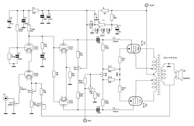

My idea to use a 6sn7 Cascode as an input stage has (of course) been done before. I always Google in different languages to find new things and voila [img1].
After playing some more with the sim in my previous post I ended up with values close to the one in this schematic (before I found it).
I will be taking this route: Cascode + long-tailed pair phase splitter + UL output
Again, thanks for all the help and brainstorming.
P.S. the schematic is missing a 1uF cap in the phase splitter but this was explained in the text.

Are those 100uH inductors in the EL84 grids low Q (such as some beads are)?
With Push Pull outputs, Reactances in two Plates, two g2 Screens, and also two g1 Grids makes me nervous.
A lot of those reactances depends on the leakage reactances of all the primary windings to each other (Plate, UL tap, UL tap, Plate).

Missing 1uF?
Did you mean from R6, 1 Meg Ohm, a 1uF bypass cap to ground?
I did not see where you found the text that explained that.

Missing 1uF?
Indeed the 1uF cap to ground is missing and this was explained (in Russian) on the original site. I will be placing grid-stoppers instead of the small coils in my final design. This schematic is for reference only, I will post my final schematic later.
