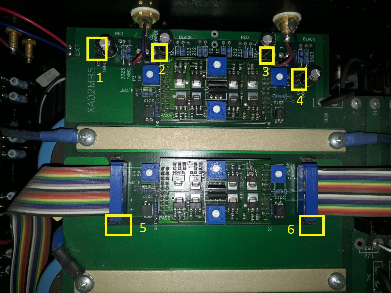

there is no c5, c6. (capacitor)
maybe you mean header 5 and 6 ?
if you menth, header 5 and 6,
those are the measuring points for the IQ. (IQL1 and IQR1)
measuring not referenced to ground but between the 2 pins (1 header)

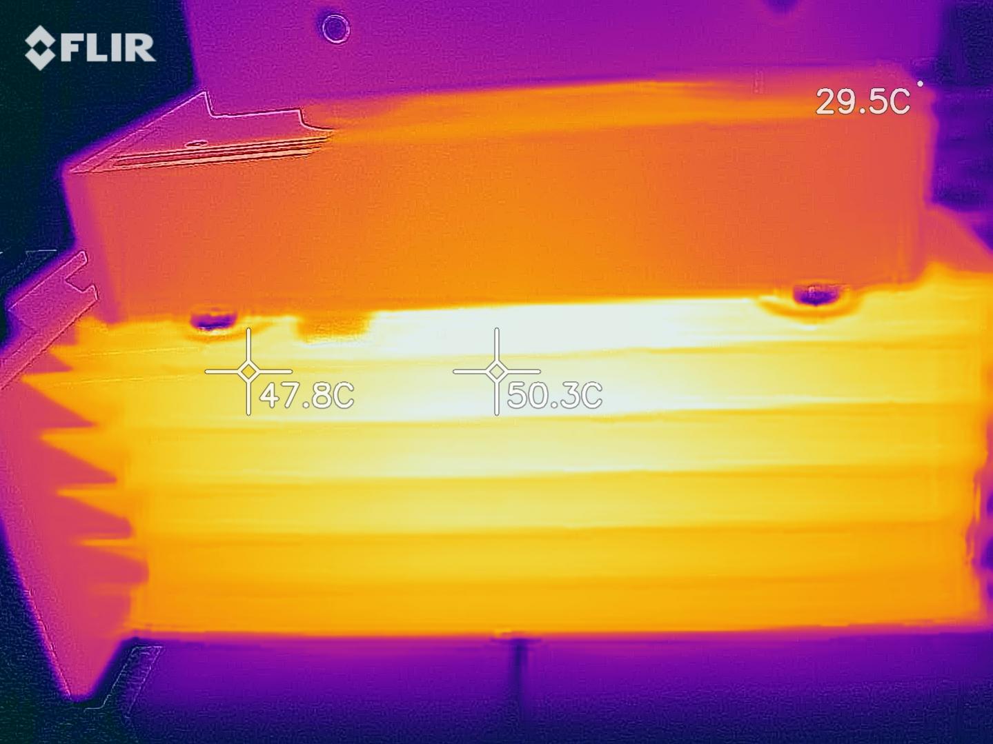

now, after 3,5 hours, playing very low volume, the temperature is risen to:
left 51.2 and right 50.3 degrees c. (ambient = 22)

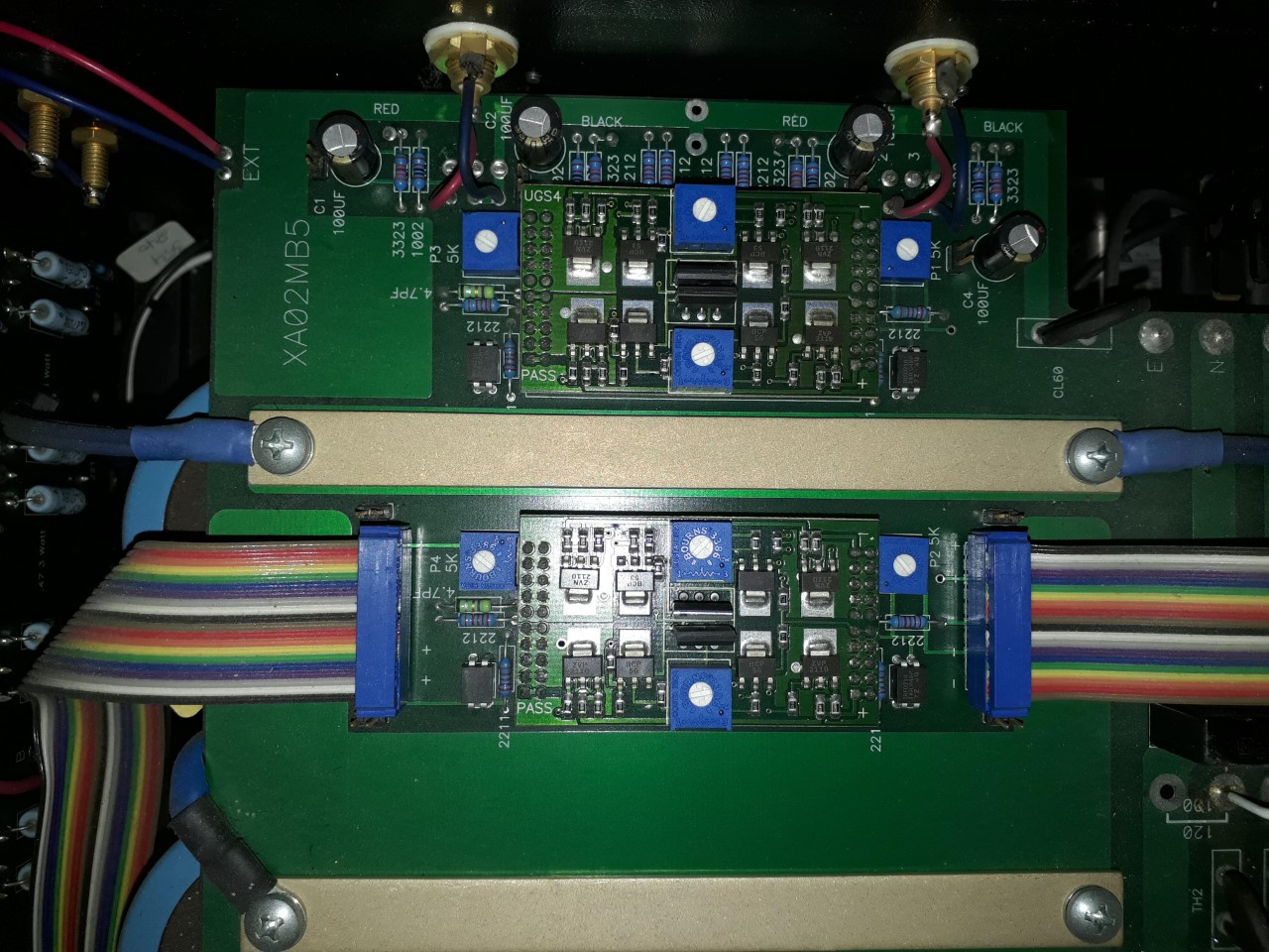

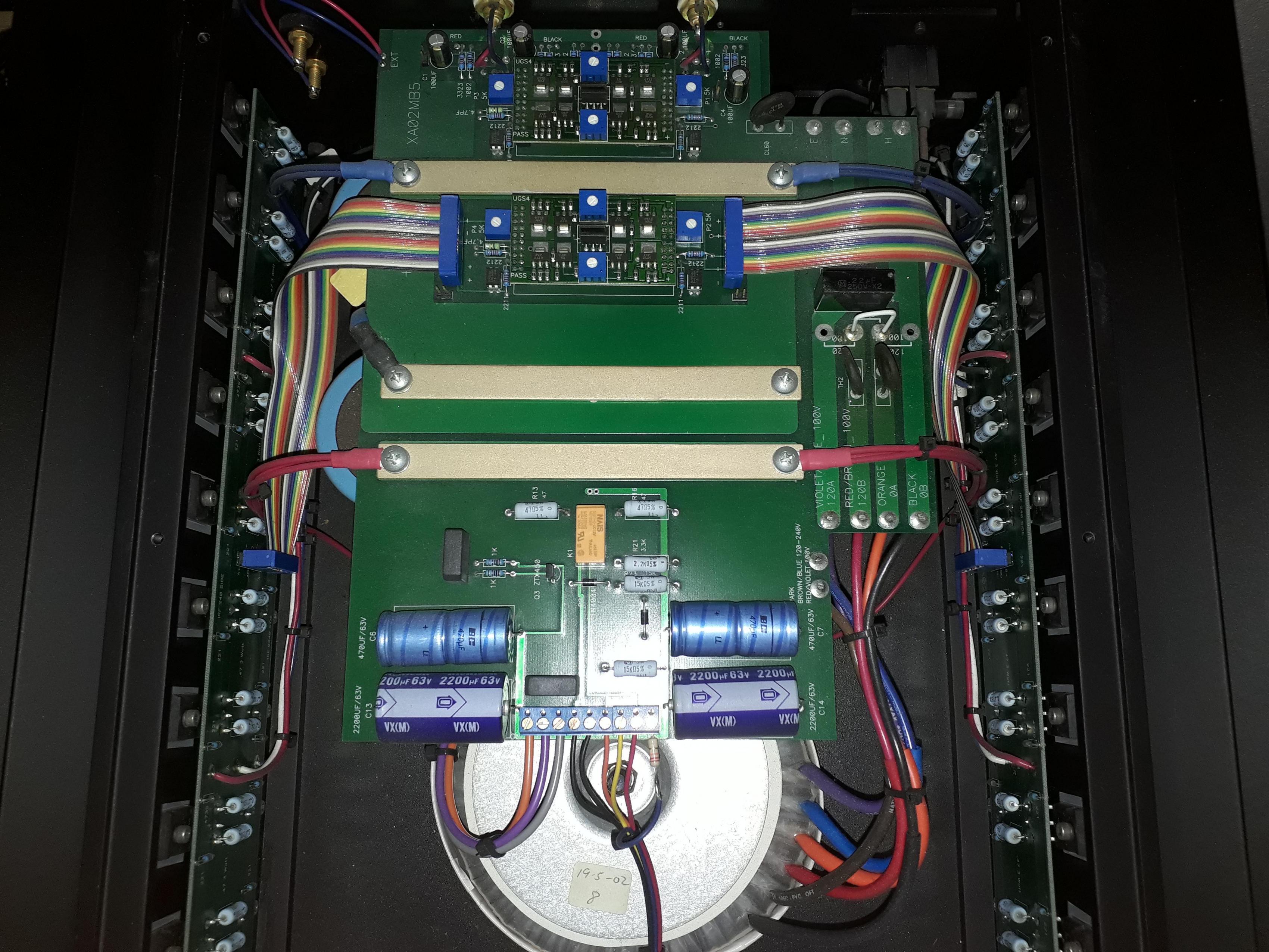

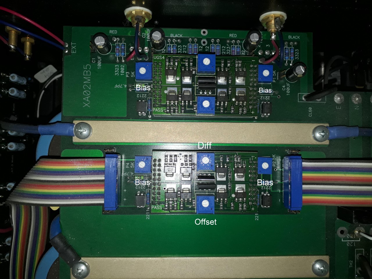

gimme full picture showing main board and I'll show which caps are C6 and C7 (there are four big horizontal electrolytics on pcb , near connection block)
if there is symmetrical voltage at them ( and it will hardly be anything other) , you'll need new UGS modules , as Wayne sez
ah, that one, not noticed, sry, here it is.

The inputs are cap coupled so it shouldn’t really matter much for the measurements. They can be made with the inputs open. If the amp works and the sides are about the same temperature but the DC is off you may need new gain modules if they can’t be set to zero.

about the question of the dc voltage on the C6 and C7, those are both 43.5 Vdc.
the C13 and C14 are both 46Vdc.

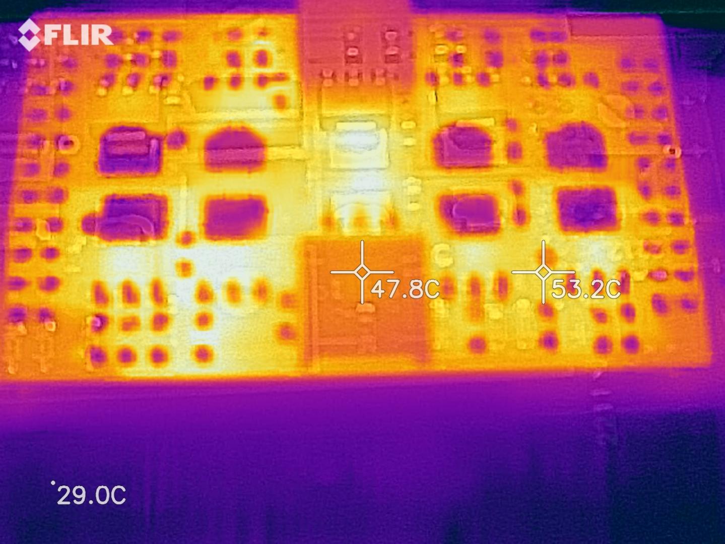

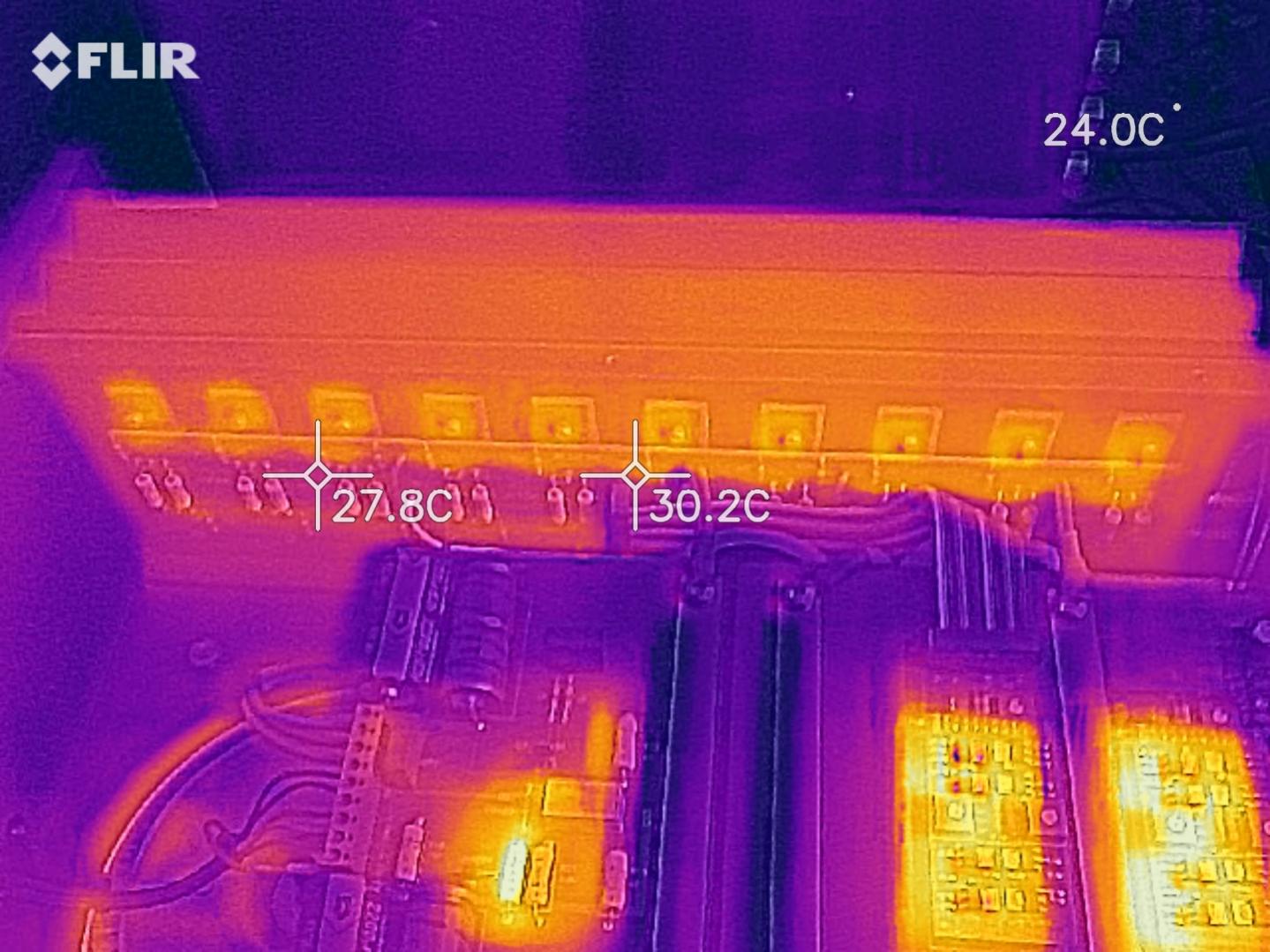

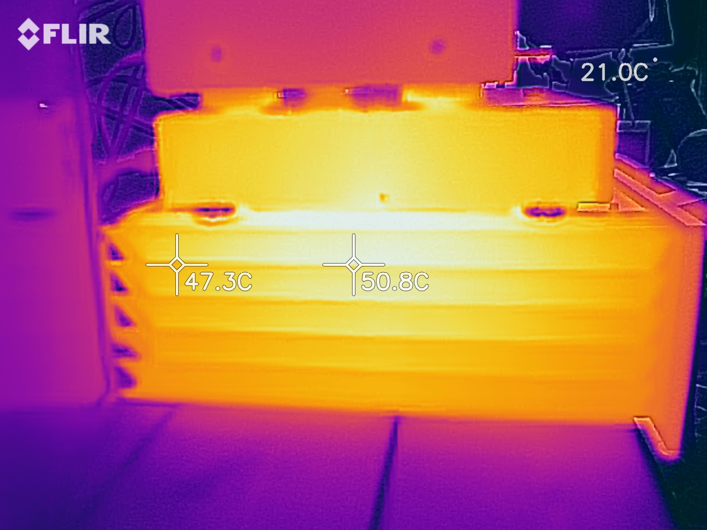

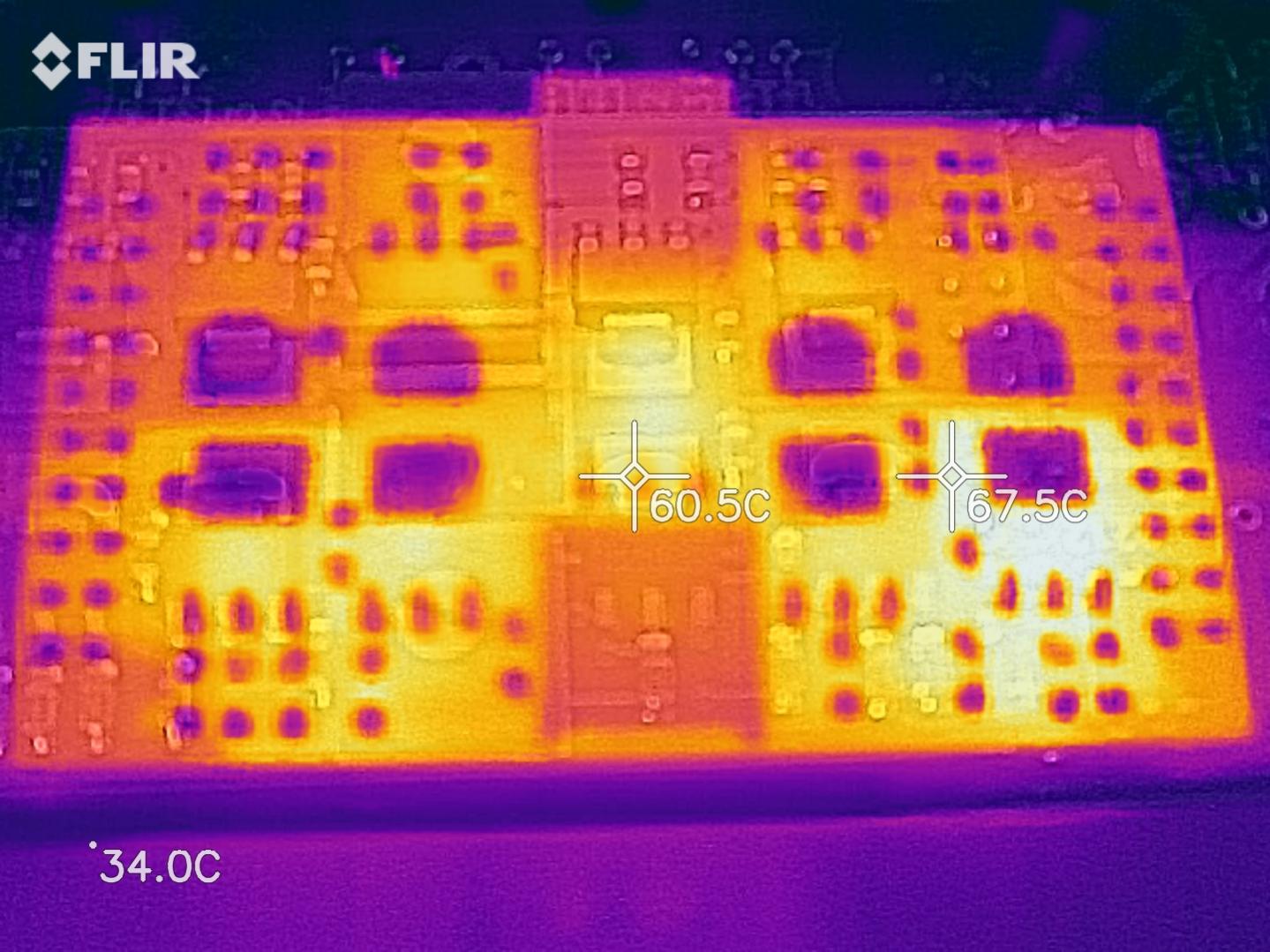

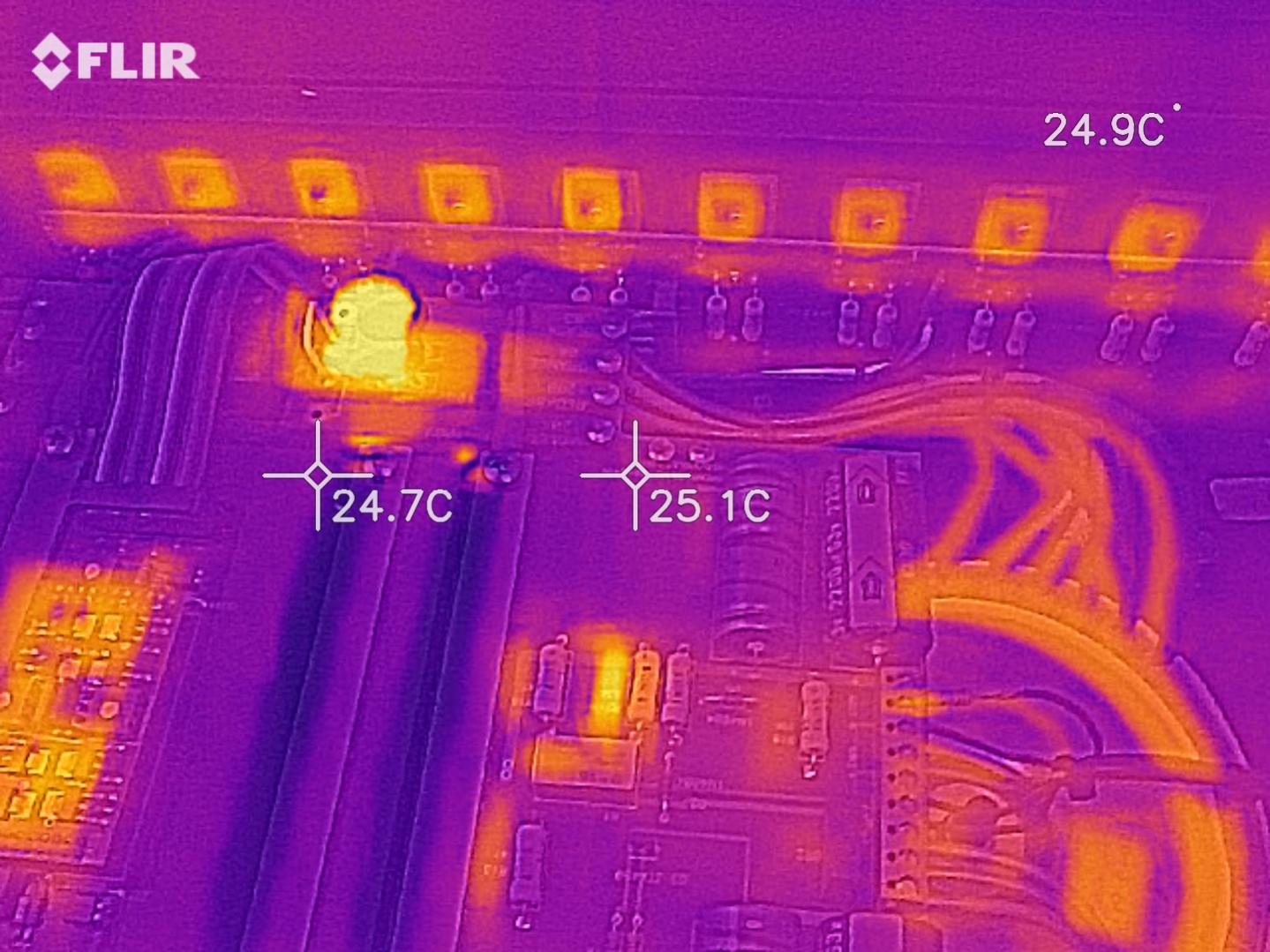

made some pictures... 🙂
all heat sink fets seams okay to me. even the resistors seames okay.
it is clear that the UGS4 module of the left channel (top pcb) has more heat dissipation on 1 transistor (or the resistors aside).
this is due to the close up pic and 2 cameras (flir) giving somewhat shifted pictures. (outlining of components vs IR view.)
pictures says more...
greetz from Belgium.
