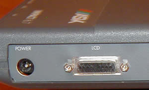

First the good news: You're rite on about the PS Cosmic, it's indeed a two pin adapter, the standard type that goes into most electronics, so with a users mannual or a few specs, my dad should be able to get that licked (he fixes cash registers and point of sale equipment, so knows all about that kind of stuff and asures me once he knows the proper voltage for the output of the adapter, he can sort that out)

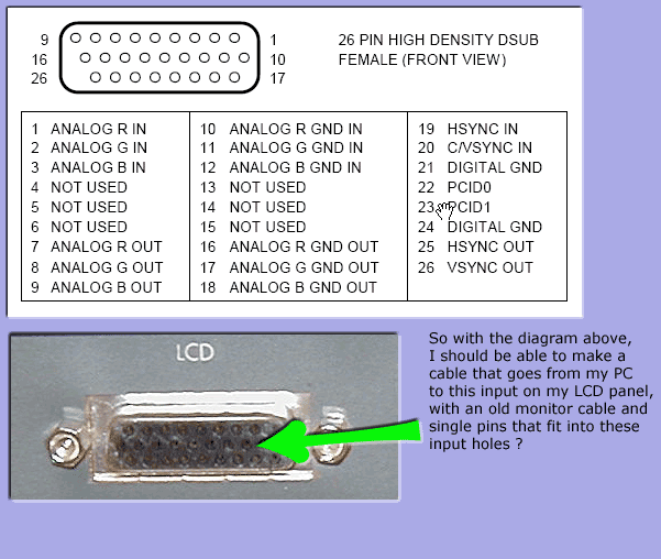

Now for the bad news: (not too bad I hope) Turns out that unlike all the other ASK impact panels, this model does not have a normal RGB analog video input (like a standard monitor) but a special 26 pin (3 rows) input from the PC to the panel.
I planned on just hooking up my old PC (with All-in-wonder tv tuner card) and running the video in and TV through that so i don't really need a video in jack.
Now I just have to track down the proper cable, I think this should be easyer to find than a specific power supply, i am thinking that all the ASK impact panels would use the same cable. Please advise me if this is not the case.
If any one has a spare or know where to get one please let me know.
I am waiting for a response from ASK in norway, and my dad is going to inquire at the ASK dealers in UK.
I am including a pic of the ONLY input plugs on this unit.

Cosmic,
By pinout do you mean this? ( in the attached pic. )
I have just been reading some posts on making custom cables...
From what I understand, I could make my own cable, all I need is this pinout? ( and a spare vga cable, soldering iron, and little pin things, oh and a multi meter )
Am I rite in asuming that?
