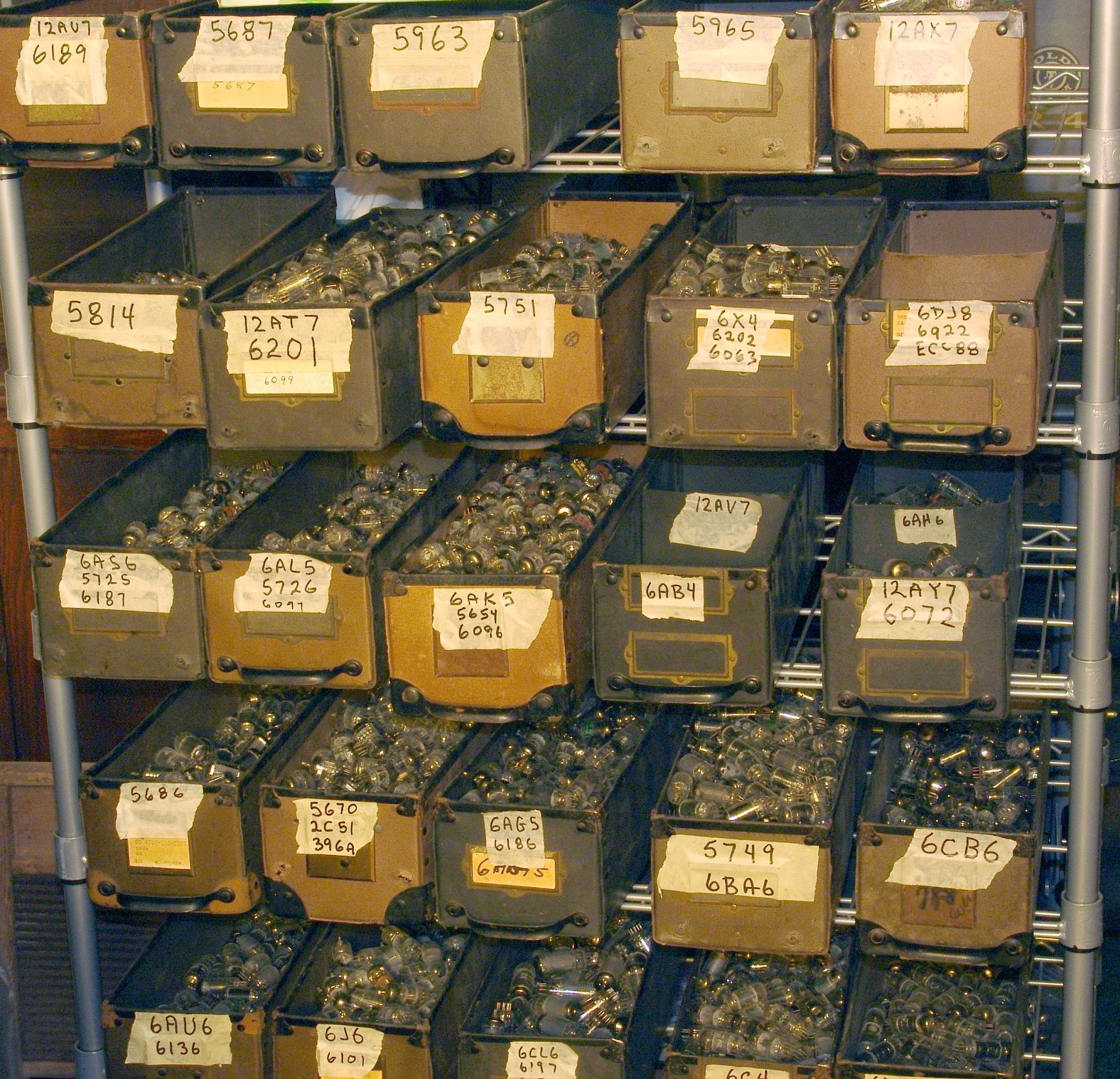

I thought it might be a handy tool to do rote work like tube surveys, where one would not bother the group. For example it would be nice to have it go fetch a list of all the vacuum tubes that are designated in their data sheets as "damper tubes" or all the triodes in a certain mu or transconductance range, or give me a list of all the dual triode compactrons. Well I asked it those kinds of "survey" questions and it failed miserably. Too bad, now that would have been handy.
Over 30 years ago I was given over 100,000 vacuum tubes in exchange for several weekends of work in a facility about 200 miles away from where I lived. They were all loose untested tubes in random boxes, bags and even scattered around on the floor of an abandoned warehouse that was scheduled for demolition. Rats, birds, and vandals had been trashing the place for years, so broken tubes were everywhere. So were soiled or corroded tubes.
I had to rent about 500 square feet of storage space to keep and sort them all. I also needed to figure out which ones I wanted to keep, and which ones had to go immediately to reduce the high storage costs. A picture of one of my sorting racks is included.
There was no AI, just Google or Yahoo, and several paper or PDF tube manuals. I created much of what you are looking for with simple searches, tube manuals, and Excel on a Pentium 1 PC. No AI, just the BDBO's (as I was often called to at Motorola) version of AS.
Finally I asked it if it ever studied all the vacuum tube datasheets in pdf. It said it cant comprehend pdf files, there goes that.
Well somebody should teach the AS machine to read. I'm not inclined to play with AI at the present time, but if you want to feed it some vacuum tube info, try some of this.
Included is some of my work. The spreadsheet is arranged by base and pinout. When designing an amp, or a PC board for an amp, one needs to group all possible tubes that will physically and electrically work in the same socket together. The only tubes that I got more detailed with is the 9 pin miniature triode - pentode combos. I also found some info on Compactron tubes that may be useful here. The GE stuff came from press releases, so it should be reliable. The "Compactron Survey" was found on the web about 10 years ago and has not been verified by me. The forum does not support upload of a .xls file, so I saved it as an .xlsm file.
Unfortunately, there has been so much "slightly wrong" info about vacuum tubes published, often by the manufacturers themselves that real world testing is needed on the tubes that you actually have. Some examples:
My TSE-II 300B amp uses the WE417A / 5842 for its driver tube. These are often considered to be the same tube, but they are not. The 5842 has a published Mu of 50 while the WE417A data sheet says Mu is 43. I bought a big batch of 6KT6 tubes from a major tube supplier. In a lot of 500 "identical" tubes all bulk packed there are 5 different types of internal construction. All are in the same 100 unit bulk packs with oriental characters on it, but some of the tubes are labeled GT BRITAIN, some are labeled USA, some are not labeled at all. Sylvania ECG and Philips were guilty of stuffing the glass with whatever they could to fulfil a contract as vacuum tube manufacturing wound down. The "internet foklore" about some 6B4GA's ( a DHT) stuffed with 6AV5 ( A TV sweep pentode) is true, I found one in the warehouse but it was dead. There were also some 6BG6GA's stuffed with 7027A guts too. They are still available. AI would choke trying to sort all this out.
