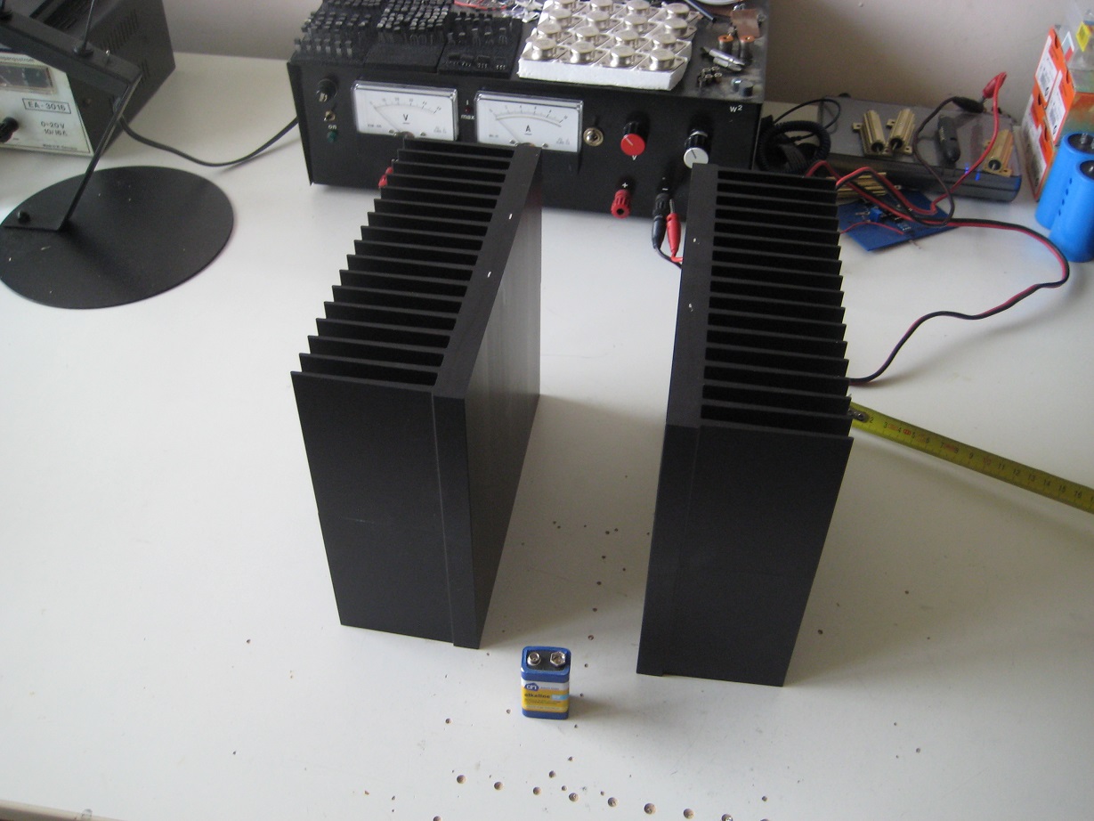

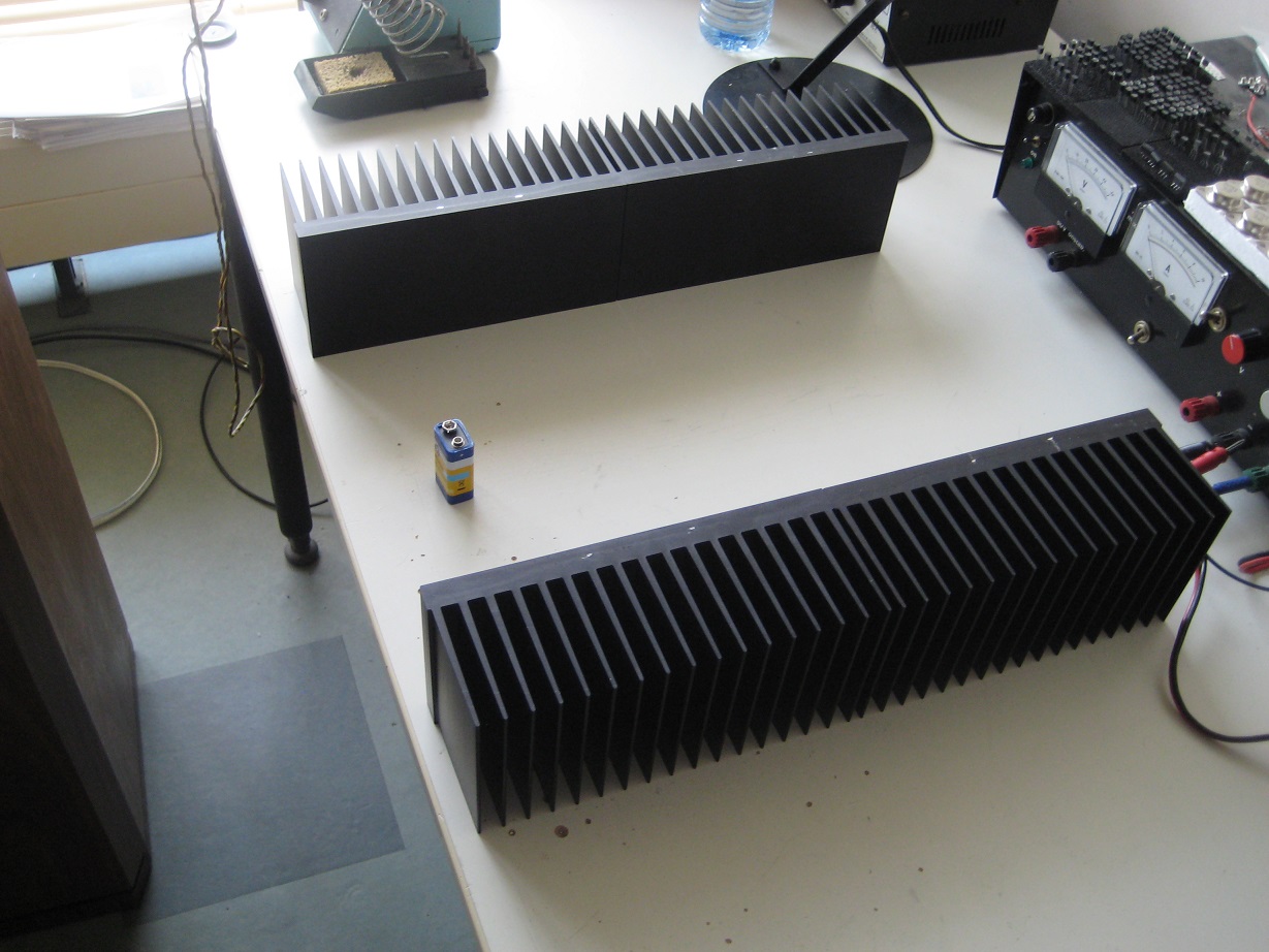

VFET Amp heatsinks arrived yesterday 🙂
I have some questions, I have two options for placing the 4 sinks, see pictures.
First picture is to make a nice cube like Amp without the PSU transformers, they will be in a separate enclosure. So no influence with the Jensens.
Second picture is the conventional 19 inch setup, PSU transformers in front and the Jensen at the backplate connected to the inputs.
But where do I best cut the PSU if I do the cube? Should I just put the transformers in the separate enclosure, and feed the cube with AC?
Or do I put the rectifiers and the CRC also in it, and feed that to the cube?
The voltage regulator MOSFETs will be together with a VFET on one sink each.
Sinks are 0.4K/W each, so they should be just fine to hold the 36 Watt of the VFET and the approx.. 15 Watt of the MOSFET.
Thanks!
