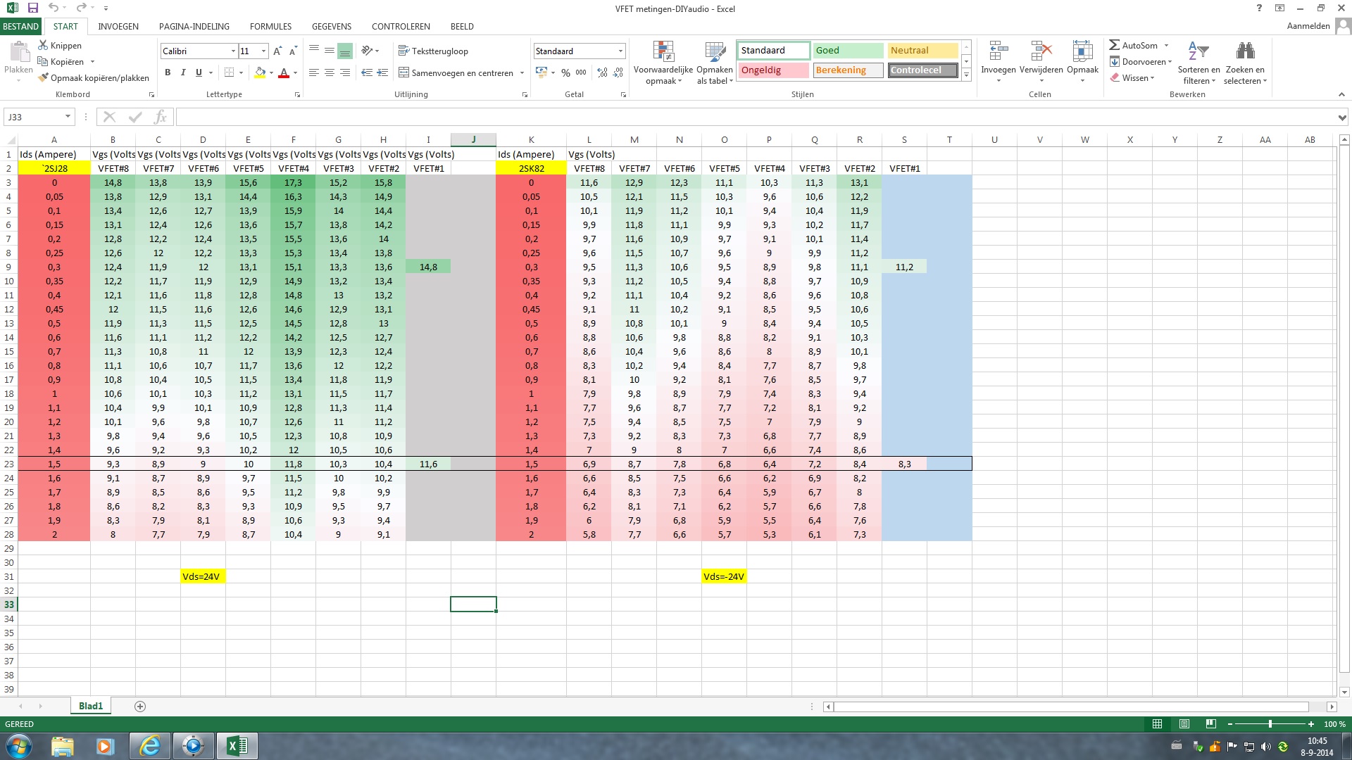

I have 8 pairs but none is getting that low, they range from 8,9 - 11.8 Vgs @ 1.5 A.
I promised to publish the measurements of my VFETs. See attachment. If somebody wants to swap, so we have both better matches, let me know 😀
