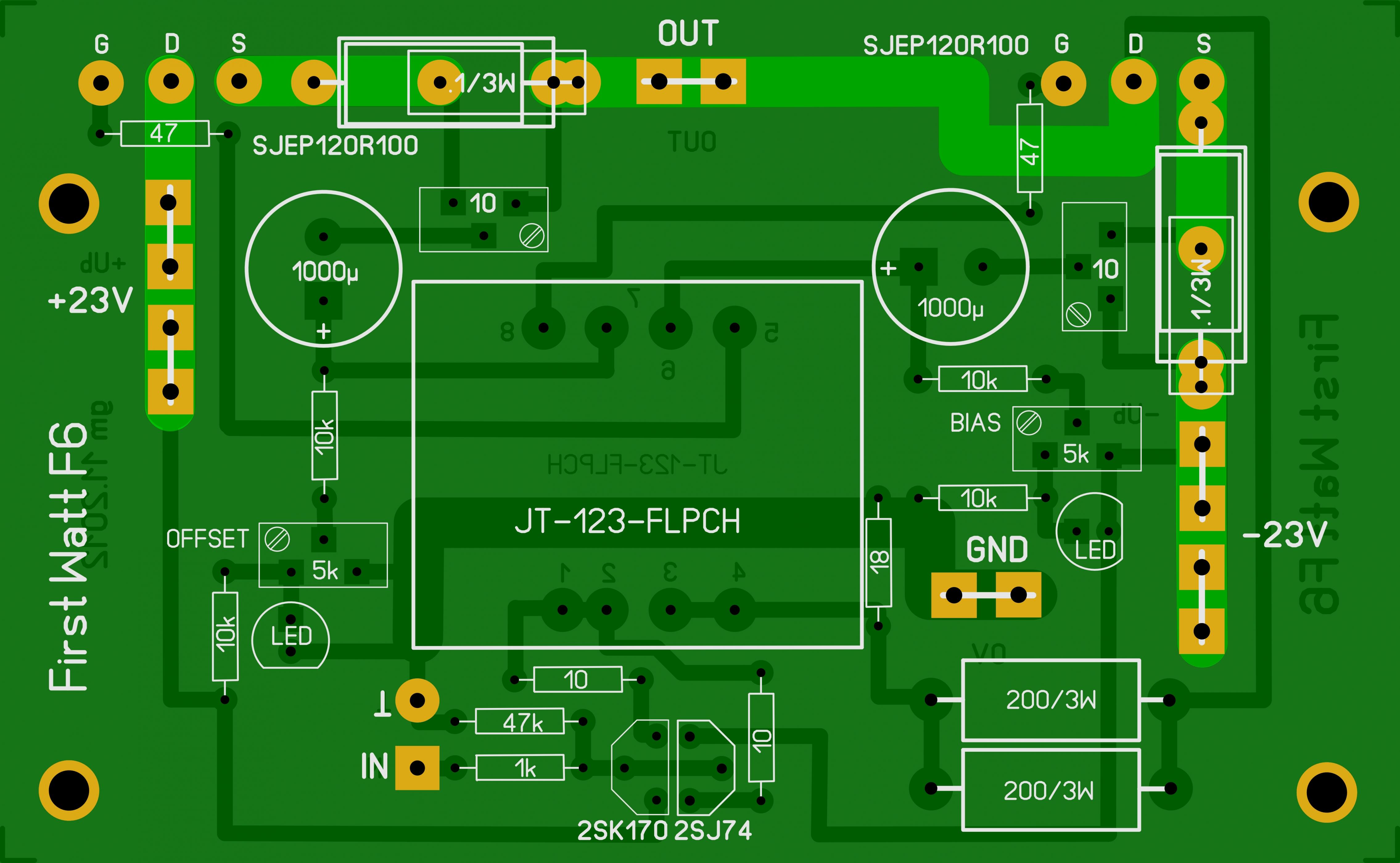

Anybody up for designing PCB for the amp? I know that there are 4 parts, but maybe we can arrange the regulators on the same board and also make an optional buffer section?

I'll draw a PCB including an input buffer and onboard regulators (and the SITs and the MOSFETs on an L-profile to attach the whole thing directly to the heatsink, of course).
It may take a little while though, as I am a bit busy at the moment.

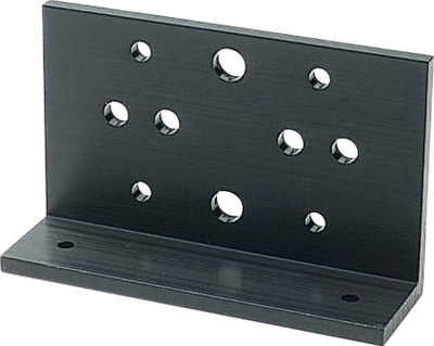

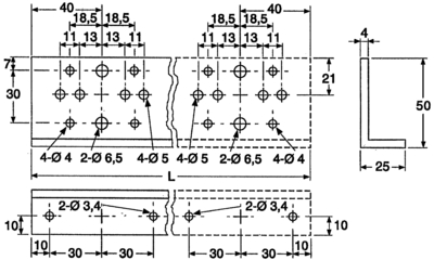

I found these from Austerlitz Electronic GmbH pre-drilled for two TO-3 cans. It is 80 mm long. I also found one plain at 180 mm length. Then you have to do the drilling, but you will get real estate also for the IRF240 and his p-channel brother.
I did not search far and wide, so other L-shapes surely are to be found.

I'll take equal-sided L-shapes 40mm*40mm*5mm thick and 300mm wide at least to ensure a consistant heat dispersion. You'll have to drill them yourselves yet.

Well then, if a PCB is being done, I would recommend using the pinned version then. integrate it on board. Plus someone could gut there F6 to finish this.

Unfortunately, I have the wired version of the transformers, the less elegant solution... . The PCB will fit both. Have a look at my F6 board.
Indeed! 🙂 Here what we can use instead of a L-shape here in US Order Aluminum 6061 Angle in Small Quantities at OnlineMetals.com

Seems to me The Jensen is the better choice of these two. There might be others though. I propose the PCB be preparered for the Jensen.
Thanks! I would do that, but my PC died and I have no soft for mac for this purpose... :-(
