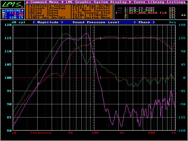

A DCR is basically a bass reflex. In the measurements below, the Red plot is nearfield. The Green is the port tuning of the main chamber. The Violet is what separates a DCR different from a BR. This response is taken from the port of the second chamber. Notice it is a bandpass. Port responses normalized to nearfield.

Just what kelticwizard, I, Weems, and the guy authoring this site...A DCR is basically a bass reflex.
The Subwoofer DIY Page - Dual-chamber ported systems
has alluded to or clearly said.

A classic Weems DCR doesn't have a huge effect on cone movement at the upper resonance. To me, the main advantage is that you can build a long/tall enclosure without the enclosure length resonance intruding into the passband.
I'm not interested in a BP design so I'm struggling w/ how this "helps."
FWIW, all speaker cab alignments technically are BP since they only operate between the speaker's resonant frequency [Fb, Fc, etc.] and petering out to the driver's upper mass corner [~2*Fs/Qts].
Anyway, MC was just showing you that the second chamber is a 4th order BP that 'fills in' the gap between the driver's output and its vent output where it controls the cone's motion a bit more than a reflex, so if you don't want this 'BP', then you don't want to use a double bass reflex alignment.
GM

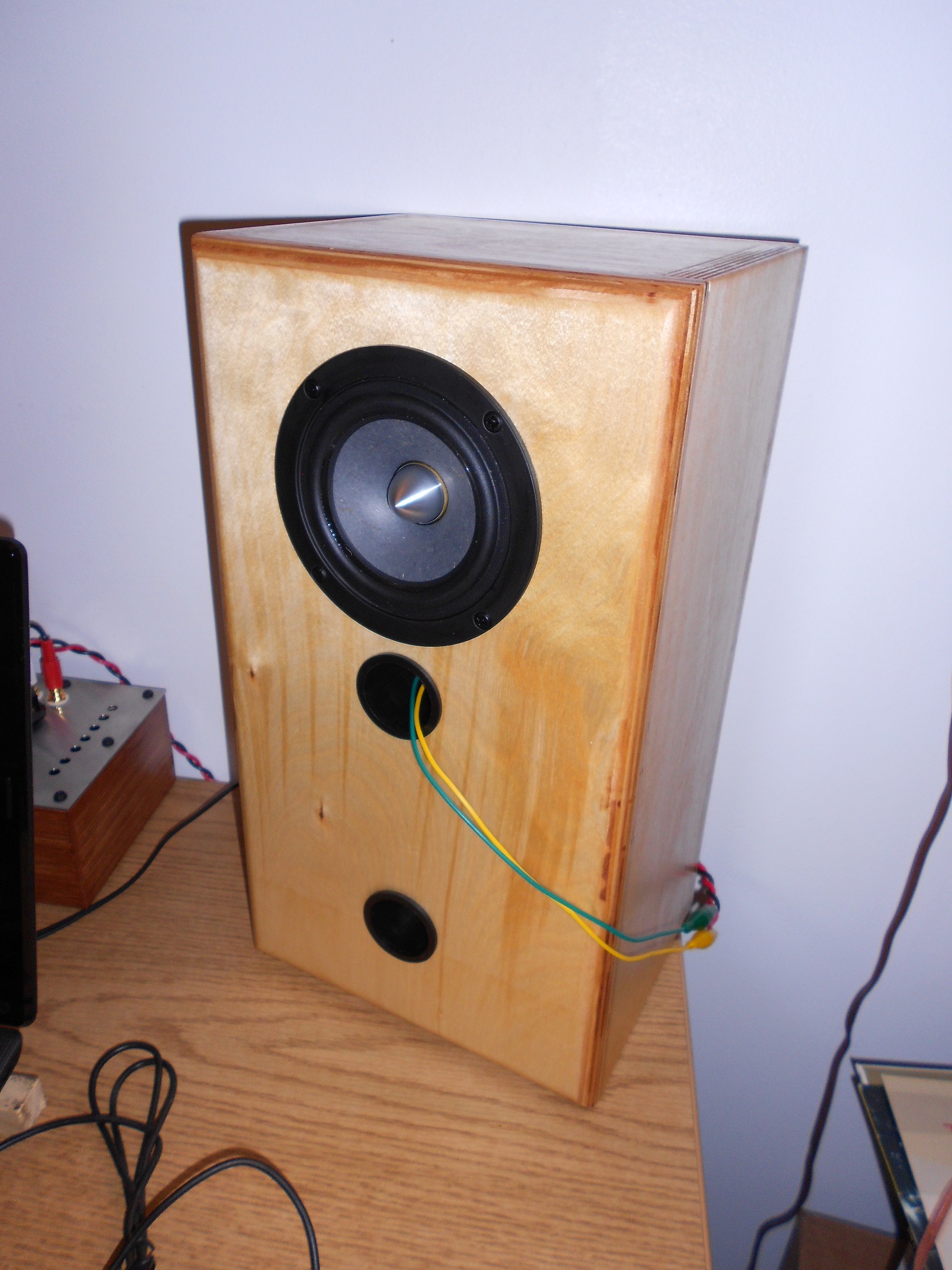

The Micka.de simulator is pretty accurate for these. I based a DCR for a 4" TB fullrange on the results.
(no correction for port dimension)
