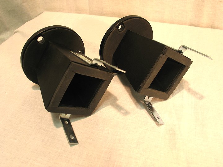

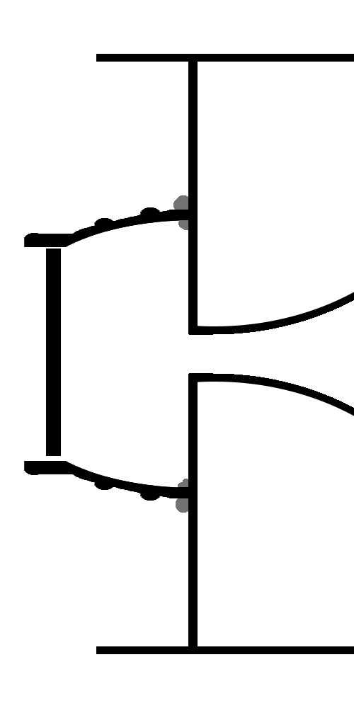

Looking at that picture a bit more, you could make the throat 'plate' whatever you want to call it able to have printed phase plug/adapters swapped out easily enough. Printers that can print that size of a piece, likely in 2 pieces are relatively inexpensive. ie: ~$300-350 USD (~$456 AUD).
I think I would make the throat easily replaceable [...] Make it modular
Do you mean like the joins / modularity used in WE15A ?
This is a very reasonable suggestion. If I don't do it that way, it will be because I'm too lazy to add the extra complexity - not because it is a bad idea.
Sort of like the adapter from a compression driver to a horn, but for a larger paper cone driver. Make the 'adapter' so that you can swap them out, or even just swap out phase plug inserts to test them.

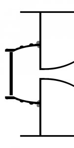

The pictures I attached aren't terribly helpful, Im having a hard time finding a good pic of what I mean.
In the absence of any tips regarding throat & phase plug, I think I'll build the throat in a way that keeps my options open.

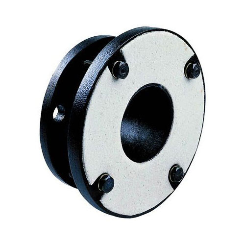

A primer: Phase Plugs
pics: https://www.google.com/search?q=hor...SAhVBfiYKHdf6COMQsAQIJg#imgrc=O2UvRSDeyCv91M:
GM
I like that page. However, it is purely focused on extending bandwidth, and doesn't answer my earlier question:
My rough prototype gives enough bandwidth.
If I don't need to improve bandwidth, is there any point in using a phase plug? That is: would a square(ish) throat + a phase plug be clearer / have better sound quality, or should I just do another slot throat?

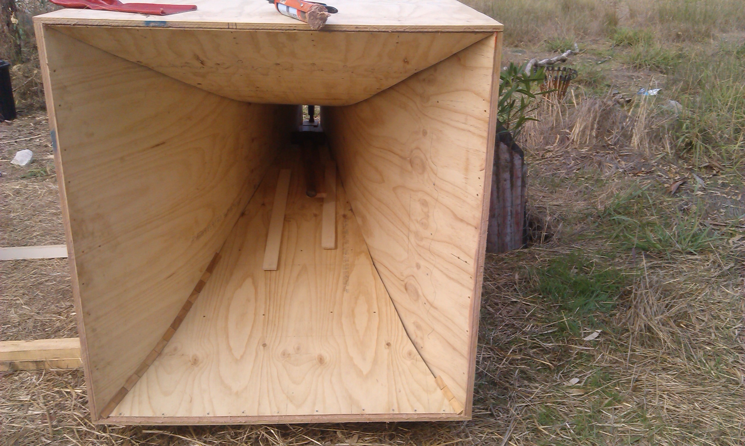

The internal pic shows how I'm forming the majority of the shape - by pressing the slightly bendy 7mm ply up against framing.
The external/mouth pic shows the framing for the last part of the expansion. There's a lot of tension in this part of the curve, so it helps to have a lot of surface area to glue & screw.
The brace that's at the bottom of the picture also helps to hold the mouth square. With hindsight: it would have been good to add these right at the beginning. They would have helped square up the outer shell, and thus made the whole job easier.

Looks like damn fine progress!
You can kerf the inside of that 7mm plywood to get it to bend to the curve easier, set your circular saw to 2-3mm of cut, and cut some vertical 'kerfs' out.
It may not be all that necessary, 7mm is pretty thin. I would think it bends easily enough.
When all else fails, use a bigger hammer. 😀
I'm kerf-phobic. Rather than cut up thick ply (and deal with the constant roar of power tools), I prefer to reinforce thinner ply. That's what I did here. The side curves have a couple of vertical strips of hardwood affixed, to keep the ply stiff and straight in that dimension.

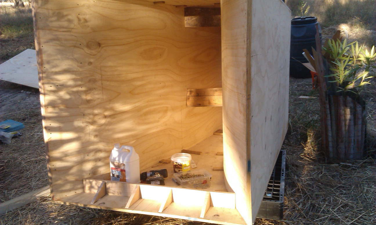

Pictured here is the prototype's rear chamber & throat plate. The prototype required an irritating, multi-part assembly, since the drum's lid was too small to load the 12" through. I've acquired better drums since then (bigger lids), so the horns I'm building now will be simpler and easier to weatherproof - they won't need a mounting plate, so I'll be able to glue the drum sections directly onto the rear of the horn. Attached is a diagram of how that will be set up.
These food drums are excellent components for the purpose: Easy to cut and glue, light, weatherproof. They seal airtight, but give good driver access.

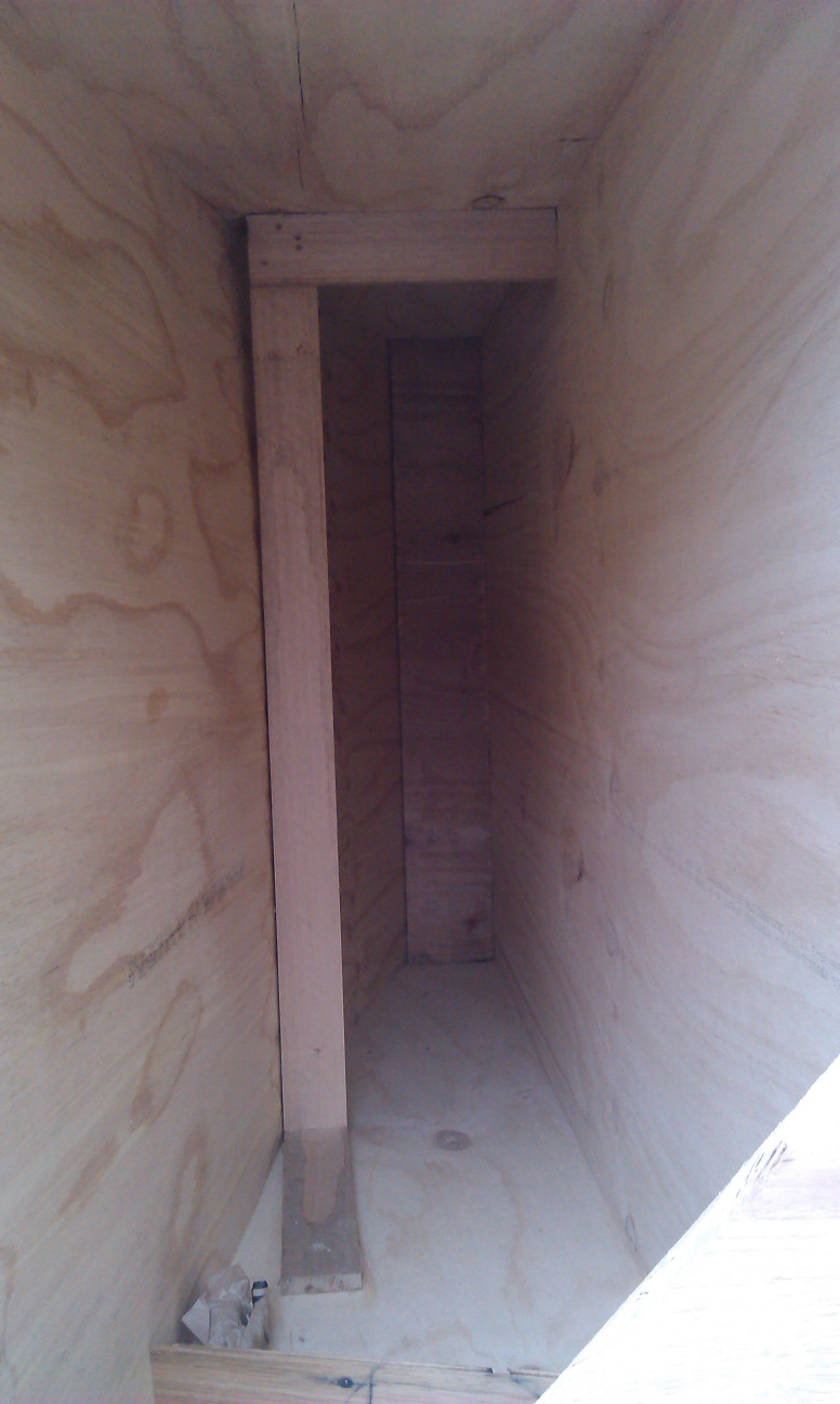

This is my version of kerfing. The reinforcing timber is all salvage / scrap.
Despite my disorganisation & this being an occasional / weekend project, the horn is actually approaching completion.

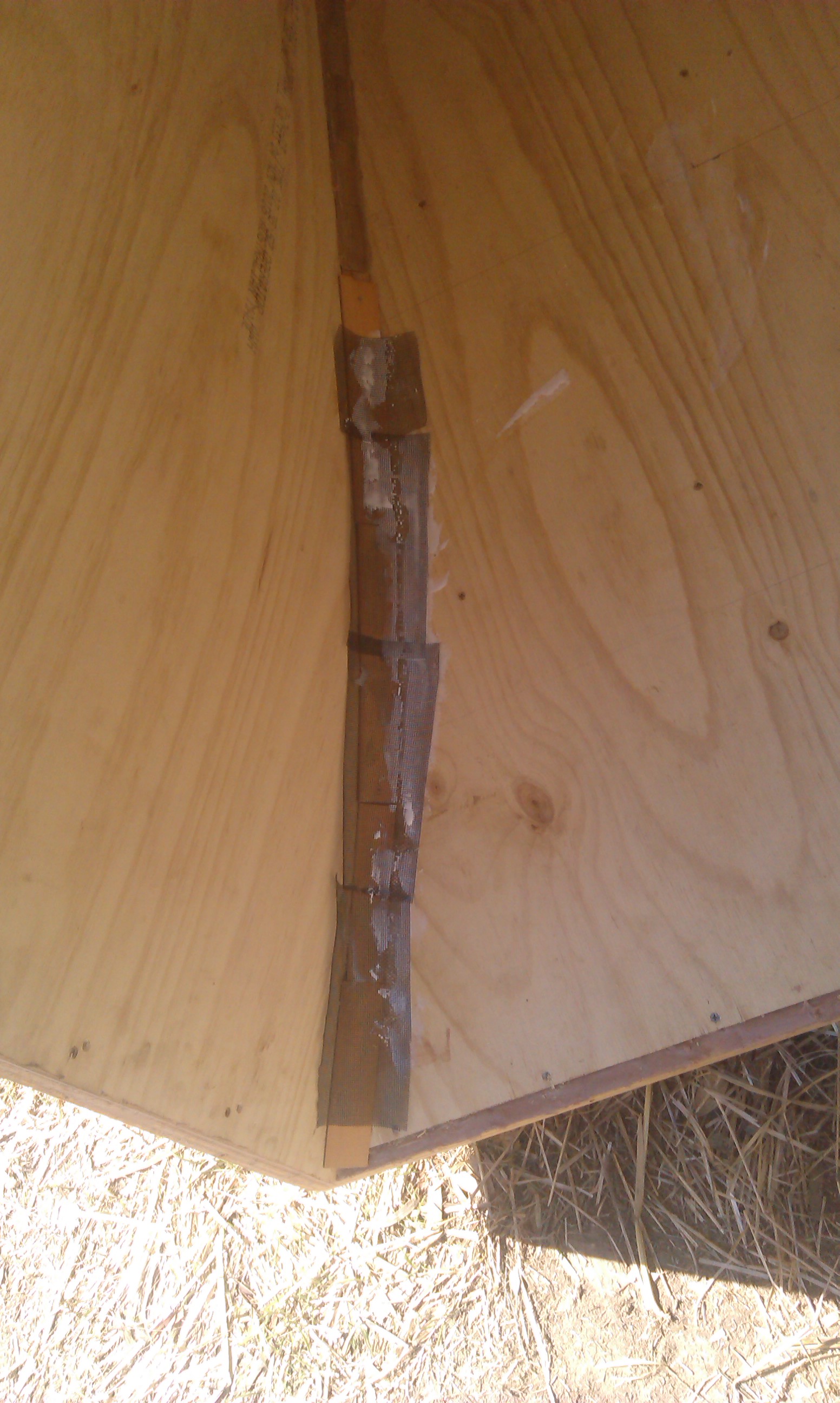

This is the driver plate & rear chamber, with the bottom half of the throat on view. The opening is easily big enough to load the 12" driver through it. It should be reasonably rigid, and airtight, when the lid is screwed on.
The gap on either side is <30cm, I have to be a bit nimble to access the horn interior.
Eventually, I'll add a lot of bracing to this chamber, and experiment with reducing the volume ...but this can wait until I'm sure I'll never have to flip the horn again. In the short term, I'm wary of adding too much extra weight.
The second pic shows how I'm getting the corners strong & airtight: lots of timber+glue, then a layer of mesh over that, which I'll fill in with bulk glue. There's no practical benefit to getting them this smooth - I think I just want them to look pretty once they are painted.

You might be able to use a polyester body filler, 'Bondo' is the common brand here in the USA. It's fairly easy to apply, sands easily, etc.
Bondo stinks as it cures, stinks like stinky stink. Also, if it gets on your skin while curing it can burn a little.
So, essentially I'm recommending a stinky, skin burning product to use. 😀
Cheers. Working outdoors, I'm not too bothered by stink. The price is a bit high, though - Bondo is locally available at $27 for 400g.
Where I need bulk, I'm using a much cheaper construction adhesive - I get packs of 3x320g tubes for just $5.80 ('Parfix' brand). This means I can use a lot.
It is messy and does shrink slightly as it dries, but is strong, not brittle, and not very toxic. When I apply by 'hand', I wear elbow-length gloves.
Similarly, the high cost is why I'm not going to wrap the enclosure in a thick fiberglass shell.

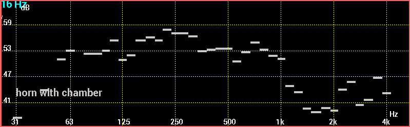

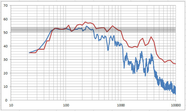

Got it finished enough to fire it up, play some music (which was good), and take some rough measurements.
The chunky image is from my phone - the (Audio Tool app) 6 bar per octave view. This is using the wee Dayton mic.
The more detailed graph is plotted from the AT files:
blue = open rear chamber & minidsp 400Hz lowpass filter (the spike at 4kHz is ambient noise: cicadas).
red = closed rear chamber, no filter.
I haven't yet got it airtight and fully braced. My chamber 'stuffing' was two old shirts. The throat is still a trifle oversized (on purpose, to allow for phase plug shenanigans).
It can only improve from here 🙂

Near perfect 2 octaves
I communicated poorly: these were pink noise tests. So it is more extended but not as smooth as that graph suggests.
In Audio Tool, pink noise displays as flat in the bar graphs, (1/1, 1/3 and 1/6 octave views). For the detailed graph, I should have switched to white noise, or applied a 3dB/octave correction in the spreadsheet.
Here is the info again: pink noise, rear chamber on, with the 1/6 octave & full detail plotted together.
