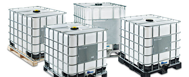

I could make a quick start by turning a couple of IBCs into PPSL* boxes, since they'd be full ninja and easy to weather proof ...and then I'd work on a bigger version.
I can site it in a well screened spot, almost 300m from any road, so anything vaguely low profile should be OK.
*Intermediate Bulk Containers --> Push Pull Slot Loaded

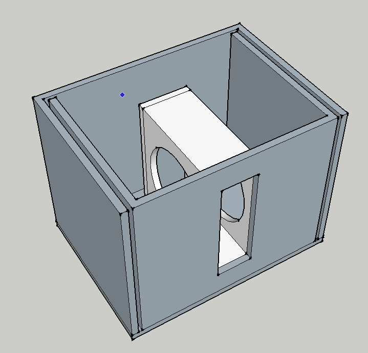

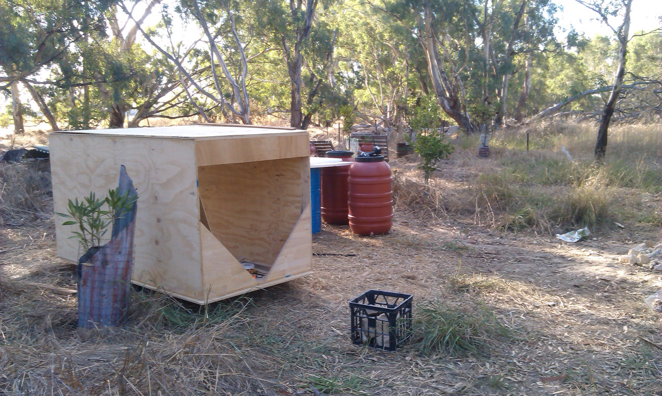

I'm now planning a 'normal' horn system for midbass and above (meaning: fairly big, but not a permanent / fixed structure). The bass can come later... probably much later.

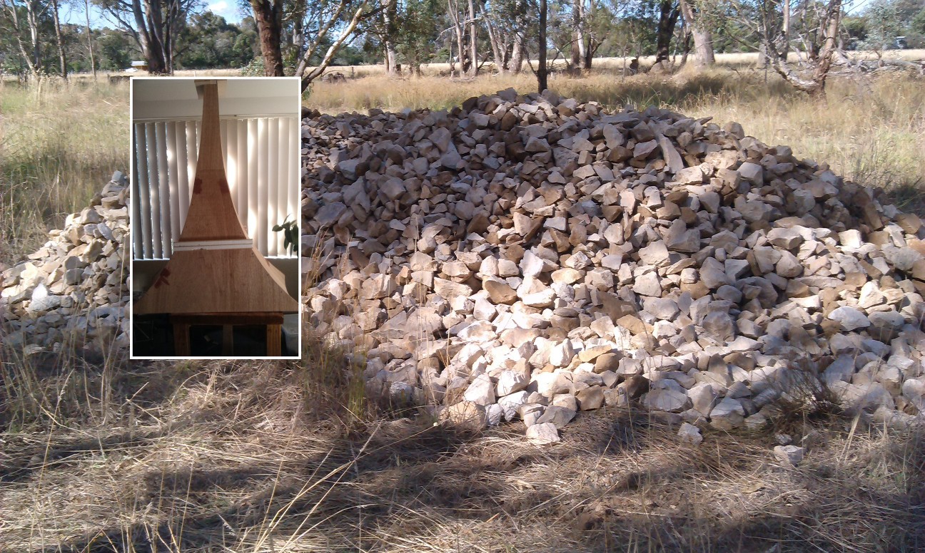

Pictured are my midbass and bass horns, under construction. The bass section obviously has a way to go yet.
The midbass horn is 150cm long. I'm hoping to cover 75Hz-400Hz with this, and >400Hz with compression drivers.

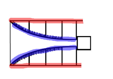

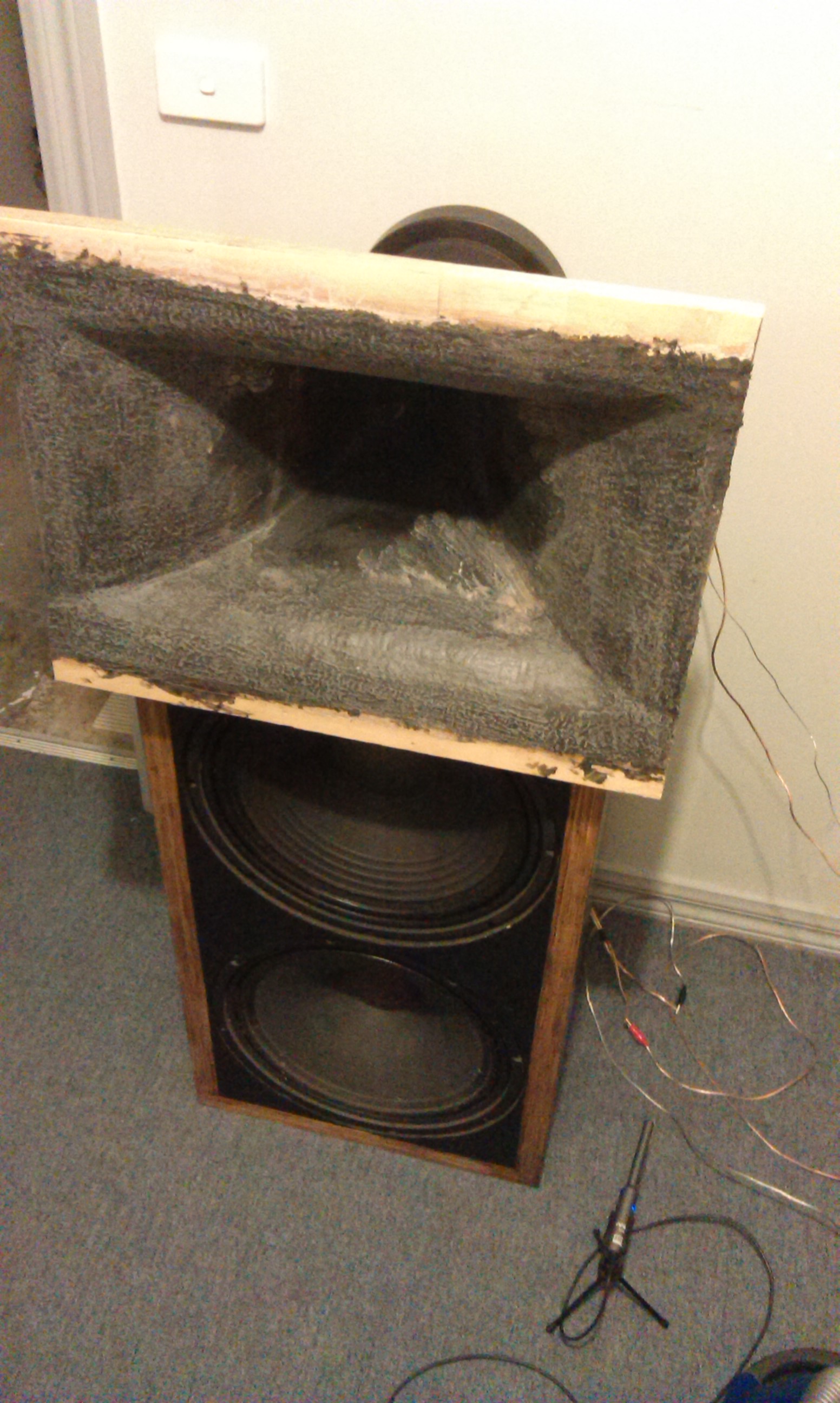

Building midbass horns. I've made up my mind on most things, but still have one question:
My rough prototype gives enough bandwidth.
If I don't need to improve bandwidth, is there any point in using a phase plug? That is: would a square(ish) throat + a phase plug be clearer / have better sound quality, or should I just do another slot throat?
The drivers = Faital 12FH520
Prototype horn was 150cm long, 70x120mouth (it had to fit through a door)
Final horn shall be 230cm long, 120x120mouth (to be built on site)
For the final horn, I decided to make the biggest horn I could, with the least work. The outside will be a simple butt joined ply coffin, using uncut (full sheets) ply.
In the picture, the pink lines are the outer box:
FOUR full sheets of 15mm ply.
The blue lines will be the horn curve:
FOUR full sheets of 7mm ply.
...so the horn shape will use a total of 8 ply sheets, but I'll only have to cut two of them - a triumph for laziness.

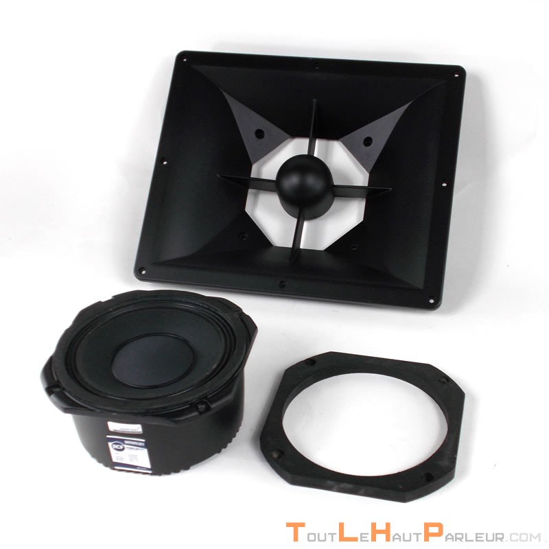

what I'm planning to use >500Hz (JBL 2445 in a modified no-name horn off ebay)

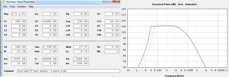

Do you have a copy your horn you can post modeled in Horn Response with that driver?
The big picture shows the values for an open-backed build: 9999 litre rear chamber and 200cm throat.
The SPL plot shows how it should compare to the smaller prototype: exactly the same, with but with 20Hz more extension.
Small picture = how I'll actually build it: 50 litre rear chamber and 150cm throat. Again this is compared to the prototype: exactly the same, with but with 20Hz more extension.
Note that it doesn't seem very sensitive to variation. This seems to become true for any horn that's full-sized, e.g. if I make other changes like doubling the front chamber or model a different expansion type, the plot stays about the same.

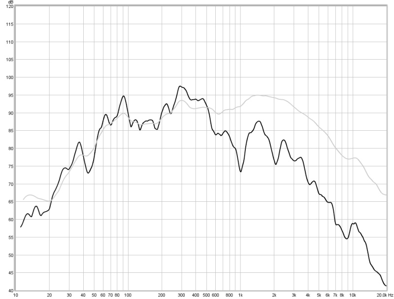

The black line is an in-room measure of the prototype. No eq.
Boundary effects (mostly) make this much rougher than the model, but it is indeed strong 80-500Hz as predicted.
The grey line is with a JBL 2445 (single cap crossover) to show relative levels... the JBL should be 111dB, so the Faital appears to be ~as loud as predicted.
I applied subtractive eq based on this grey line, to get flat output 60Hz - 6kHz. It was good.

how is the horn placed as far as room boundaries. side wall - floor - where are you measuring it from
For the in-room plot:
Mic was about 200cm from the mouth, and about 80cm from the floor.
Horn was about 150 cm from the nearest wall.
I was limited by cable lengths and the small room.
I modeled it as a half-space 80Hz horn. The measured response to 60Hz shows I was getting lots of boundary loading, despite being as far from boundaries as I could be.

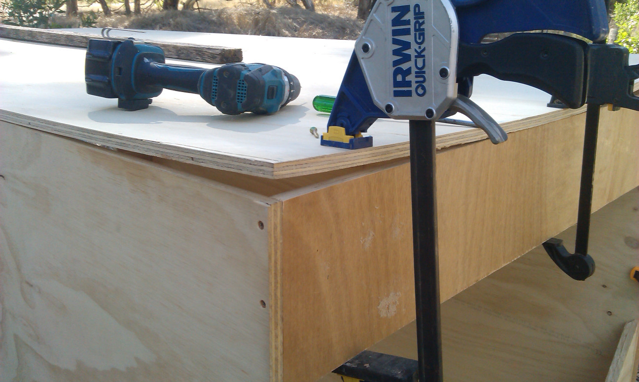

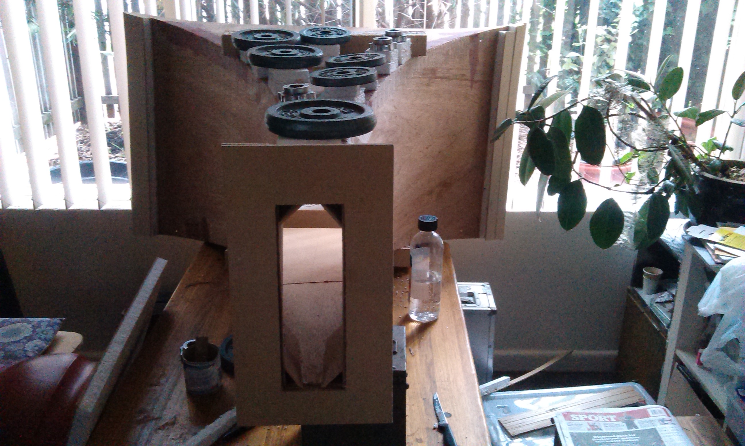

The pix show:
- forcing the ply into shape. It doesn't want to be square, which slowed me down somewhat.
- the outer shell. The V shape is some scrap material I used for bracing. The horn throat will start 10cm in from this.
The sheet on top of the shell is some of the the 7mm ply that I'll be bending and fastening onto supports to form the inner curve.

re: the forcing plywood into correct shape: What I do in these cases is start the screws, or glue and screws, in the middle of the joint and work towards the edge, likely won't have to use as much clamping force to coerce into shape by the time you get to the outer edge.
I'm quite excited to watch this progress, as I've considered some plywood, 'half' horns like the burning man inspiration, for movies out in the back yard.
Keep up the progress!
That's how I did it, but some of the corners were still difficult cos they had no clamp point.re: the forcing plywood into correct shape: What I do in these cases is start the screws, or glue and screws, in the middle of the joint and work towards the edge, likely won't have to use as much clamping force to coerce into shape by the time you get to the outer edge.
My solution was to flip the whole cabinet so I could clamber onto it and stand on the offending corner while I drilled and screwed it into submission.
