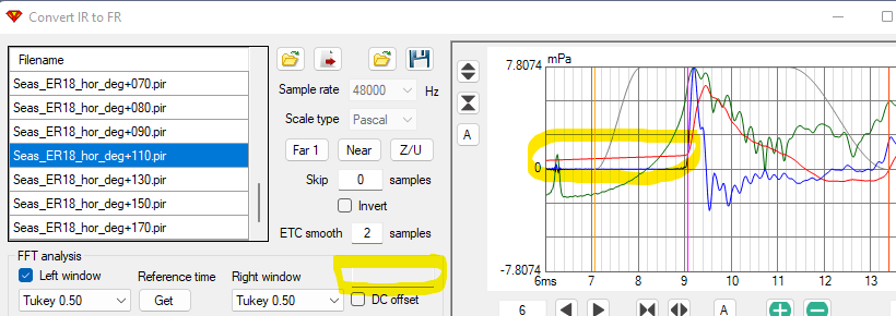

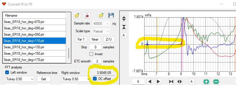

Ivo, thanks for adressing this. I ran into the same issue during loudspeaker measurements, resulting in what appears to be a DC offset in the impulse response in some measurements. I now have the latest ARTA installed, but I also have a lot of measurements done with the older versions so the DC offset is something that I need to deal with. Is there a way to remove it from existing measurements?
Joined 2003
Hi @timpert , for existing measurements I would recommend processing your PIR files through VituixCAD IR to FR tool. It includes DC offset compensation, by taking an average of the first few samples of dead air in the file and shifting the IR by the offset to compensate.
