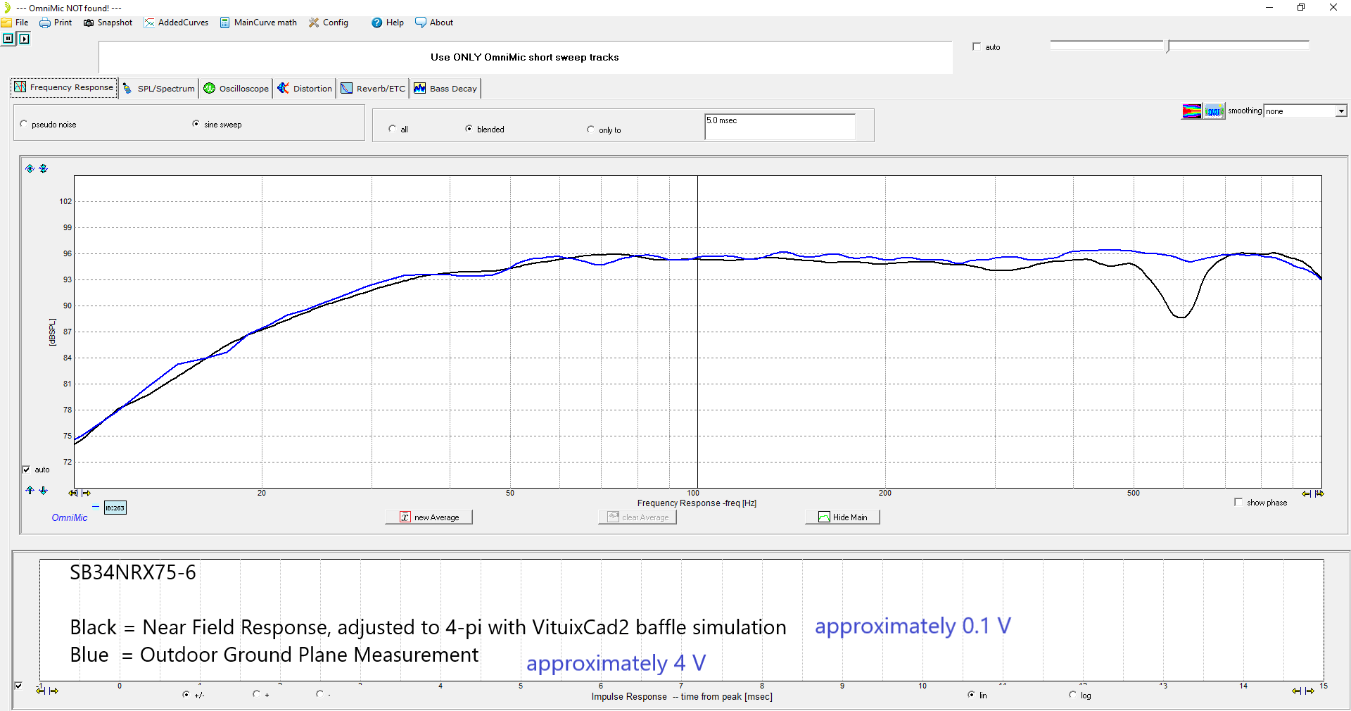

DcibeL - My experience with an SB34NRX75-6 in a sealed box is similar to yours. I did not keep the data, but the response was the same at 0.1 V (nearfield) and at 4 V (outdoor ground plane). Both measurements matched the predicted response to within +/- 1 dB. The prediction was based on measured T/S parameters using DATSv3. The DATS system uses about 0.1 V.
I know that with large signal levels, Fs changes, Qes changes, Vas changes. So therefore I can only assume that the changes somehow counteract each other such that the response stays constant.
It turns out I did keep the data. See below. I am showing the nearfield low-level signal which is adjusted to 4-pi, which very closely matched the predicted response. The VituixCad predicted response is based on the small signal T/S parameters measured by DATSv3. I am also showing the outdoor ground plane measurement which is equivalent to anechoic, and it requires a high signal level. I was quite pleased with how closely the two measurements matched, and I feel any differences are within the measurement tolerance.
Now we should keep in mind that this is a sealed box system, which means it is more tolerant of driver variations than a vented box or PR system.... but still, it is a nice match.
j.
j.

Precisely. You must compare the box model completely to determine if the driver is truly “off spec” rather than focus on any individual parameter. I’ve mentioned enough times, T/S is defined as low level parameters, so if your goal is to determine T/S I would expect the low level result to be the more correct approach even if it’s not what the manufacturer did to create the data sheet.I know that with large signal levels, Fs changes, Qes changes, Vas changes. So therefore I can only assume that the changes somehow counteract each other such that the response stays constant.
There are perfectly good reasons to measure a driver at elevated voltage and compare performance at various amplitudes, but determining the cabinet model isn’t one of them for any driver I’ve tested.

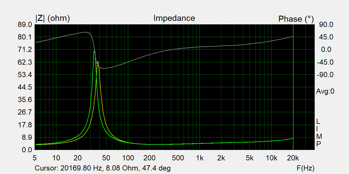

So I managed to get a hold of a couple RND samples from SB Acoustics. They are very similar to SB17NBAC35-4 (4 ohm), but came with test data from SB for the specific driver. So what I have is not just a datasheet for a specific model, but manufacturer test data for this exact driver.
Reviewing the data and running a few sweeps, I was able to reproduce the manufacturer impedance curve with 1V sine sweep. I measured again at 100mV, and observed a change in Fs by 5Hz - 33Hz at 1V, 38Hz at 100mV.
I wanted to obtain a full set of parameters at 1V, but at the elevated excursion, my added mass method wasn't holding, and I didn't want to leave any permanent marks on the cone, so I will place some confidence in the manufacturer data, after all, the data is for this exact driver, not just a generic datasheet.

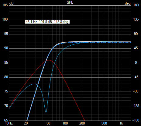

I completed T/S at only 100mV. Comparing to the manufacturer data, Fs was higher, Qts higher, and VAS lower. So what does that mean for our box model ? Measured data is shown as the dashed blue line, factory data is shown as solid blue.

Bluetak for mass? Or closed box method. No thing to mark up the cone on this method.So I managed to get a hold of a couple RND samples from SB Acoustics. They are very similar to SB17NBAC35-4 (4 ohm), but came with test data from SB for the specific driver. So what I have is not just a datasheet for a specific model, but manufacturer test data for this exact driver.

Just Blue tack, I wasn’t going to build a box just for this simple comparison, maybe eventually when I put the drivers to use, but I think I already know what the result of that comparison will be.Bluetak for mass? Or closed box method. No thing to mark up the cone on this method.
The point of the post was simply to illustrate that the voltage divider method of measuring impedance and T/S is “good enough” for the cabinet model, even if the individual T/S parameters aren’t exactly what’s on the manufacturer sheet.
