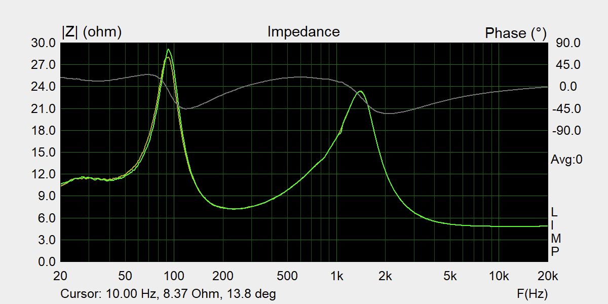

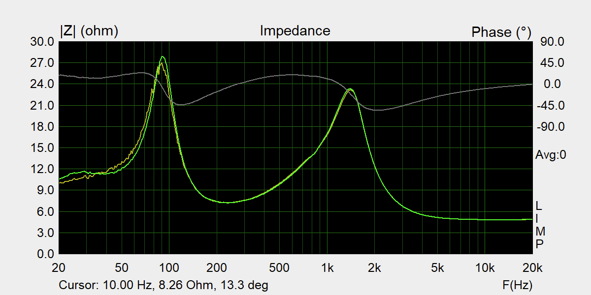

Measured complete T/S using 250mV drive voltage, and again at 1.5V, using voltage divider and 10 ohm resistor.
At elevated voltage, Fs is indeed lower, nearly 5Hz difference, as well Qts is lower, Cms higher, Vas higher, BL slightly lower. End result, cabinet simulation is pretty much exactly the same. Although, the T/S parameters at elevated voltage may look more favourable on a datasheet.
Reason asking: my experience is that damping material alone can easily cause a greater shift in fs.

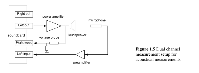

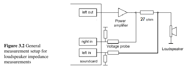

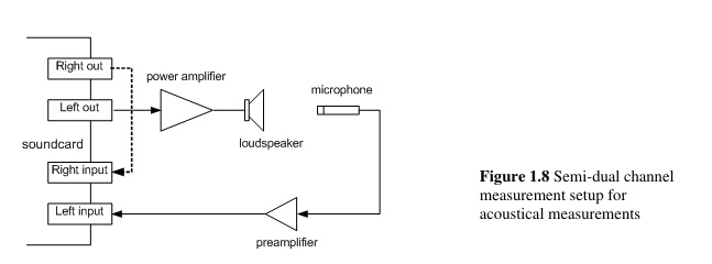

For dual channel frequency response as simple as possible, no special jig is required, just a TRS patch cord to loop back the audio interface output to input for timing reference. This is detailed as "semi-dual" method in the ARTA manual.Thank's for reply,
I have another questions, i have buy a ecm8000 mic and if i want measure a frequency response with m-audio duo, do i need a measuring box? If I want measure a loudspeaker impedance with power amp and LIMP, can i use the input 1 and 2 of m-audio duo and the measuring box? thank's again Maxpou
For impedance, you will require some resistors. All detailed in the manuals. If you build the measurement jig, best to built it for "full dual channel" measurement instead of the semi-dual suggestion above.
For frequency response, like this:
For impedance in LIMP like this:

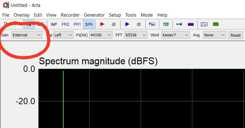

Have you used "external" gen source in arta menu instead of "sine" (see the pic)?Hello,

This afternoon I wanted to measure an old sig generator THD and I got huge amounts of distorsion (too much, like 90%, mistakes were made).
Until now I was using Arta in loopback configurations only, with the generator being Arta.
With this external signal generator Arta was obviously not the source anymore and I figured out that by tuning the internal Arta sine generator (which was turned off) frequency to the exact frequency of the external generator, my measurements were back to normal (almost in the range of the ext gen datasheet).
I am aware that there's a big big notch filter on the fundamental f when it comes to THD measurements but I was hoping that Arta would detect and track the fundamental. My external generator is an old piece of equipment and the output frequency can drift a little bit +-1% which is actually quite stable considering the age of this generator. The Arta filter seems to be a very high Q and highly selective filter (to the hertz and under) so I had to constantly enter new values in the gen box.
My THD+N levels were stable, independantly of the Arta's gen frequ, which is quite strange because when I took a look at the equations in the help file I found out that 'FoundamentalPower' was of course filtered out in both THD and THD+N measurements.
Is there a way to automatically track the fundamental in Arta SPA? A built in feature that I'm not aware of or an alternative way to do this or another Spectrum analyzer that does this?
Thank you, I really like Arta and I'm quite familiar with a bunch of measurements now so I would love to hear that there's a simple box to check and that I'm an Idiot 🙂
Martin
Ooooh that must be it!!! Thank you very much, will test again with these settings.Have you used "external" gen source in arta menu instead of "sine" (see the pic)?

Thank you for replys,
in the figure 1.5, i plug the voltage probe in the input #2 with a TS cord and my xlr mic directly in the input #1? For the figure 3.2 i plug each voltage probe in the input #1 and 2 with a TS cord? Maxpou

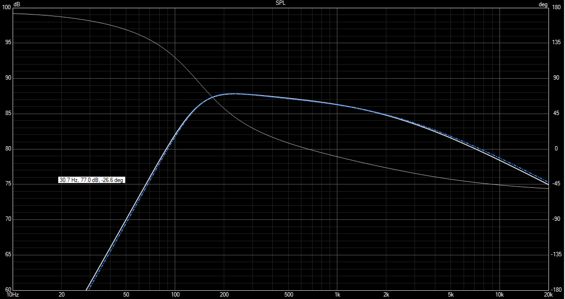

Not to beat a dead horse on the impedance measurement methods. I was recently speaking with someone who was comparing a simulated box model to his real measurements and wondering why they were so different. It turned out that the box model was using the driver datasheet, not real measured T/S for the driver. The comparison below shows quite a difference.

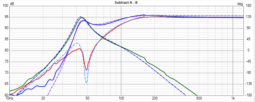

Dashed lines are the simulation, solid is the real measurements.

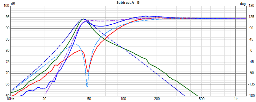

So the next step was obvious - comparison must be made with real measured data for the driver. This was completed using a voltage divider method, and with the "totally useless" DATS. As expected, simulation of the box model with real measured parameters is much closer to reality.
End result - real measured data is always better than manufacturer data, even with simple low voltage divider method used in DATS and the wiring arrangement detailed in the ARTA manual.
That's a very strange statement to make for multiple reasons;End result - real measured data is always better than manufacturer data, even with simple low voltage divider method used in DATS and the wiring arrangement detailed in the ARTA manual.

1. “Better” for match of computer model vs reality, shown above clear as day. Speaker tested above is not junk, it’s a half decent driver from a popular manufacturer.
2. Purpose of low level signal test is to gather T/S parameters which are defined as low level. Shown above, it produces “good enough” data for a cabinet model that matches reality.
3. How do you know ? Suppose you could set up some sort of jig with software to verify…and just because your drivers match manufacturer spec doesn’t mean everyone’s will. Parts vary batch to batch, often suppliers and parts change in production without data sheet updates, manufacturers test speakers using different methods, skew results for more marketable specs, etc. There’s many reasons to throw away the data sheet once you have the driver in your hands. Trust your own data was my point. You don’t have to trust my data, after all you’re not the one listening to my crap speakers.

Please don't make assumptions about the measurement amplitude. Just for you, I grabbed the speaker in front of me and tested it.The measurements you're doing do not represent any models that are useful for practical use/in reality.
Unless you would like to listen to speakers that use less than 0.1-0.5Vrms (ballpark figures).
Depending on the usage, that is very far from "good enough".

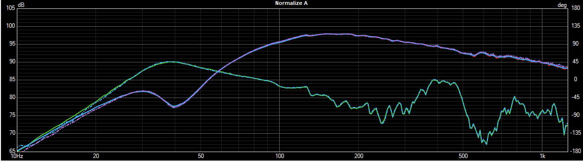

First, I tested at low volume level nearfield like I usually do. I could be 0.1v, don't know don't care, its about "talking volume". Then I checked again at elevated volume. Here I used PN Noise in ARTA, we have a about 2mm of excursion of the woofer, measured 2.25VRMS with my multimeter at the driver terminal. You may think this is still fairly low voltage, however the volume of the noise is what I would call above normal listening level, rather loud in fact. Made sure my mic didn't make contact with the driver, lowered mic preamp gain to avoid clipping. This is much higher than I would normally measure nearfield for cabinet model verification, or for driver impedance & T/S.
Compared measurements as overlays, driver output and port output. Make your own conclusions, I've already made mine.
