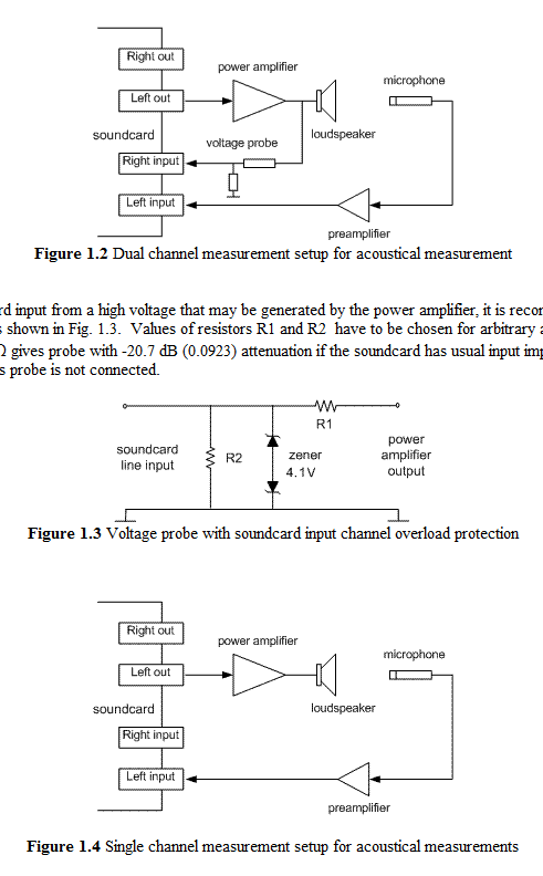

A noob question with Arta and the soundcard, please ?
I want to measure my loudspeakersin room at 1 m axial and at listening position: each louspeaker then both at the same time, what the best please :
- I plug a wire between the left output and the right or left compact disc input of my single ended preamp, then I inject a swept tone from Arta ? I use a single mic with the phantom 48v power of the soundcard.
Or
- I putt in my library an external .wave swept tone I play from my DAC which is certainly quieter than my Pre Tracker E-MU soundcard -though powered by an Ifi low noise dart- . From there easy to measure the L or R channel I want or both at the same time.
In both case how to setup the volume pot of the preamp please ? Have I to measure with the other channel of the soundcard loopbacked Or use the left and right outputt towards the preamp of my Hifi ?
Many thanks, I didn't find a clear answer fo this starting point in the last Arta manual. I assume the problem remains if I want measure a single driver when I will make the probe voltage protection thingy : ho to setup the volume plot for spl curve at acurate db spl scale on the Arta windows ?
Many thanks if any links or inputs for that

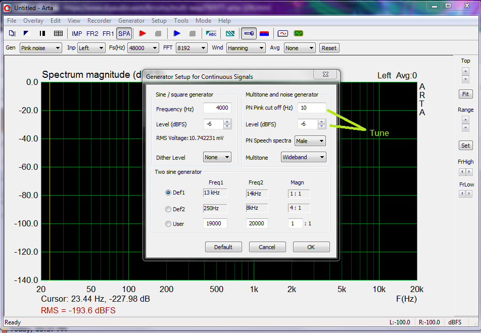

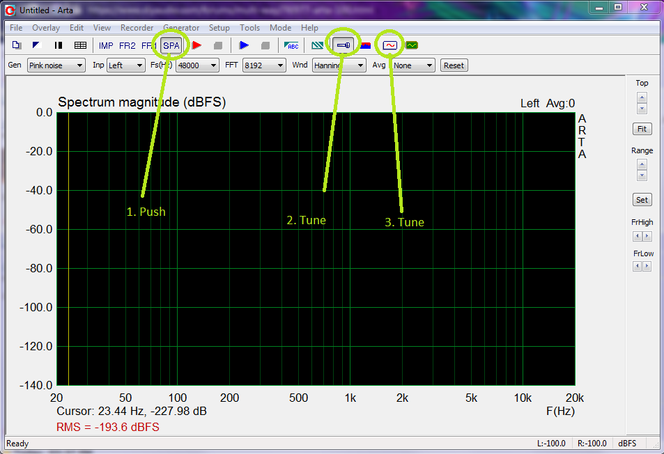

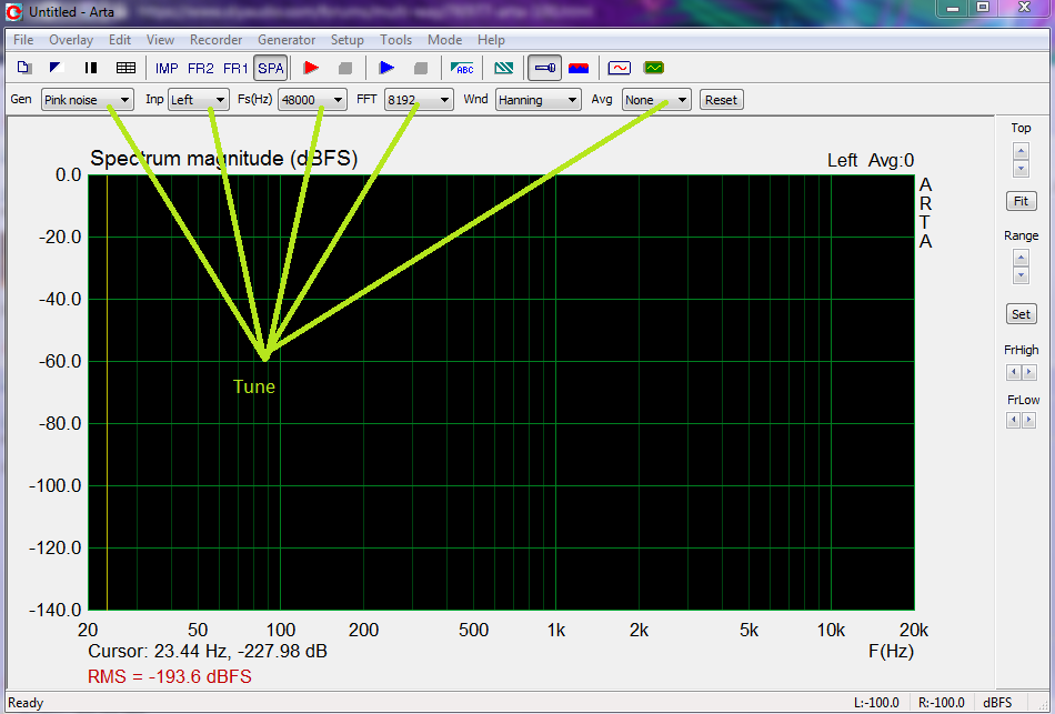

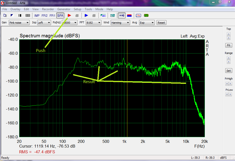

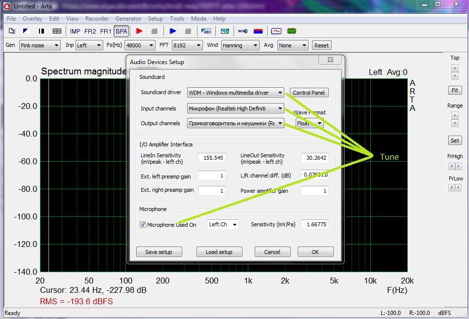

diyiggy, if you need to measure only the frequency response, then pink noise can be reproduced as you like. Software generator or player from a file. Connect the microphone to any input of the sound card. Or do you need something another?
Thank you for your input. Yes , for the begining I only want to measure each cabinet. So the two options are ok, that,s cool.
Is the Arta pink noise a swep tone please?
The 1.4 .
E-MU pretracker with phantom 48v - calibrated mic . Outputt : 6.5 headphone plug to stereo rca cable. just a rca channel pluged on the hifi preamp with its volume pt at 9 hours position.
Wow, many thanks Hensolo for this work. 🙂
I tune it tonight according your inputs and will report.
🙂 : All is working fine injecting a pink-noise with your setups and made some recordings. Thanks again Hensolo. Played a little with the tunings...1/3 octave log smoothing is easier to read for a beginner.

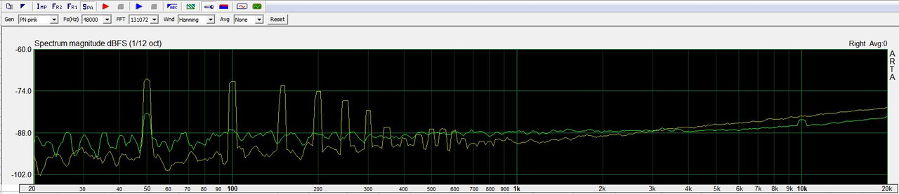

My measurement setup is:
desktop computer with integrated sound card, the computer is not in the same room as my hifi system, so I have a 3m connection cable from the computer to the microphone preamp and a 10m cable for the microphone.
I prepare for another of the usual measures from the listening point and ..
I get this measure.
I forgot to connect the microphone cable to the microphone preamp, so I measured without a microphone.
Intrigued by the upward trend of the frequency response, I also disconnect the microphone preamp and repeat the measurement with overlay, so I am measuring with the 3m cable connected to the computer sound card, yellow without mic and green without mic preamp.
Here now the response curve rises less.
So I reconnect everything and do the first measurement with overlap,
yellow without microphone and green all connected measured from the listening point.
So I was thinking that the microphone preamp doesn't have a linear frequency response.
Should I think that the overall result of the measurement is not what I see, in reality the frequency response has a decreasing trend?
any thoughts?
