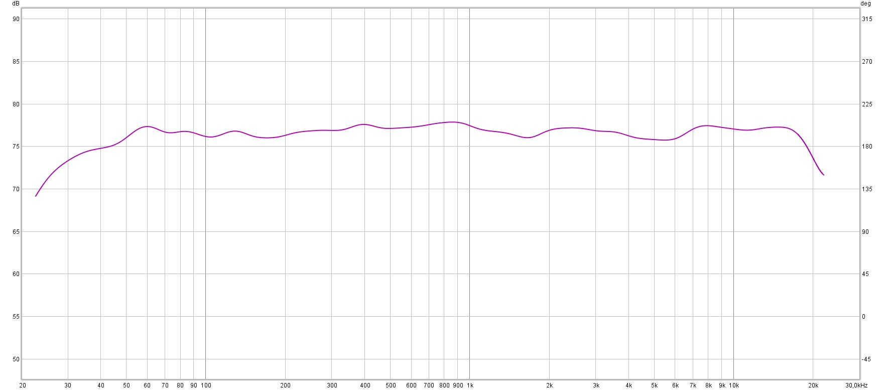

Of Omholt's pic's:
REW looks like 1/3rd to me, while Arta (excepting the calibration file above 3.5 kHz issue), looks like 1/12.
On the other hand, they both look similar to me overall (with the exception of added smoothing).
Both are useful for different reasons, and while I know the display can be changed on Arta, it just looks a LOT better on REW (irrespective of smoothing differences): just a cleaner look to me.
Best of course to look at multiple (different) smoothing graphs (..and I generally like to use 1/48th for driver problems, along with a close-up of impedance and even a CSD plot).

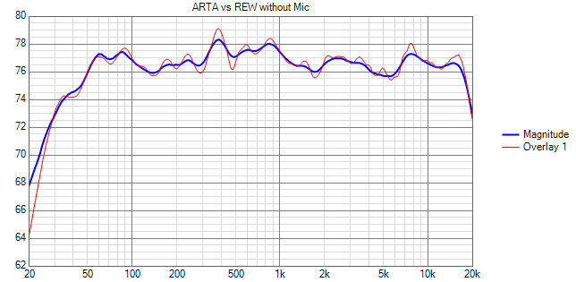

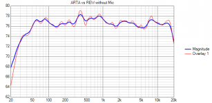

REW vs ARTA without mic compensation:
REW is radically too smooth if we specify that 1/3 oct. smoothing equals average pressure from -1/6 to +1/6 octs. Smoothing of pressure values with linear average leaves quite much small curves - even more than ARTA shows. REW probably uses some other algorithm than linear average. Maybe some curve fitting where octave band is just given name which has nothing in common with linear average within selected band. Smoothing with features of graphics libraries are able to produce same kind of "oversmoothed" curve than REW shows.
But this topic is just subjective without specifying what e.g. 1/3 oct. smoothing really means mathematically; linear average, median filter, curve fitting or whatever.

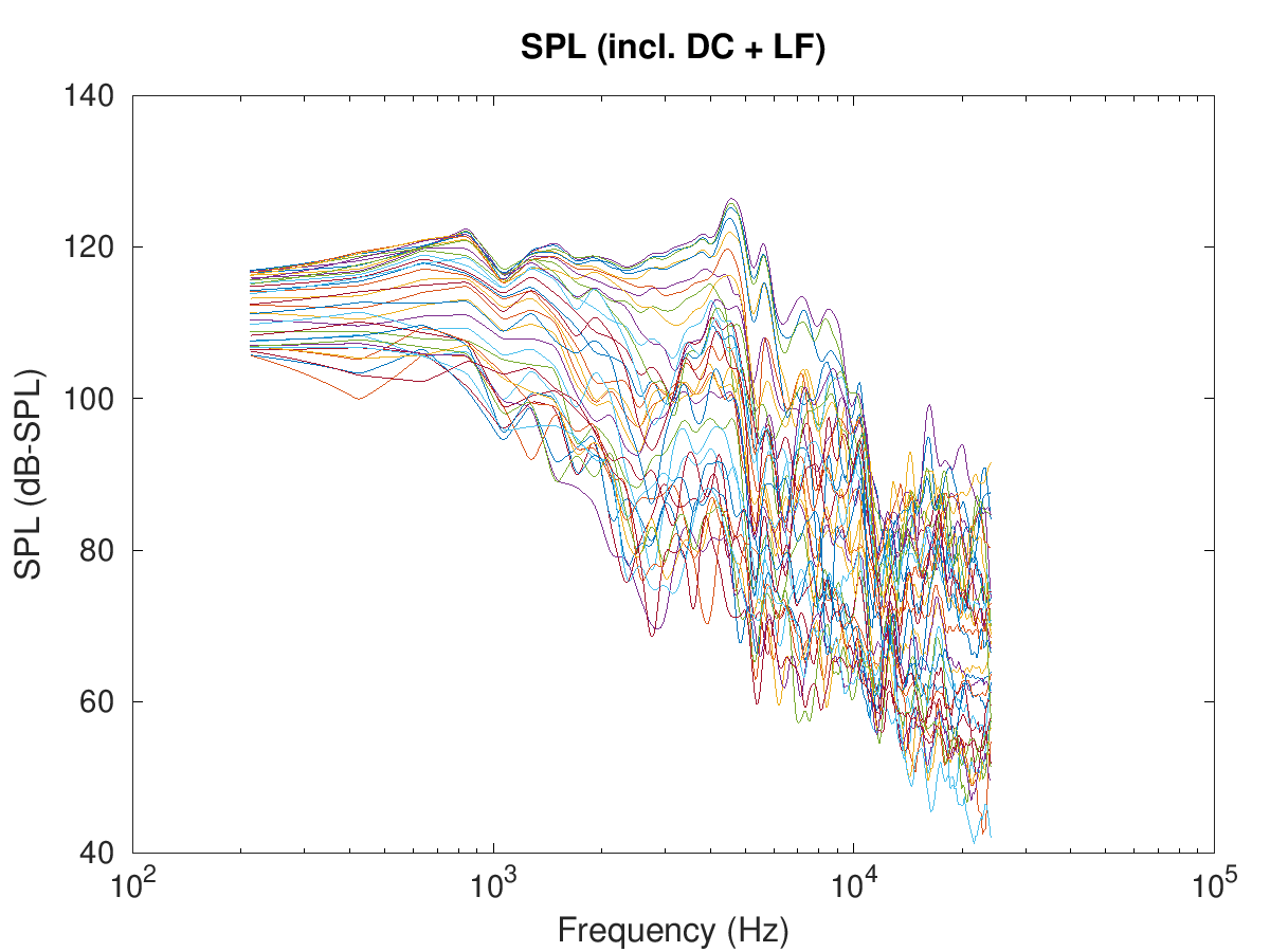

Hi mbrennwa, others. Spent a better half of a day doing measurements with ARTA and noticed too late there was arbitrary DC offset / low frequency noise ruining most of the measurements... Being novice, didn't notice it before trying to simulate crossover. Live and learn. I found some of you were discussing about the same issue back in January 2019.
I don't know when I have another day off to take new set of measurements so it would be worth trying to salvage some of these.
Any tips if there was a way to clean some of the low frequency anomalies out? Checked out MATAA but it pretty much requires some custom code bulk process files from ARTA? I would be pleased if there was a tool to batch process these since full 360 hor + ver measurement sets for a huge three way speaker was commenced
I tried to find out what was causing the problem afterwards, but didn't find it out yet. Might be bad connector in my old sound card. It didn't occur on single channel measurements, only on two channel. Tried swapping between left and right, same problemo.

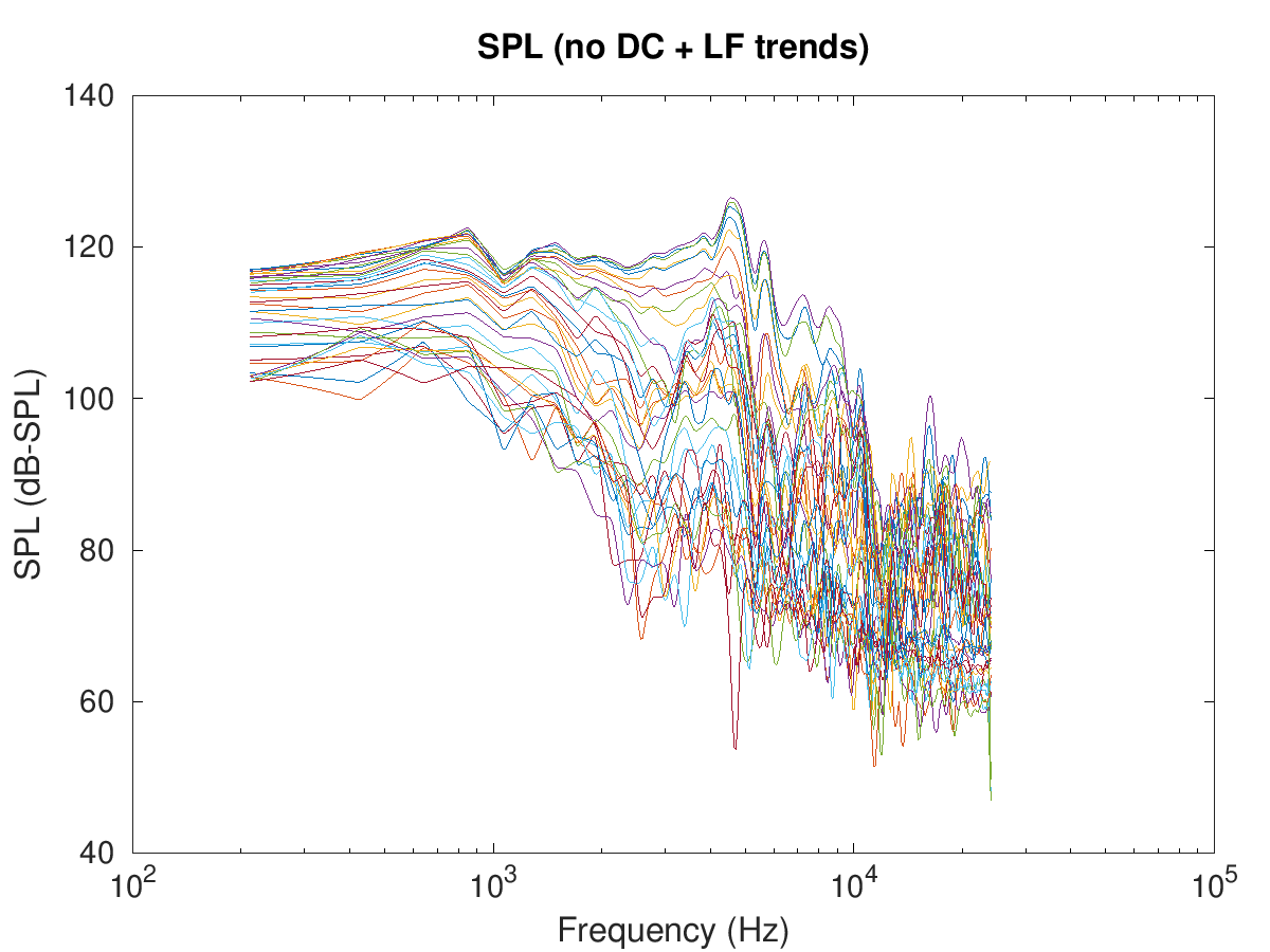

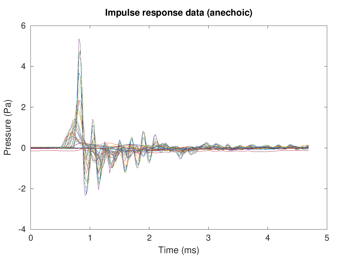

Ok, got it working. Import for binary ARTA / PIR data files to MATAA is now possible (see latest code on github). The example files I got from tmikku show some non-zero values for the (repeated!) reserved1 and reserved2 fields, which should be zero according to the documentation. I don't know if this is specific to tmikkus files, or if this is a general thing with ARTA. Another (and possible more concerning issue) I see with the ARTA PIR files is that the data seems to be uncalibrated, and the frequency response data of the microphone frequency response is missing in the data files. There is no way to "fix" the uncalibrated data for the non-linearity of the microphone (or whatever sensor was used for the measurement).
I attached an Octave m-file and three plots that shows how to use the ARTA import for MATAA, and how to remove the DC (and low-frequency trends/noise) from the gated impulse response data. With tmikkus data, the removal of the DC (and low frequency trends) does not make a difference, because the low-frequency cut off is at about 220 Hz after gating, and the DC / LF-noise is not relevant > 220 Hz.
Your were right about the mic calibration file effects the result. But why isn't that case with REW, which also uses the same mic cal file?That crap EMM-6 calibration file makes most of the curves. And there is no such thing as "correct smoothing". Just several different mathematical methods. Author or user chooses which one looks subjectively the best or is easiest to implement.

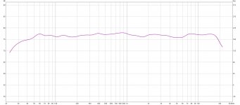

Here's the result with the mic freq. compensation file and 1/3 oct. smoothing:

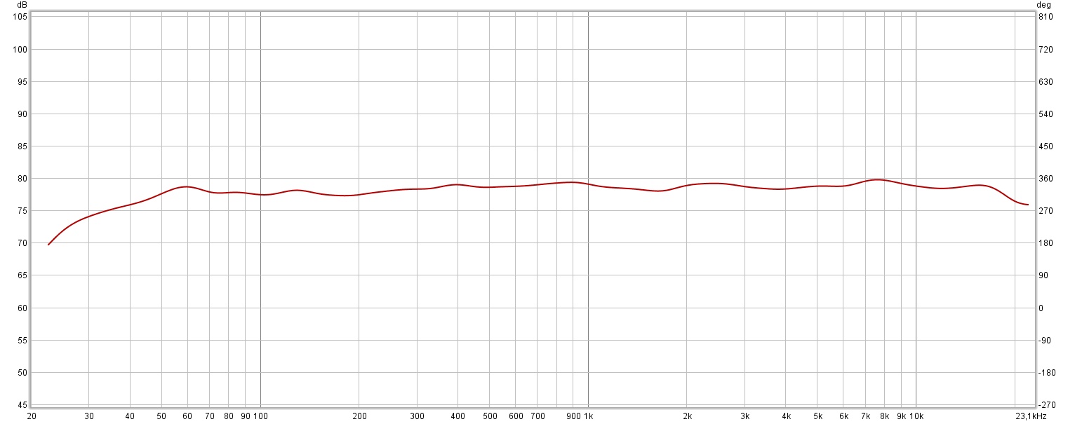

Without the calibration file. It's now much smoother in the highs but with a different low frequency response and which seems inaccurate.

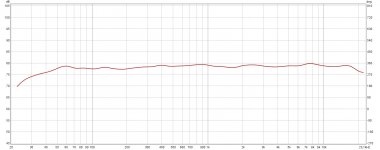

REW with 1/3 oct. smoothing with calibration file:

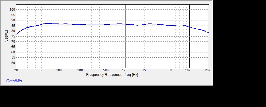

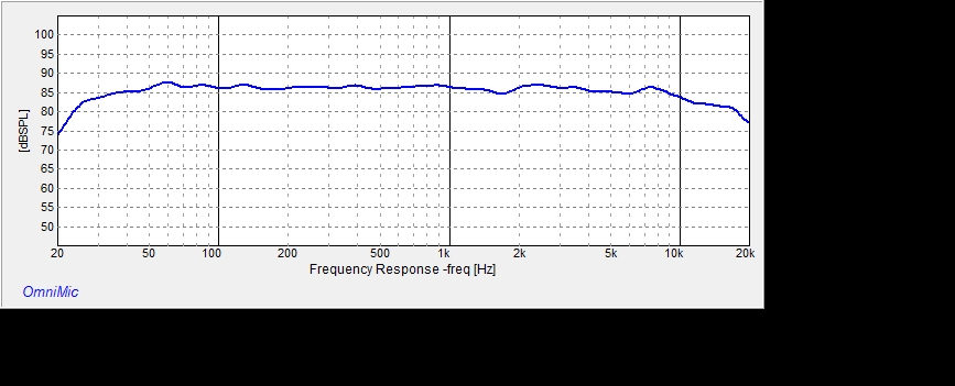

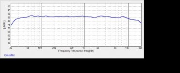

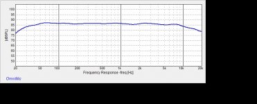

A new measurement with Omnimic and REW. Omnimic uses a different mic, which has a smaller diameter and which should give a more accurate result in the very highs.
Omnimic with 1/3 oct. smoothing:
REW with 1/3 oct. smoothing:
Omnimic smooths more than REW. Here's one with 1/6 oct.
You should ask this from JohnPM in some REW thread. Looks that products such as CLIO and ARTA calculate average pressure within given smoothing band. VituixCAD also for sure, but scaling to sparse f-axis causes more curves and level variation (at the moment).
REW calculates something else or graphics curve function causes much more smoothed result compared to previous.
Measurement program is free to assume that calibration file is fact and valid without smoothing separately or with measured raw response. Dayton should provide decent files which could be applied after smoothing of measured raw response.
Fractional octave smoothing defines a bandwidth but not a smoothing kernel. An average is one choice, though averaging is a pretty poor attempt at a filter and produces artefacts that are not what one would arguably expect to see from a filter of the specified bandwidth. Looking more broadly at smoothing functions across domains Gaussian responses are often chosen. Multiple passes of a simple running average filter provide a response that comes ever closer to a Gaussian with each pass, multiple forward and backward passes of a running average filter are one option for fractional octave smoothing.REW is radically too smooth if we specify that 1/3 oct. smoothing equals average pressure from -1/6 to +1/6 octs. Smoothing of pressure values with linear average leaves quite much small curves - even more than ARTA shows. REW probably uses some other algorithm than linear average. Maybe some curve fitting where octave band is just given name which has nothing in common with linear average within selected band. Smoothing with features of graphics libraries are able to produce same kind of "oversmoothed" curve than REW shows.
By default ARTA uses brickwall cutoffs at the specified fractional octave bandwidth, though the manual doesn't specify the smoothing function used over that bandwidth. There is, however, a "Filtered smoothing" option which uses a 6th order Butterworth bandpass filter shape. HolmImpulse applies its smoothing using a window function in the frequency domain, Blackman I believe. REW targets a Gaussian kernel of the specified bandwidth, though the implementation uses a very efficient method to closely approximate a true Gaussian filtered response.

Since you thought DC/low frequency noise error didn't matter in the measurement set let me explain where I noticed it:
There is a difference with DC correction or not (in VituixCAD) since it interpolates the missing low frequency response from the short FFT window (measuring at home). In VituixCAD merge tool, the low end is corrected by merging near field measurement and baffle diffraction data to the far field measurement allowing a DIY person to have acceptable data set to do proper crossover simulation. Not sure what is the math in the merge, but the result seem to have the trend from the far field measurement (low end shooting up randomly depending on the measured error!) and detail from the near field measurement. Long story short without DC correction some far field measurements were like 30db up on the bottom octave relative to others (say the next measurement, 10degree difference) so few measurements with most error dominated the low end, in VituixCAD.
So, whos fault is it? ARTA recorded error in my livingroom setup, and that error was pronounced in VituixCAD, so I think it is an operator error asked for help and got some, so thanks! Surely, it is hell of a task to measure and process data for a crossover simulation, many stage process prone to human mistakes.

I'm interested how did you figure out if the data is uncalibrated?
The data file has a field that contains the sensitivity of the microphone. The impulse response data needs to be divided by this value to get sensible numbers. This tells me that the impulse response data is simple the voltage coming from the ADC (soundcard), not the pressure data that has been deconvolved with the microphone frequency response to compensate for the non-flat frequency response of the microphone.
