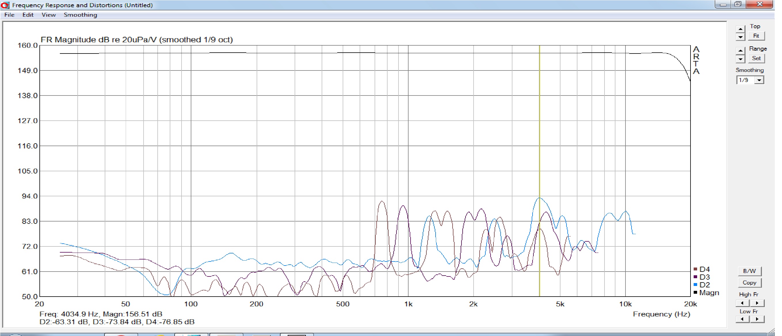

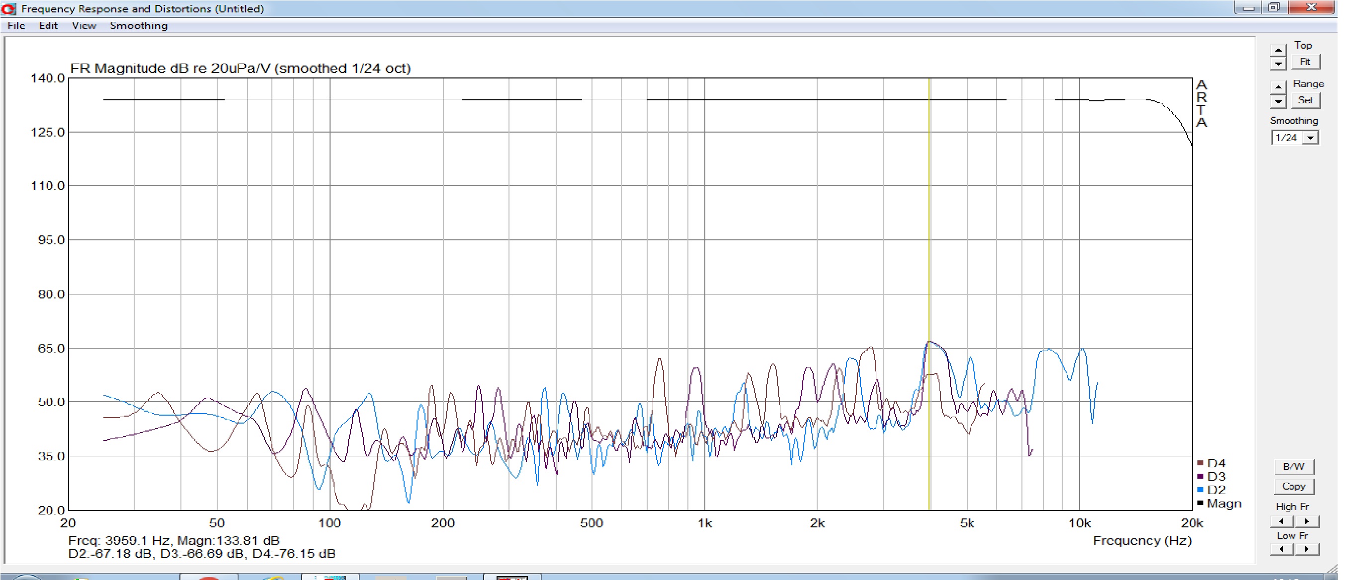

Hi, Ivo! How to take into account the internal distortion of the sound card when measuring an amplifier with distortions below the distortion of the sound card?
1. The "distortion" of the amplifier.
2. Sound card distortion, loopback mode.

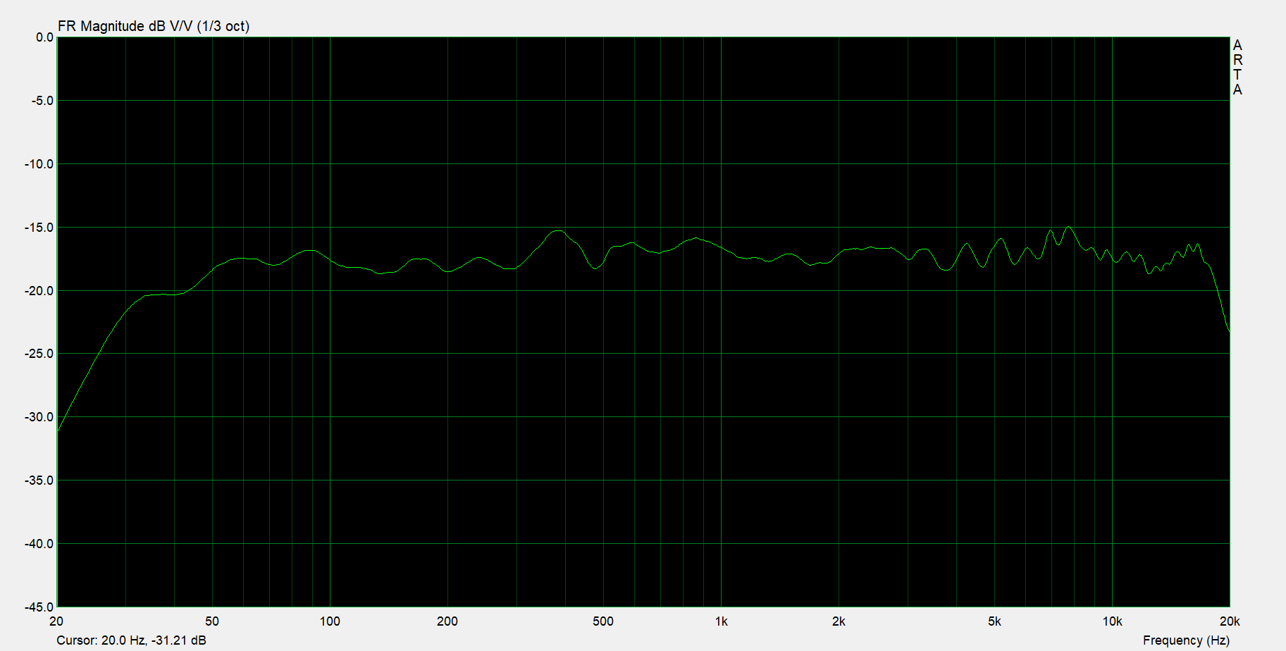

I keep constanly getting slightly different phase responses between repeated measurements, the changes are quite small but still large enough to screw up my loudspeaker crossover work, is there any known issues regarding this?
Unstable repeated measurement results
Well,
it is quite normal that you have small changes in measured phase. It is quite common that best Fourier analyzers measure phase with +- 0.5 degree error.
It comes from noise, clock stability, temperature changes, etc. of measurement device.
The acoustical environment also add error due to noise and time variant behavior of wave propagation.
Finally the measurement loudspeaker changes characteristics in time (mostly the compliance).
All that contribute to total error.
The averaging helps us to get statistically best estimation.
Ivo

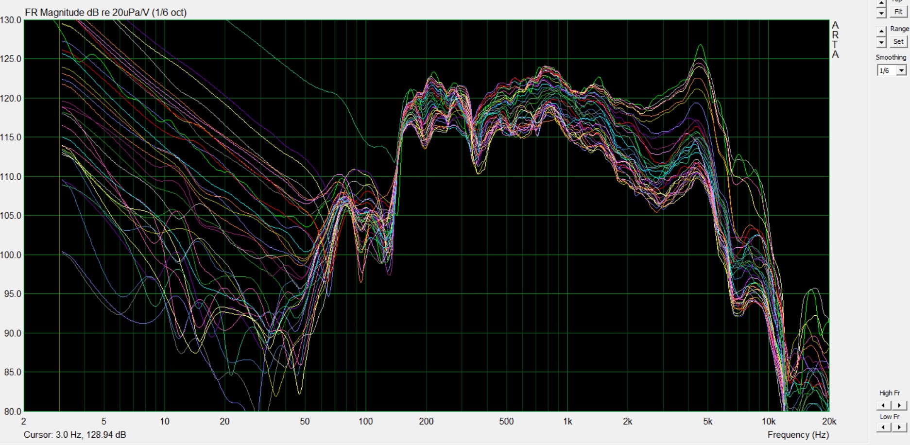

Hi mbrennwa, others. Spent a better half of a day doing measurements with ARTA and noticed too late there was arbitrary DC offset / low frequency noise ruining most of the measurements... Being novice, didn't notice it before trying to simulate crossover. Live and learn. I found some of you were discussing about the same issue back in January 2019.
I don't know when I have another day off to take new set of measurements so it would be worth trying to salvage some of these.
Any tips if there was a way to clean some of the low frequency anomalies out? Checked out MATAA but it pretty much requires some custom code bulk process files from ARTA? I would be pleased if there was a tool to batch process these since full 360 hor + ver measurement sets for a huge three way speaker was commenced 😎
I tried to find out what was causing the problem afterwards, but didn't find it out yet. Might be bad connector in my old sound card. It didn't occur on single channel measurements, only on two channel. Tried swapping between left and right, same problemo.
Thanks!

Actually, I got a link to a test version of VituixCAD that has DC offset option in the Convert IR to FR tool so my problem is kind of solved. At least the low frequencies between measurements are more uniform between each other and thus more usable in VituixCAD. Still cannot rely on the bottom end but at least can do some work with the measurements now. Better to confirm good data next time before proceeding too many hours 😀

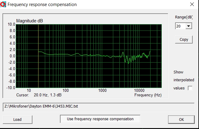

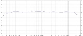

I don't see to get correct measurements with ARTA anymore.
The 1/3 smoothing with ARTA doesn't look very smoothed and result is very different from REW as seen below. I'm using version 1.8.5. I am using the mic freqeancy response compensation. Edit: I had forgot to update to the latest ARTA version on this machine. Just did it, but with the same result as below.

Hi Omholt,
I don't understand your first statement.
For me, the 1/3 octave smoothed ARTA measurements look very plausible. Your somewhat jumbled compensation file for the microphone can be found clearly in your measurement.
The REW measurement looks more like octave smoothed.
Regards
Heinrich

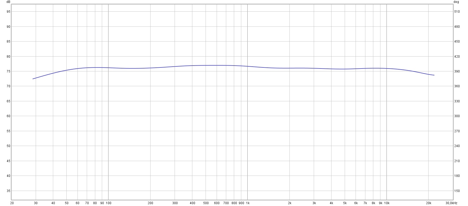

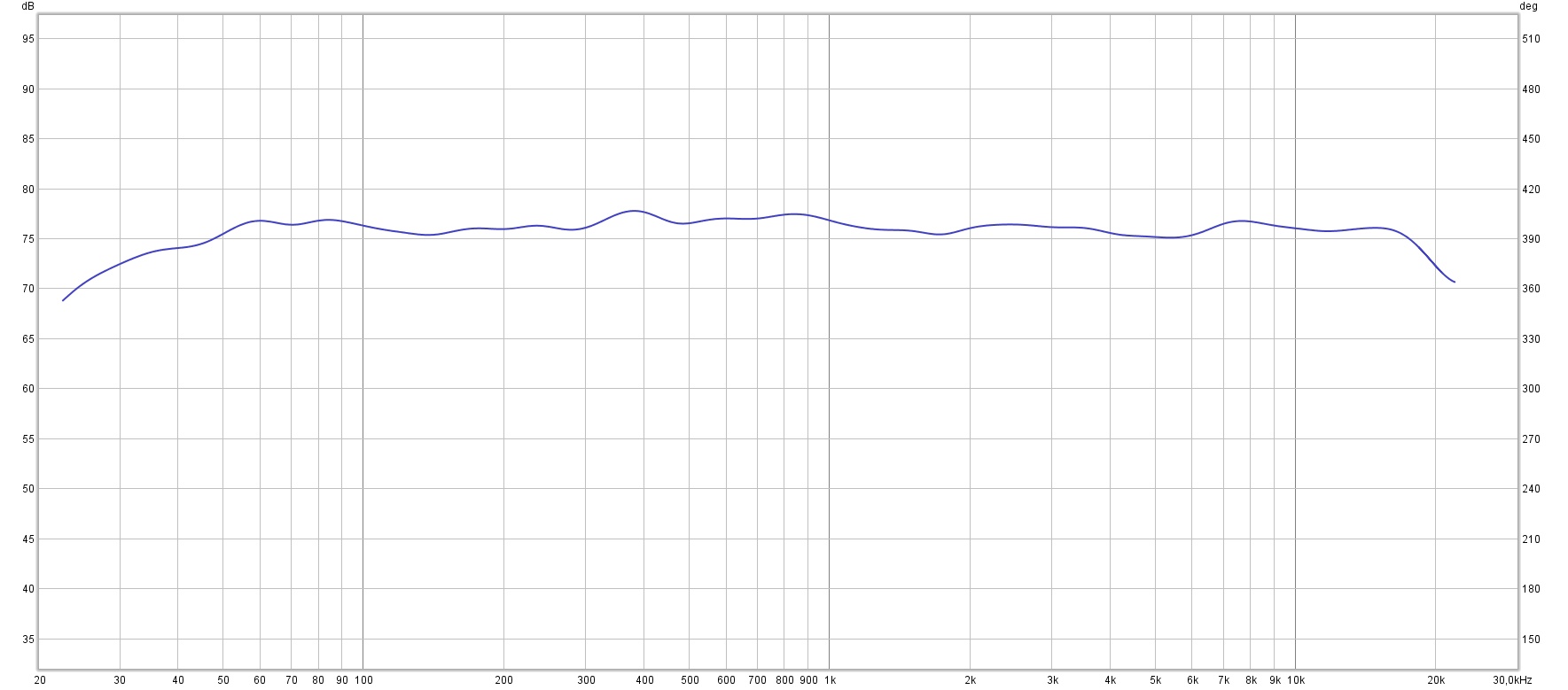

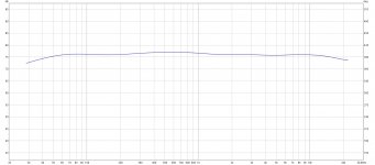

Thanks for the reply.
The REW measurement is with 1/3 oct. smoothing. Using 1/1 smoothing in REW would look like this:
attachment.php
I'm pretty certain the REW measurement is correct but I will double check with a third software I have.

That crap EMM-6 calibration file makes most of the curves. And there is no such thing as "correct smoothing". Just several different mathematical methods. Author or user chooses which one looks subjectively the best or is easiest to implement.
