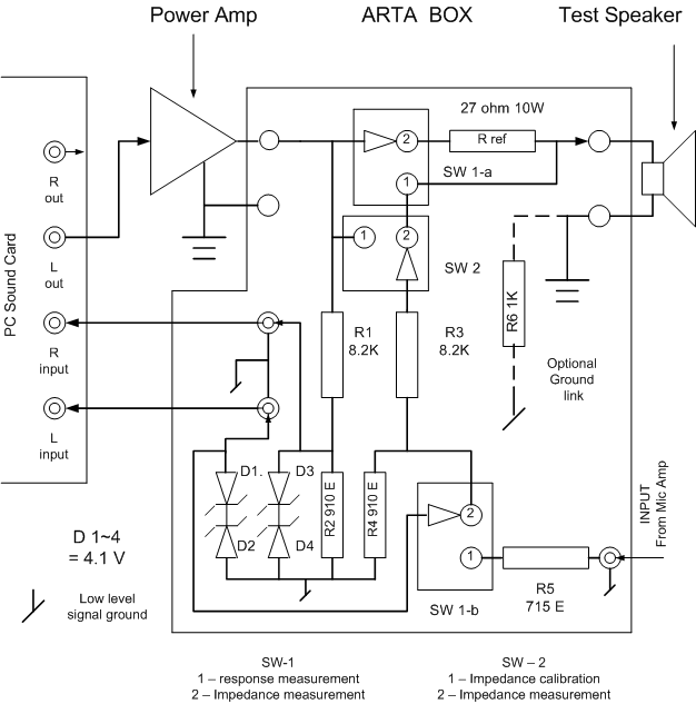

I have problems to build my ARTA Box is not easy to find metal film res here in Argentina,
ARTA recommend the following components to build the box.
Res
27 Ohms 10W
8K2
910
715
1k
Zener 4,1
and i found
23 ohms 8W
8k
1K
715
1k
Zener 3,2v
is not posible to use that values?

You can use a combination of resistors if you want exact values.
However I think you can use different value resistors and adjust the values in your set up ( computer input when calibrating ).
I am about to make an input box myself but have not yet read the set up details closely. Read up your instructions again. Maybe the values you have are fine.
I’ve redrawn the diagram . I’m looking through the application note.
I think that R1 must be = R3 and R2 = R4.
A formula is given to calculate the variable ‘r’ with different resistor values.
The 27 ohm resistor is not mentioned. Maybe I have to go back to the ARTA user’s manual.
Note that both channels must see the same source resistance.
The L channel measuring the mic output will see R5 ( = 715 ohms ) + Z out of preamp assumed to be 100 ohms. This is totally = 815 ohms.
the other voltage dividers will each be 910 ohms parallel 8.2K .
This is about 819 ohms. That is within 0.5 % of the mic measurement setting.
So if you change any resistors you will have to make sure this relationship is maintained.
