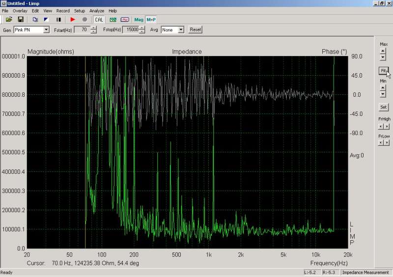

Hello
I’m having problem with LIPM. (ver 1.4.1)
I’m trying to measure full range speaker (70Hz-15kHz) impedance using LIMP and my laptop, computer has on board Conexant AC-Link sound card, I am using head phone output and mic input for jig connecting. Jig uses 100,4 ohm/0,5W metal film reference resistor (measured). Calibration seem to be ok with (Seq length 32768, Fs 48000 Hz, Channel dif 0.03 dB) no matter what type of method is used (SIN or Pink PN) impedance graph looks odd. (Please have a look attached print screen) I was trying to change laptop with Vinyl AC’97 Audio sound card but graph looks similar..
I was trying several setup configurations during measurement but unfortunately none of measurements does look like standard impedance graph..
Where is the problem ??
Artur

No idea! 🙂
I mailed Ivo about this some time ago casue I had similar problems myself as I simply assumed that the laptop I used had a stereo input. Ivo told me that usually it's a mono input and therefore LIMP needs an external soundcard.
/Peter

cypher said:![]()
Good point, but how to check that to have 100% sure??
Easy. Use a stereo 1/8" cable and connect the output to the input. In Arta go to record an impulse and hit generate. Now use your volume control to slide the balance to the left and right. If both input channels remain at the same level, you have a mono input. I've tested an IMB Thinkpad T42 and Dell 600m like this, both were mono.
Dan
