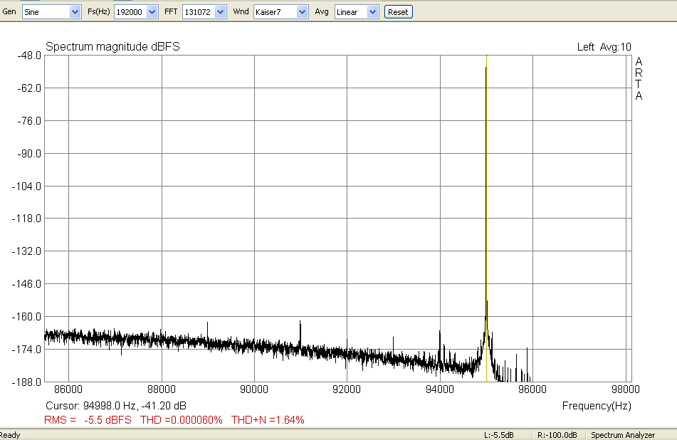

I was using 1.7.1. I upgraded to 1.8. I found the "dc" component and removed it. The AK5394A needs a small DC offset to remove some distortion things that happen at zero. It also has an internal high pass filter. I turned that on and the DC went away. But the problem was still present.
It seems ARTA is finding a single very narrow tone at 94998 Hz. Praxis doesn't even look that high. I'll check with AKM about it today. Its generated internally to the ADC.
I would be helpful to set the measurement range in ARTA to preclude ultrasonic stuff. Meanwhile, having found this I'll work on getting rid of it.
It looks like the 1 kHz mirrored around half the sample rate.

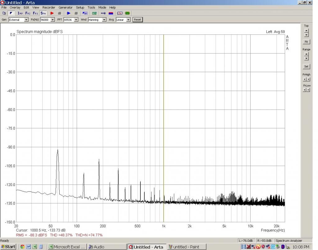

Here is a screen shot of loop back on my work laptop with some additional grounding with the best results:
A few things with my loop back; 1) The high frequency grass is the same on different laptops, but a bit better with additional grounding. 2) This EMU 0204 does not do well with 192KHz sampling, so I use 96KHz. 3) This EMU 0204 also tends to 'skitz' out every once in a while and I think it is an internal issue. If I am in loop back and watching my averages...after about 20 seconds it stops the sine wave but continues to record. Sometimes the sine wave comes back and sometimes it does not. Does this with REW and Audio Tester.
I think at this point, I have what I have and this is the best I am going to get with 'my' hardware.

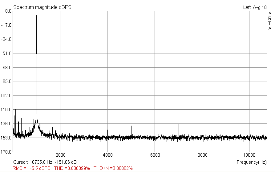

Here are screen shots of 10 Watts & 95 Watts. For internal, I used the ARTA sine generator. For external, I used my HP 8903B as the source.
The power amp I am using definitely could use a power supply improvement from 1) design and 2) age of caps. But the focus here is to see what is in the spectrum and I'm finally very happy with the results.🙂
External Sine @ 10 Watts
Internal Sine @ 10 Watts
External Sine @ 95 Watts
Internal Sine @ 95 Watts
It's still a little grassy, but I can live with that. My THD+N measurements from ARTA are equal with the THD+N measurements from my 8903. Also, I calculated THD with the various harmonics by hand (well using my Excel spreadsheet) and they calculate correctly to the ARTA values (not that I was expecting different).

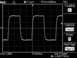

Square Wave:

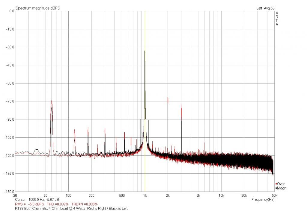

Both Channels @ 4 Watts:
1% Distortion:

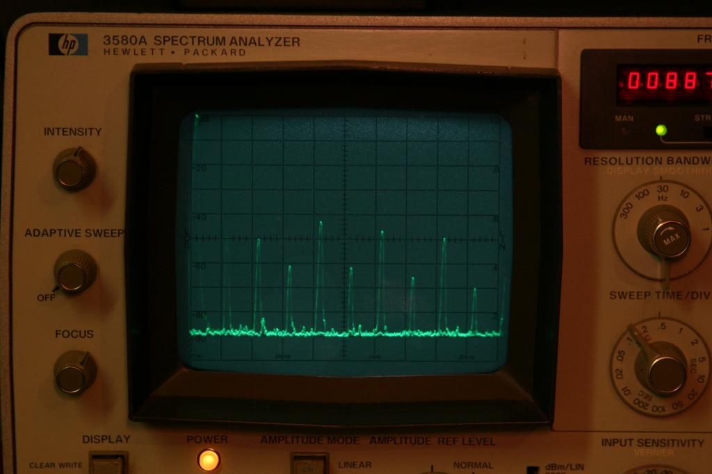

1% Distortion on my HP 5380 Spectrum Analyzer (sweep starts at about 900Hz and is 1000Hz / division):
A few quick notes...I did not grab any screen shots while using my notch filter. Also, when using ARTA, I use -5dB as the peak of the sine wave. If I adjust the sound card input for 0dB with the sine wave, the level indicator on the sound card peaks and it distorts the signal. If anyone has any suggestions...please let me know. I'm fine with using -5dB; if calculate manually, I just compensate the -5dB in the calculation.
