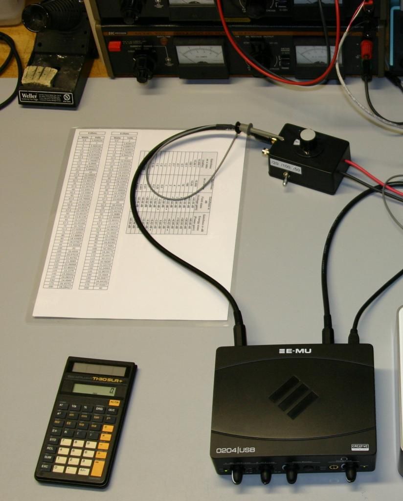

Hi Lemon,
I built a resistor divider box. You will see it in the photo below. The red and black leads go to the amp and then I have a BNC and RCA post on the output. There is a switch to select divide by 20, 50 or 100. This accommodates most of what I have. The knob and potentiometer were for round one of the design. This allowed me to vary the division ratio. However, the pot creates too much noise...I removed the pot from the circuit and then built the resistor divider with the switch in the same enclosure.
I forget the resistor values at the moment; but I used ohms law to figure out the ratios. In loop back with the highest output of the EMU / ARTA combo, there is no noticeable noise or added distortion using the /20. For what I test, it works fine for me.
A Pete Millett interface would be nice, but I had these parts on hand and can use the second output connector to check my output voltage on a meter.
Let me know if you have any other questions.

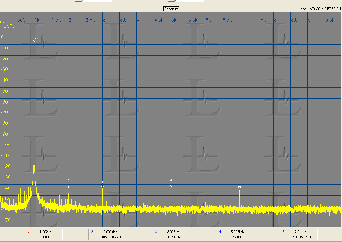

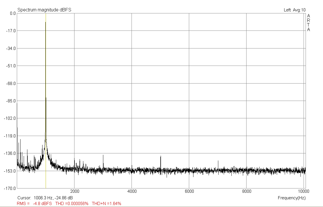

Thanks for the plots! I had to stare at the ARTA vs HP a bit to see how they related. at first I thought they didn't, but closer inspection shows they do. The 1% plots both show the high odd-order distortion from H5 and beyond.
The ARTA plot just reveals so much more noise. Is that an artifact or does the soundcard just see further down into the dirt?
The emu0204 is capable of measuring below 100nV and further if gain is added at the input So yes it can "just see further down into the dirt".

Pano, The two images were acquired at the same time (ARTA and HP). I had the HP connected to the amp output along with the EMU. I set the peak of my ARTA at -5dBFS and the peak of the HP at 0dB. Yes, there is a 5dB difference in measurement scales. I need to purchase the license copy of ARTA to be able to clean up and change scaling in the software. Or, I could set the HP for -5. I would prefer 0dB for both.
The HP can see to -90 at its best. As Davada said, the EMU / ARTA combo can see much lower. The vertical scale on the HP is on the left and it is set for 1KHZ per division on the horizontal scale. So on the HP, you are seeing 1KHz signal and then harmonics up to 10KHz. I could have changed the ARTA scale to just see the same (1K to 10K), but I wanted the whole spectrum. And yes, it is a little 'grassy' on the higher frequencies.

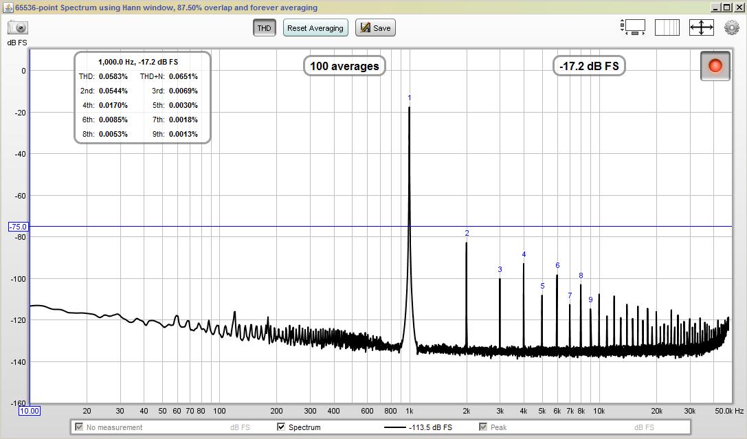

My DAC presents unique -30dBFS to -45dBFS range performance than any other manufactures', even the 'TOP of HI-END'.🙂
You can refer to the measurement below:
This is where some of the Analog Devices do so well, also.... lowest distortion at -60dB. Distortion compared at -40 and -60dB is a lot more important than at max/zero dB number.
Looking at your linearity plot at -100dB and below shows the non-linearity clearly.... and why it cannot be used as a test instrument below that level... even though FFT software would let you think you have ability much below that.
THx-RNMarsh
Hi Lemon,

Hi Lemon,
Grounding and noise are critical with the setup. 1audio (Demien) and several others have mentioned various ground configurations with the EMU and DUT. On my input and output cables I have the mini-grabber connected to my ground. This makes it easy to try different ground configurations or lift the ground completely.
You may want to try eliminating the voltmeters and other devices connected. I noticed when I had additional voltmeters connected on the output of the voltage divider, it caused noise and sometimes ground issues. Try an ARTA measurement without your meters connected and then try some ground configurations.
There are interfaces out there that have a built in meter and buffer circuits... I used to think I would need to measure the input to my soundcard; now I'm comfortable and I don't measure it anymore.
Hope that helps.
