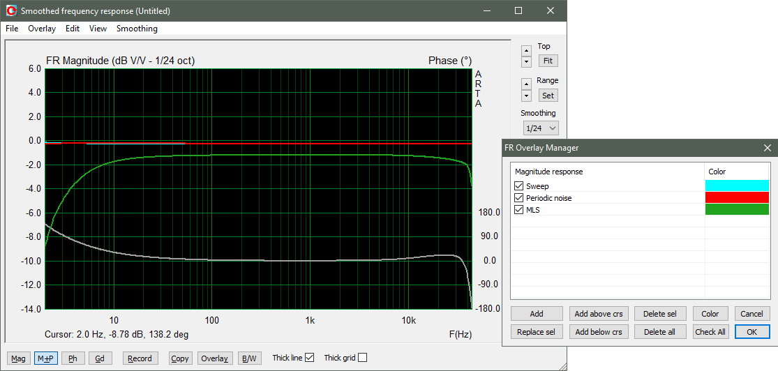

You've probably read this document. That does not contain a word about calibration of sound card. Why? Because ARTA uses cross-correlation function in dual channel mode with sine sweep and periodic noise so calibration of sound card is not needed assuming that channels are equal (as good or bad). The result is probably more wrong if you create some compensation for sound card and include it to mic calibration file.
Loopback example with my test Focusrite Scarlett Solo 2nd gen.

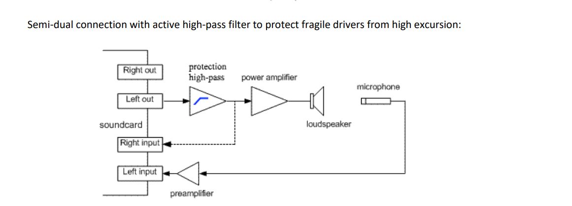

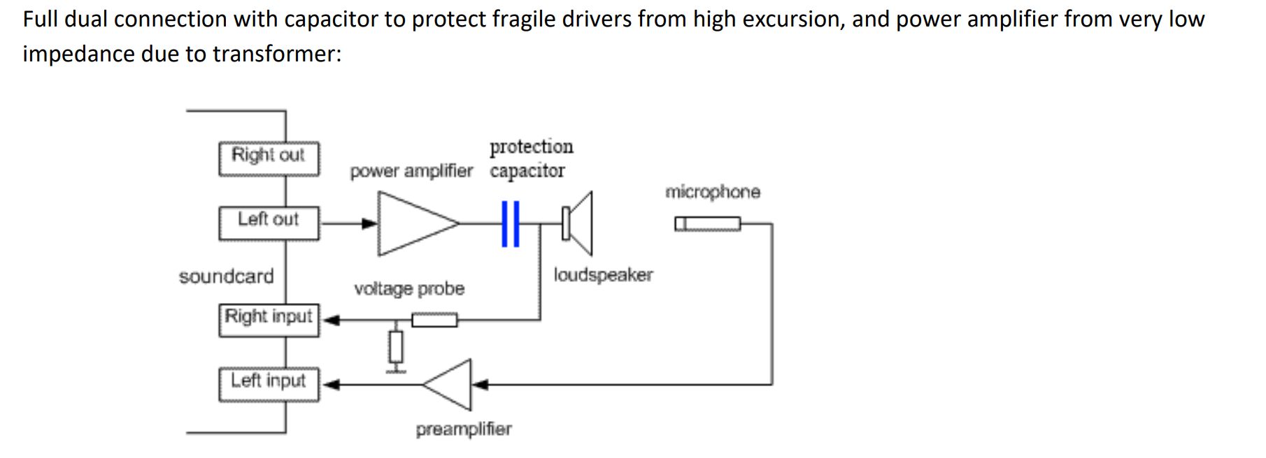

Would something like work as an active XO for tweeter protection?
Rolls Tiny 2-Way Crossover (SX21): Amazon.ca: Musical Instruments, Stage & Studio
And then just use a splitter on the output with one to the amp and one back to the soundcard right in?
