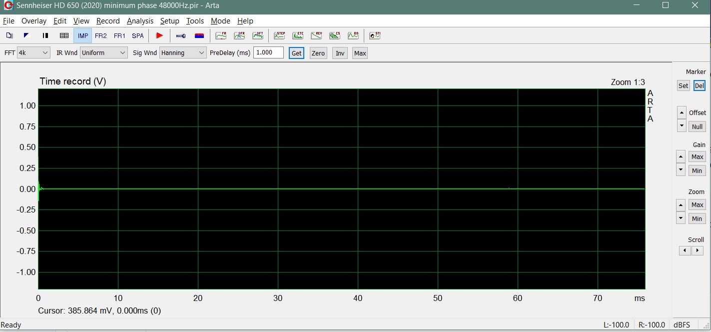

I'm trying to understand how to use ARTA to analyze impulse responses.

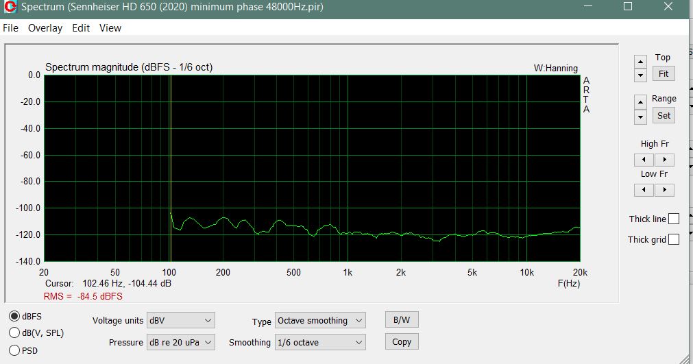

I have successfully recorded Impulse responses from external source into ARTA. When I look at them, they look ok and and I can then click the "FR" button to show a smoothed frequency response from that IR. All seemed ok.

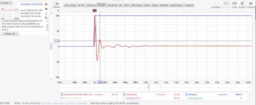

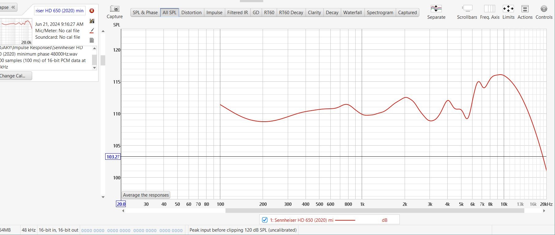

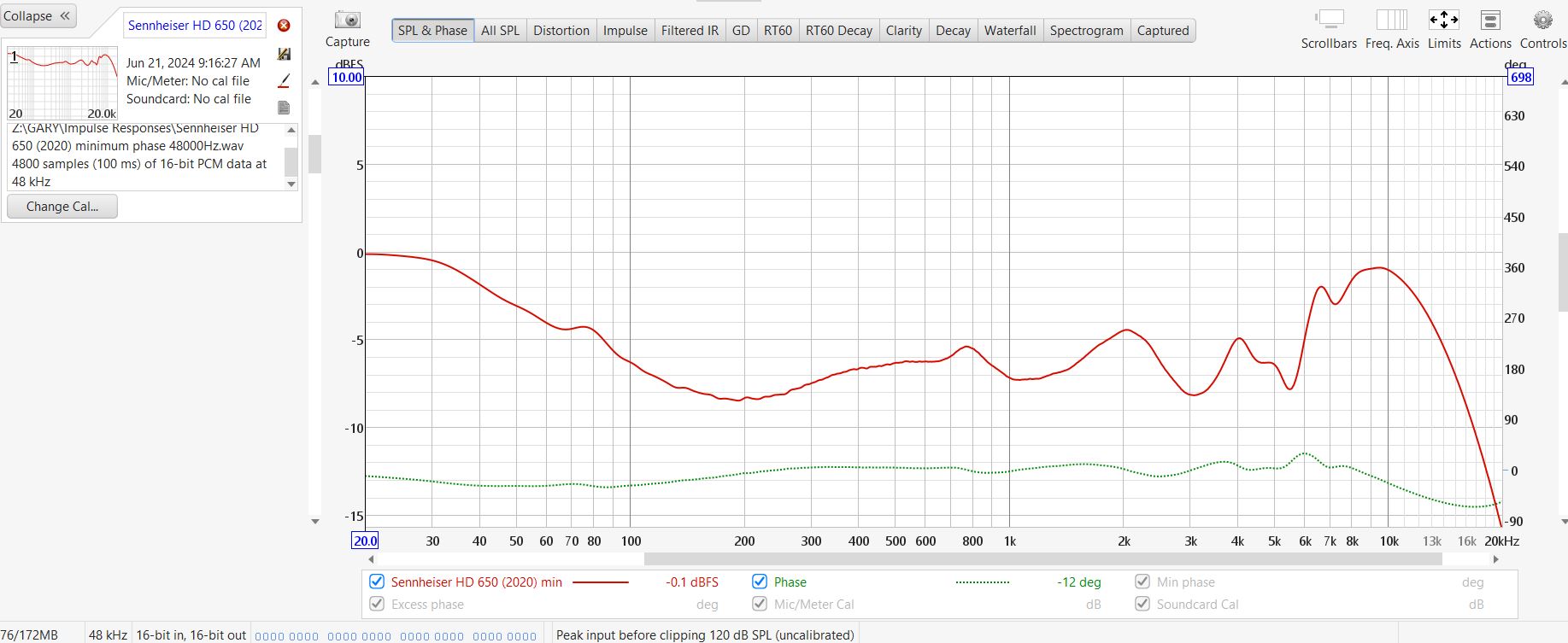

Then I exported the IR as a wav, and imported it into REW and looked at the resulting frequency response in REW and the two programs don't match.
Not being sure what I'm doing or if I'm doing it right. I found an IR, actually one I use for my headphones as a correction. I imported that file into ARTA by being on the IR screen and doing a File/Import/.wav and selecting the file. I did the same thing in REW.
When I look at the two IR's on the screen, they look the same. Or at least as much as I can tell. Both go positive, then negative at around 48u, then back positive at .103ms, etc. By using the cursor the timing looks the same.
However, when I click the FR button on ARTA to get a frequency response and SPL/Phase button on REW, the two response curves are nothing alike. Furthermore, since I know that the FR of my headphones is suppose to look like, I know that the FR from ARTA is way off. I have attached files for the IR and the FR from both packages.
What am I doing wrong? How do I get ARTA to properly show me the FR from an IR?
NOTE: The reason I'm doing this is I have an application where I need to record and IR from an external source (clapper). REW will not do that and since I own ARTA I'm trying to learn how to use ARTA to properly do that.
Well, in order to take the "recording in ARTA" out of the picture. I imported a known IR, that's what the above shows. The SAME IR imported to both programs and the resulting FR from both programs. All I did was import the IR and show the FR.
The FR from ARTA is way off. So I'm not doing something right. I can't do anything in REW to make it give me even close to similar graph as I get in ARTA and I can't do anything in ARTA to give me even close to similar graph I get in REW.
I'm at a loss as to why not. They both should produce the same FR. For instance, ARTA shows decreasing from 8k to 10K, REW shows a huge increase from 8K to 10K
Maybe, but use the same event for the start of window - at peak. So should be OK and comparable...
Starting the event at peak is CERTAIN to give HUGE errors. Different windows will give different huge errors.
You need to start your window BEFORE ANYTHING HAPPENS and the window musn't muck up (ie reduce) any of the important, big parts of the IR. ... from DSP 101
Try setting "NO WINDOW" (might be called RECTANGULAR WINDOW) on both programs and make sure you are analysing EXACTLY the same amount of info.

You've already been told what to look at - IR window settings. Hint has been given, shown by yellow line on ARTA IR screenshot - window start is beyond the impulse peak, and FR magnitude shows noise level -110 dBFS. Move Window start in ARTA to t=0 and try again. Increase FFT length beyond 4k samples would be wise if you want ARTA to show the FR below 100Hz.
Reactions: witwald
Ok, thanks.
So I have now the cursor at 0ms as you can see from the attached. It won't let me increase the FFT beyond 4k in ARTA, it gives me an error that the "FFT length exceeds number of samples" so I windowed the IR in REW to the same so they match. In ARTA, from the help file, it says:
If the marker is not active then the gate is determined as part of an impulse response that starts at the cursor position and has the length equal to the length of the current FFT
And the marker is NOT active, so the gate window should start at 0 and go to 4k.
But I still get wildly "wrong" FR from ARTA.

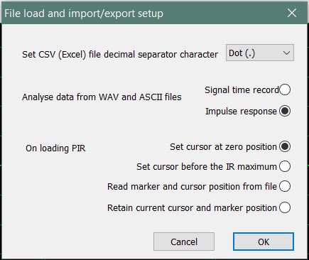

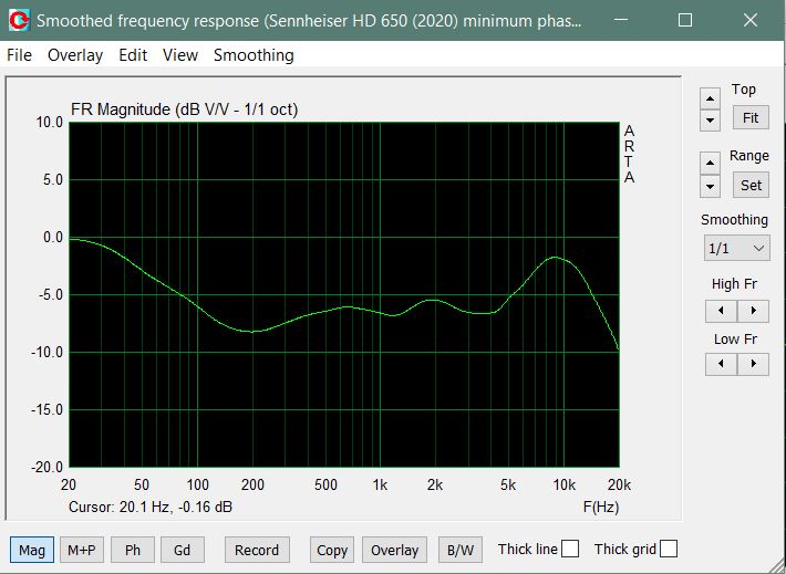

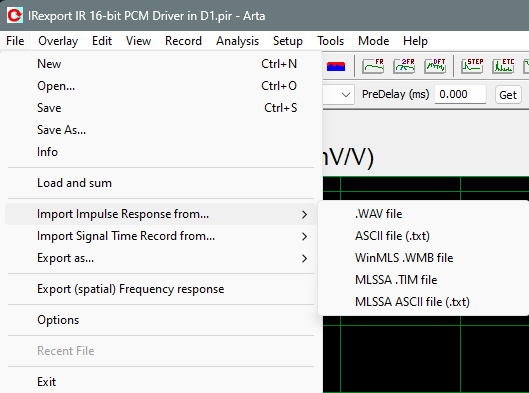

Ah, finally, that was it!
From looking at the "import" menu, there is no choice of importing as IR. So I started looking around at other menus to see if I could find something. It turns out it's in the "options" menu. The options menu has a setting for "analyse data from wav and ascii files" and the options are "signal time record" or "impulse response." I have attached a screen shot showing the menu.
Once that was set to "impulse response," I got the results I was expecting as you can see from the new screen shots of the IR and FR screens.
Thanks for hanging in there with me and noticing that.
