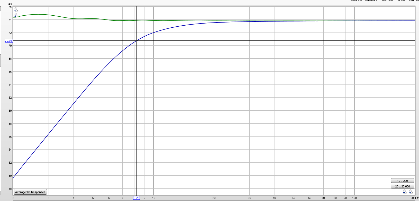

The ClEANBox Pro is the cheapest solution I could find for unbalanced to balanced conversion with gain for connection of consumer gear to pro amps. It can also convert balanced to unbalanced but I don’t use this feature. I’m using the ClEANBox to drive 4 dual opposed 15” sub woofers in a small room so I can potentially get a flat in room response <10 Hz, however this needs quite a bit of EQ and I would like to avoid any device in the signal chain causing additional low frequency roll off that will require more EQ. From searching on the internet I found out that the CLEABox Pro is -3dB ~8Hz. I’m going to show you how to lower this to ~0.3Hz which results in a flat response down to 2Hz (limit of how low I could go in REW).
Results:
A bit backwards but here are the before (blue) and after measurements (green) showing that the LF corner frequency has been moved way down in frequency. Residual ripple is due to measuring below the corner frequency of my computer sound card and temperature variation causing a change in the loopback compensation calibration).

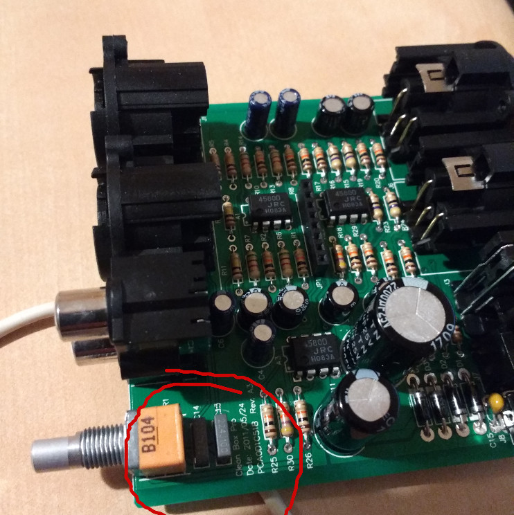

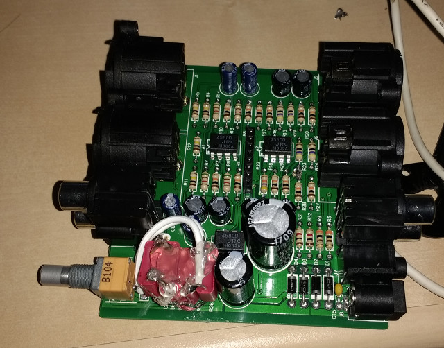

Just replace the two grey capacitors in the picture below with larger value capacitors. The ones installed are 220 nF nominally, I measured one as 235 nF. I replaced them with 2*1uF capacitors which measured as 2.2uF in for both channels. The original capacitors are some kind of film capacitor which I would also recommend for this application. Ceramics are tempting due to the smaller size but they are prone to microphonics which makes them a bad idea for audio!

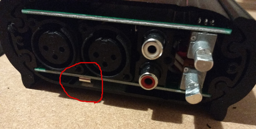

The CLEANBox Pro is quite easy to take apart, just remove the screws. There are two trickier bits; firstly the volume knobs need to be removed, to do this just lever them off with the flat bit of a screw driver they are only a friction fit, the second difficulty is that there is a ground spring on one of the boards that needs to contact the sanded portion of the case on re-assembly.

I just used some wimma film capacitors from my junk box I think 2*1uF in parallel. A 2.2uF per channel would be neater.
