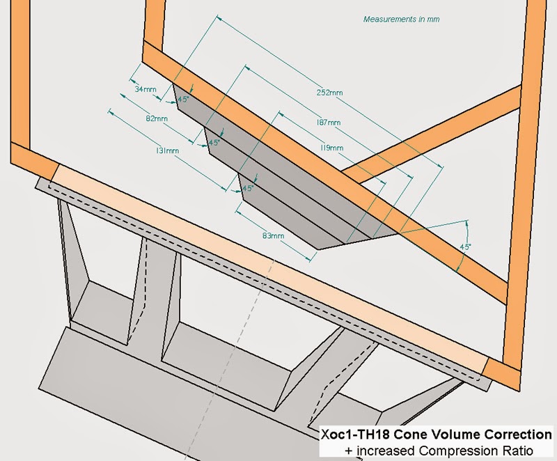

Wanted to bring this to Fins attention and post it here for easy reference.
I believe this is djim's design for the 2400 . TH18 xoc1 thread.. Post 1633

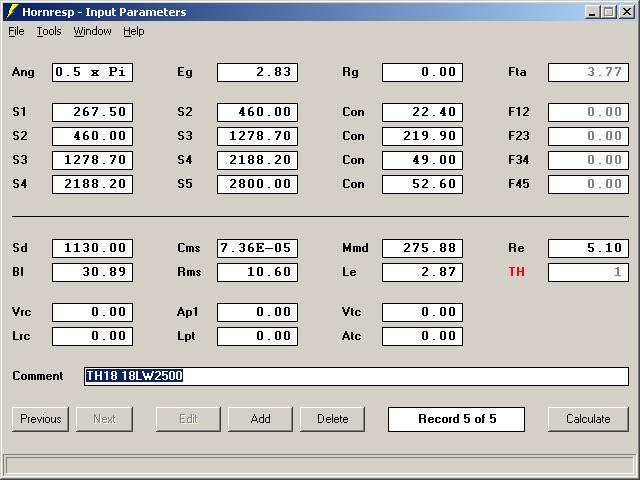

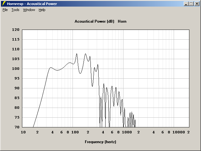

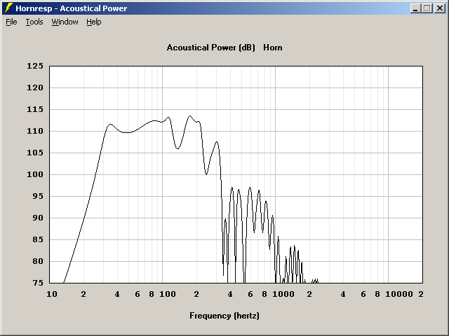

My first time using hornresp.
No surprises i am getting slightly different results.
Any suggestions on what I am doing incorrectly?
TH18 with 18Sound 18WL2500

Was that sim with both drivers driven with the same input power?

AH I just discoverd the Ang setting.
0.5 represents the box in a corner, 2.0 would better represent outside near the ground with no walls:
