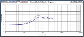

Trying to get my head around this. And struggling, so was looking to simulators to help me understand, but also didn't get to one that seems to answer this. Which simulator would you recommend?
I was using Bagby's Diffraction and Boundary Simulator, but it models baffle diffraction response on axis and I think doesn't show dispersion or modelled behavior off-axis.
Nevertheless, I played with this simulator and assumed:
- 5.5" piston diamater driver (for a 6" midrange)
- 24" height baffle, with driver centered vertically (it would have more drivers above and below)
- 8 feet listening distance
- 1" baffle edge radius
- Simulated baffle width at 8" (blue line) and 14" (grey line), driver always centered
You can get directivity from JB's diff &bndry sim but it takes a little extra work.
Look in the upper right hand corner of the big black control box of the top left of the screen. There you can set the observation point in off axis angles both vertically and horizontally. By looking at multiple angles and manually recording data....

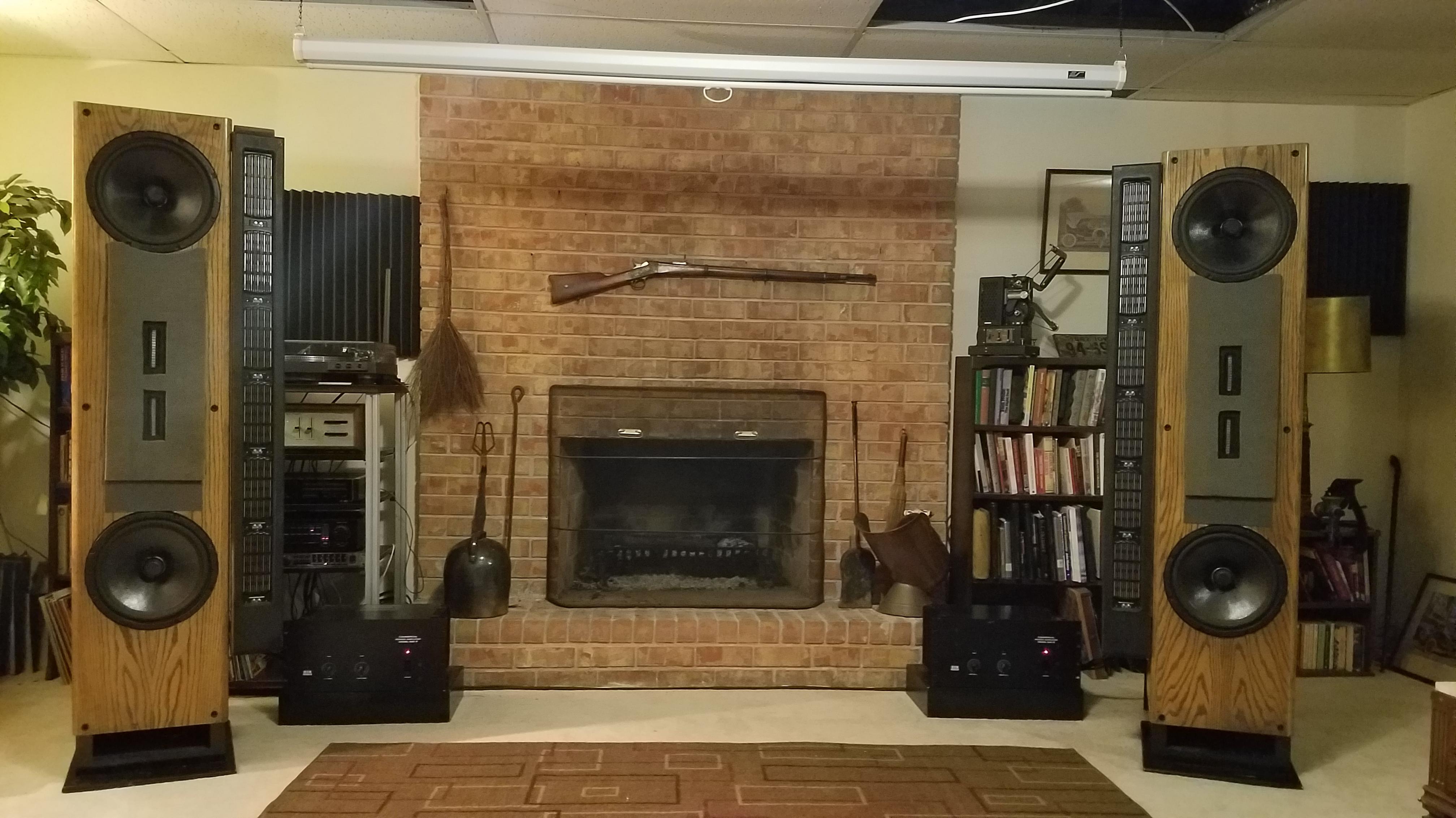

The last one I built was had the midrange from floor to ceiling. This one will be at the 70%(or so) of the height from floor to ceiling that Jim Griffin specified as the minimum for coupling the ceiling and floor. My other one was a three way with a 12 inch woofer, 17 3.5 inch full ranges, and 32 Dayton domes with cut flanges giving the CTC at .90 inches, per channel.
This one will be a 4 way, 12 inch woofer, 8 inch mid woofer, 18 2.5 inch full ranges, and 7 ribbons. As before I will be using active crosses, but instead of using 2 ported subs, I will be using 2 sealed subs with equalization. The subs can handle 250 watts RMS, and I have 375 watts RMS in that amp, so plenty of power for equalizing below 39 hz.
I love line arrays. Its so nice to play Toccata and Fugue by Bach and close my eyes and think I in a church with a real organ.
Thanks for your kind reply.
Eric
Works for me.
I'M ASSUMING THAT that ribbon on the side is your mid. What is that?
And the woofer line looks like it couples too. Although my experience with the other array I built was that having a 2.5 -3 octave mid range coupling was all that was necessary, since its the critical range of the most sensitive hearing(see Fletcher Munsson curves).
I can't afford to buy four more 8 inch mid woofs to add to the existing 2, but I wonder what an additional coupling of that range would do!?
What could be bad about having more mid-bass 😀.
More seriously, it could really help out to spread the mid-bass like that.
