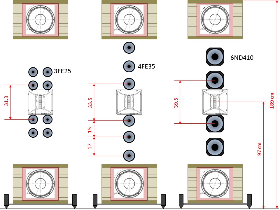

I did some quick drawings to picture some alternatives. Used PowerPoint as I don't have ACad anymore. Good enough at this stage. Please ignore the midbasses for now. I placed the TPL at ear-level, for the time being with horn included - especially if I'm to lower the xo to around 1.5k I definitely want the horn I think.
The left drawing uses 3FE25. Is this the configuration you envision? So side-to-side drivers to shape horizontal directivity, and same for vertical?
For all options I could use more drivers, but especially for 4FE35 and 6ND410 I would space them closer together as total height would soon become a constraint.
I imagine the 4" and 6" options would provide good vertical dispersion, right?
For horizontal dispersion I don't have polar plots for these, but can approximate using: dispersion= 1,000,000/(effective diameter x frequency)
So for the 4" 4FE35 I estimate 3.5" effective diameter, and then dispersion @ 2kHz would be 142 degrees...a mismatch with the 80 degree horizontal dispersion of the TPL150H. Here it would make sense to use the TPL without the horn. Correct?
For the 6" 6ND410 I estimate 5.25" effective diameter, and then dispersion @ 2kHz would be 95 degrees which I guess is close enough to 80 from the TPL with horn. If I were to drop the xo point, however, at 1.5kHz dispersion would be 126 degrees so a mismatch with the horn again.
Then I also need to run xDir to look into c-t-c lobbing effects. I struggle with the underlying assumption in xDir that midranges are point sources, even the tweeter where my tweeter is not a point source and the midrange arrays wouldn't be point sources either, hence not sure the result of these simulations are valid. The midrange array presents itself as a line source rather than a point source, so MTM effects might be a lot different.For the 6" 6ND410 I estimate 5.25" effective diameter, and then dispersion @ 2kHz would be 95 degrees which I guess is close enough to 80 from the TPL with horn. If I were to drop the xo point, however, at 1.5kHz dispersion would be 126 degrees so a mismatch with the horn again.

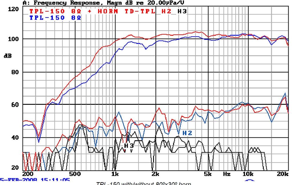

"Each Beyma TPL150, which leaves our house, undergoes a modification, which eliminates a small weak point and makes the frequency response in the critical range by 4 kHz"

I think you've got the general idea - stacking drivers horizontally in attempt to match horizontal directivity, offsetting additional drivers vertically to control vertical directivity in MTM fashion.
I wouldn't put four 3" drivers stacked 2H x2V because that puts their center where the center of an 8" driver would be. I would go three across instead to get the center closer. The same considerations apply to your two left hand drawings - the acoustic center of each pair of vertically stacked mids is more distant than would be that of a single 8" driver and the 8" driver would be a better, even good match horizontally.
As you note, its hard to get a direct radiator to match a waveguide. It really can only be done approximately and only where the waveguide is starting to or has lost control and the direct radiators are starting to beam, another argument for lowering the XO frequency, to about 1.3 khz from what I see on the TPL spec sheet. And the results with XDIR are as approximate as they are quick; accurate simulation results require a lot more work in tools (Akabak, ABEC) that can have long learning curves!
It seems there is no perfect solution. What then is the least evil?
Consider MTM with 8" mids: XDIR shows manageable lobes below about 1300 Hz. Much above that and the floor and ceiling lobes start to dominate and the central beam narrows. Just a little bit above a 1.3 Khz XO, you would have the directivity of the waveguide. With steep XO filters, just a little bit below you have the directivity of the pair of mids, which is more or less omni with about 2 db greater on vertical axis.
I know that the small drivers (3FE25 and 4FE35) don't have credibility with you. My own experience argues to the contrary. I used 4 4FE35's per side in Synergy corner horns initially down to 200 Hz but ultimately raised to 300 Hz for directivity reasons - crossing to a bass bin at 300 Hz reduced floor bounce. Yes, this was corner loaded but my design target at Xmax was 120 db sound power on HornResp. The low end of their range is below where there is any benefit from horn loading.
Using them or better the 3FE25's instead of 8" drivers gives you a much stronger forward lobe and correspondingly weaker and narrower floor and ceiling lobes (to the extent that we can believe XDIR) a 1300 Hz XO, where it needs to be - the point where the waveguide loses control. I think this is worthwhile. If you can't see using the small mids all the way down to 500 Hz then crossover to the 10" woofers at a higher frequency. The concept of using a small mid over a limited frequency range as a bridge between woofer and tweeter is well proven. If those are true pro woofers, as opposed to subwoofers, they will handle up above 1 Khz; the small mids are needed almost soley because of CTC.

Unfortunately the resonance is from the driver; not the horn. But maybe is not that bad a concession after all.

Interesting. I wasn't aware of this. He has probably figured out how to reduce that resonance. But my point about his Son XL speaker was pointed to his use of MTM with TPL150H and two 8", so kind of ignoring c-t-c "common wisdom". And having good reviews.

The resonance isn't showing up as a resonance. You'd see something like that in several respects, and I'm not seeing it. (..though there might be a quality control problem among drivers.) CSD looks clean as well:
http://www.lightsoundjournal.com/images/2008/tpl4.jpg

-it's Brandon's (Augerpro's) website (..very nicely providing the data to others).
Yeah, i believe 8" or even 10" could be soundwise match.
Could be just xo tweak to that tpl
How do I run the math for beam width of two woofers side by side running the same frequencies?
Good point! Thanks
Definitely an option. B&C 8PE21.
You would be surprised. 4FE35 has very nice extension: flat 300 to 5500Hz. Nice. Sensitivity at 91dB is a little low for my needs, and the dispersion pattern of such a small woofer is of concern. That is why I asked about the math to understand beam width side by side.
Midbass: Beyma 10G40. Can easily go up to 1kHz, but not their strength of course.
