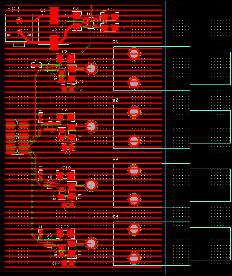

I am developing an expansion board for the Mistral EVM. I was wondering if someone could look at this initial SPDIF output schematic and pcb for me and see if they can spot anything untoward.
McASP DIT mode outputs 3.3v from the DSP serial pins and I wish to output to 75ohm rca spdif. I am using a buffer to convert to SPDIF spec voltage (74LVC1G125) with a shared psu across all four drivers (LP2985).
http://www.lucidchart.com/publicSegments/view/4ef11fc8-9260-47af-8ff1-4c990a7cca9e
Let me know what you think. I've attached the pcb layout also.

My only comment on the layout is leave room for stiching vias, and put one next to every component pad that goes to ground.
Also at the ends of any copper pours that run between tracks, this avoids any diopole structures being formed by the copper pours.
Some info on them:
http://ecadigitallibrary.com/pdf/57thECTC/s08p7bf.pdf
MTI TN1014 Stitch Vias
Printed Circuit Design & Fab Magazine Online
The only other thing is copper pours between the pads of small chip components (caps and res's).
I do designs both with and without copper between the pads of these small chip devices (0402...0805's), whether or not to pour between the pads depends on:
PCB bare board costs, having larger gaps and more tolerance for solder mask and copper feature to copper feature
can greatly reduce the cost of a board. Tighter boards cost more as the manufacture has to be more closely monitered.
As this board will probably have to have some impedance controll for the DDR interface, this may not be an issue.
Assembly method, if the parts are going to be hand placed, then again it is better to allow more tolerance for any miss
placing of small chip components. This is all down to the size and accuracy the solder mask is placed. With copper between pads of components
I have seen exposed copper on boards due to solder mask being increased to much and misregistration when imaged. This
has caused shorts between a pad and the ground pour, which with a decoupling capacitor is interesting.
