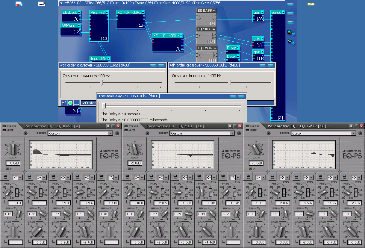

I love the DSP user interface on the KX-Project. It's extremely intuitive and they make it easy for others to create plug-ins (DSP processing blocks) that you may connect together to realize routing and processing. I think ease of use is the primary goal here as well as the freedom to design custom processing blocks.
Web interface sounds like a really good idea. Or even just having the Editor run on a remote computer.
