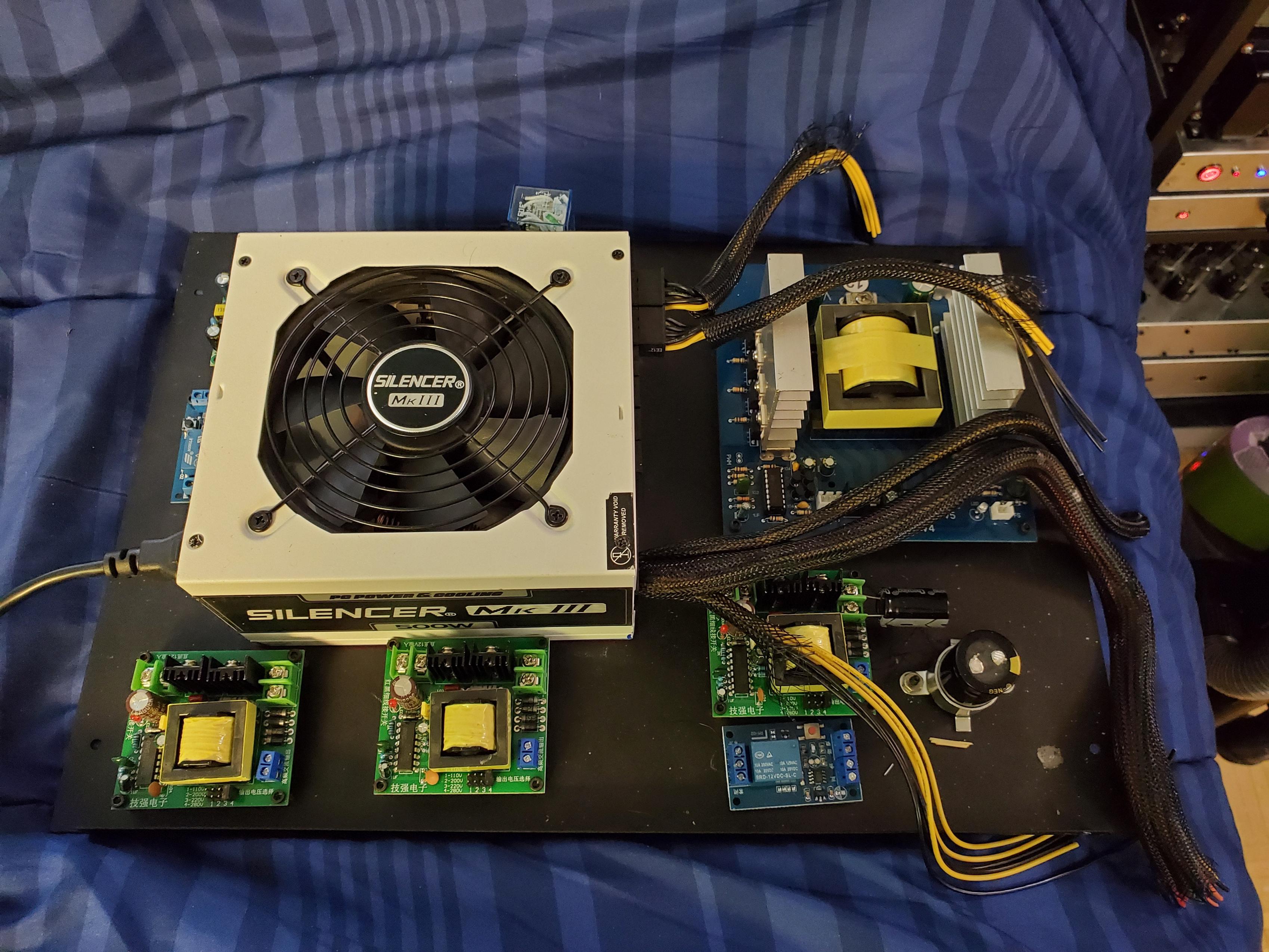

Right now, I'm listening to a preamp and a power amp powered from a 850W 12V ATX computer power supply and several DC-DC boost converters. No noise. In fact, the buzz from the 60Hz power transformer from my only amp that uses an EI power xfmr is much louder than even the fan when it even spins.
I'm building a new integrated amp using the same idea. I'll start a thread when I get further.

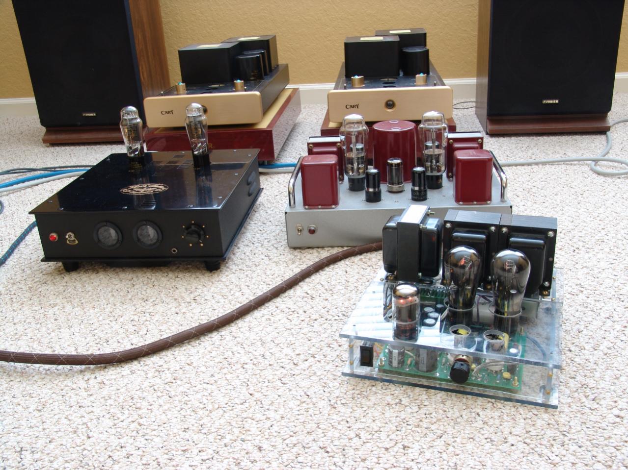

Some of us didn't get that memo...….here you will see some 91 year old NX-483's running on an old school transformer / 5AR4 power supply. But in between those WE-417A's and those old NX-483's you will find a very modern CCS load and MOSFET buffer, since it is the best circuit for the job!
A well designed and executed SMPS can be a useful tool in the quest for good sound. However the knowledge and skill set needed to pull one off, especially at vacuum tube voltage levels, is not well understood by most of us in the DIY audio community, myself included, so I stick to what I know, and keep learning (and blowing up parts) until I CAN pull off a good SMPS.
