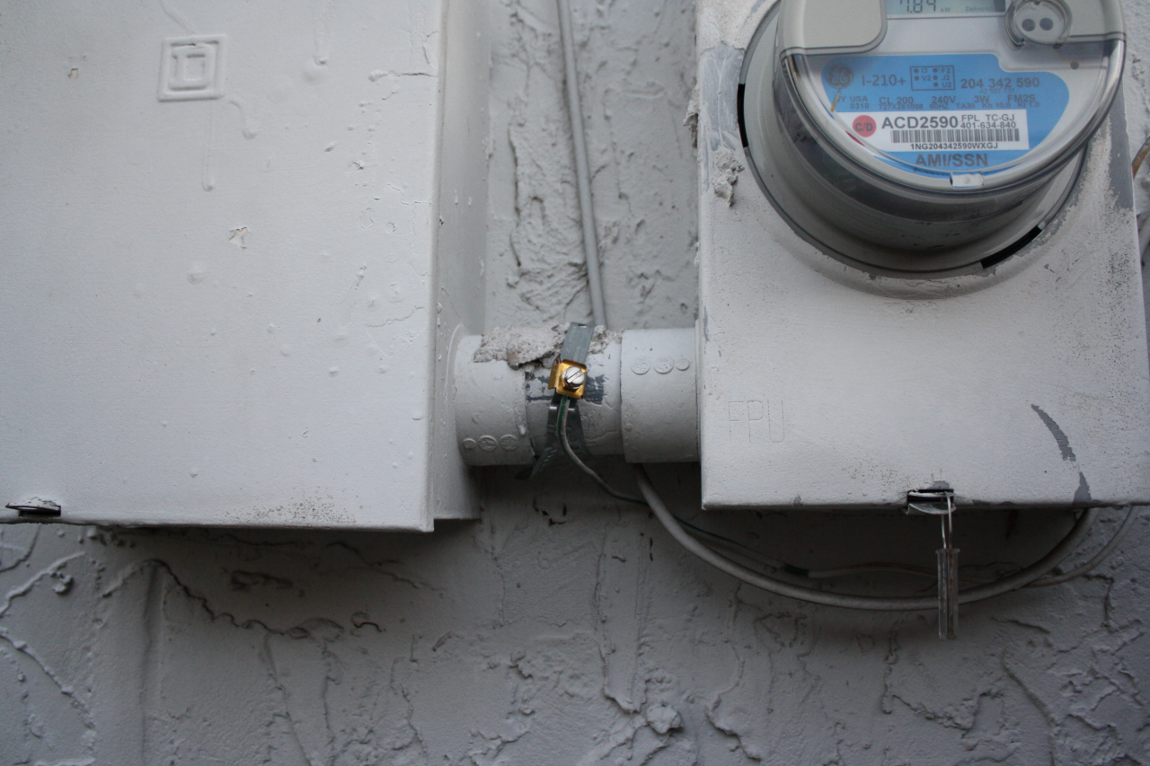

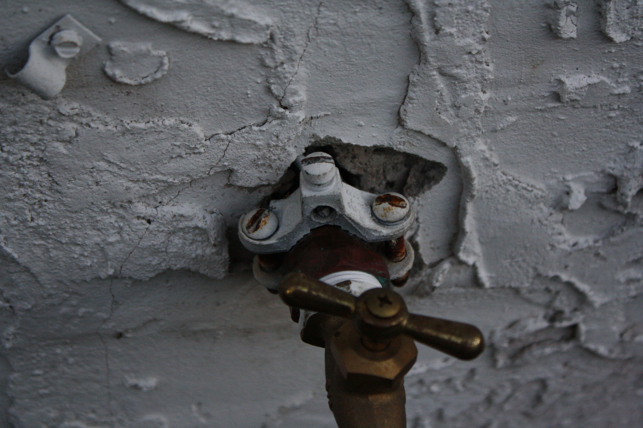

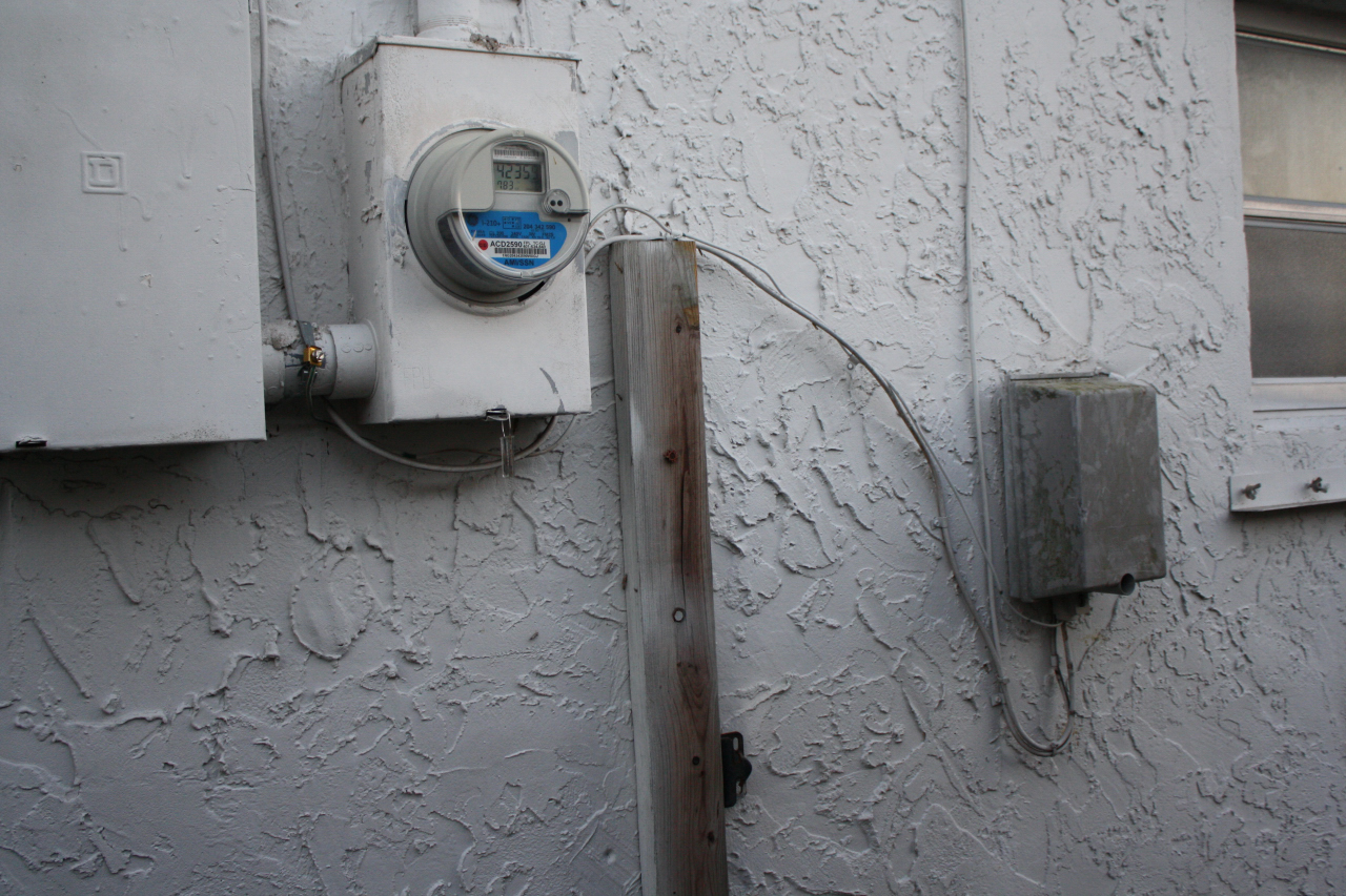

Several years ago when I lived in Florida this happened:
As I was leaving for work one morning two young guys walked past me and headed toward my back yard. I stopped them and asked what they were doing. One of them told me that they were contractors for Comcast, the cable TV company, and they had to check and possibly upgrade the "ground bonding" for the cable TV drop. He replied that they had to "bond" to the power company ground, not the water pipe ground. They looked legit, so I left for work.
A got home late that evening and found that the TV no longer worked correctly, there were 60 Hz hum bars in the picture and a loud buzz in the sound. I decided to disconnect the cable TV box and try over the air TV. When I disconnected the cable box from the TV there was a spark, and I measured about 40 volts AC between the TV and the cable box. OTA TV worked fine.
I decided to see what the idiots did to the cable TV hookup outside.....
The first picture shows a clamp on the copper plumbing fixture where two wires were previously inserted. They had removed the wire on the outside of the clamp that provided ground for the cable drop. They did NOT retighten the clamp on the wire that runs under the stucco (visible inside the clamp) which provides the ground for the AC power drop, that is bonded to the neutral at the breaker panel inside the house.
This left the house UNGROUNDED! This is an older house with another one of those technical disasters called "shared neutral" wiring. One loose wire can blow up lots of stuff when two 120 volt phases are wired in series across 240 volts and the neutral goes open.
The second picture shows how the "experts" ripped the wire off the water pipe, cut it short and connected it to power company ground. The cable clamp that used to hold it to the wall is now left hanging loose with no screw in it. That wire left unconnected in the clamp on the water pipe......goes underneath the stucco, inside, and connected to, the metal box containing the 200 amp breaker for the house...IE house ground. The ground wire for the cable system is now connected to a clamp on a pipe going into this box.....exactly the same ground!
The third picture shows their attempt to scratch through several layers of paint so that their ground clamp could get a good connection. This scraping revealed something quite obvious to me, but not to the "experts". An ohmmeter revealed the obvious. The experts had "bonded" system ground to a PLASTIC pipe.
I had already had several incidents with Comcast's service techs, so I decided to play hardball this time. First thing the next morning I called their service number and explained that I had been shocked by their cable box, and I investigated the problem and found it to have been created by one of their contractors who had been working all over the neighborhood for the past few days. They had created a National Electric Code violation which could shock or possibly kill any of several customers who had received the same treatment. I explained that I was leaving for work in 20 minutes, and if a QUALIFIED Comcast tech was not on site before I left, my next call was going to be to the city code compliance office, followed by the county code compliance office.
In less than 10 minutes a Comcast tech was on site. He made the situation legal with a wire nut splice in the ground wire from the Comcast box on the outside of the house back to the original water pipe ground. The new ground wire contained a splice and was not secured to the house. Someone would come back and do it properly within a few weeks. It was still the same when we sold the house and left Florida almost two years later.
I came home for lunch that day to find several Comcast vans in the area. They were all busy undoing the previous contractor's work. The water piping in that whole neighborhood is all copper, or cast iron. We were less than a mile from the Everglades swamp. The water table is less than 5 feet down all year round, so a pipe in the ground is a good ground.....not as good as my buried engine block, but that's a different story.
