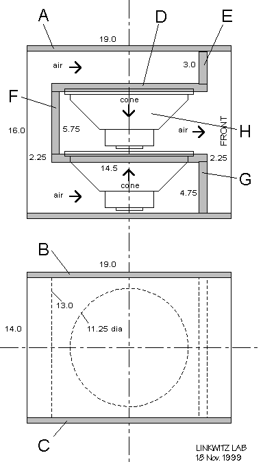

I'm using Pioneer/TAD beryllium ribbons. They are quite good. I have been considering the MTM configuration lately. The problem being I would need to pad down the mids. Thats something I've worked really hard to avoid up to now. Do you think the trade off would be worth it? I could wind up some non inductive silver resistors for the job.
I'm also considering switching to a W frame dipole like this one from S. Linkwitz.
