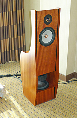

Lucky guy to be able to compare the two. It should be remembered that SL was a classical music lover first with his reference being the SF symphony so he designed speakers with imaging being a prime driver. They were not (to my knowledge) optimised for all types of rendition...
Admittedly, there are many comments about his preferences / tastes in music.
I think classical music in general is an excellent reference point.
It is also true that the vast majority of music today is a far cry from the golden age of classical, jazz, etc. in terms of recording and production techniques > krivium could probably write a book about it.
Linkwitz designs are somewhat more WAF-friendly compared tho the big BD horns, though I personally much prefer the looks of the latter.
Core aspects are both simplicity and sensitivity (headroom). With those 2 basic elements properly implemented, only the quality of the recording is the bottleneck.
