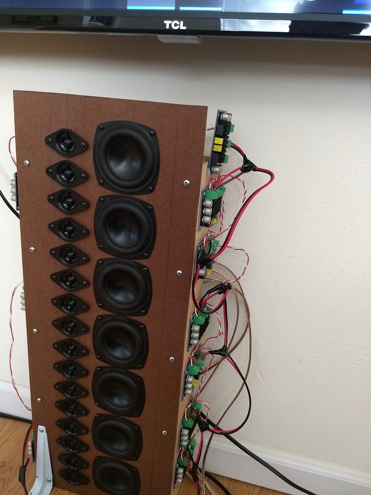

I have ten amplifiers on this speaker that cost $1.50 each (in bulk, before amortizing cost due to failed boards.) Maybe somewhere around $1.65 after I eat failed amps. Cost could be as high as $1.80 per amp. But it's a joke because it's so insanely cheap even if there's a high rejection rate.
Because I use DSP + individual amplification I can build an array or column speaker on a whim. Stick a microphone on it and flatten frequency response to get the result Floyd Toole explains above. Consequently, I can think more in terms of soundfields than sweating over crossovers and frequency response.
Also, I think there's the matter of enjoying sound (music plus movie dialogue.) Building with DSP + amps = really good speakers with very little effort. That leaves more time to enjoy what comes out of the speakers. I think if you build good passive speakers you probably need to be in the mindset of a nitpicker. It seems like sort of a negative mindset that doesn't allow you to enjoy the music without criticizing some obscure failure in the design. With DSP if I hear something I don't like I just click a few things and it's gone. No doubt that causes problems in other places but I'm not listening to those problems at the moment so it doesn't bother me.

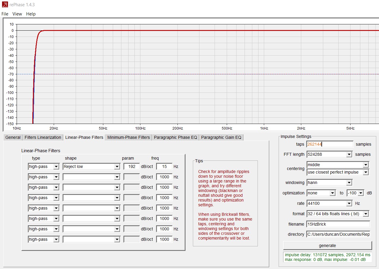

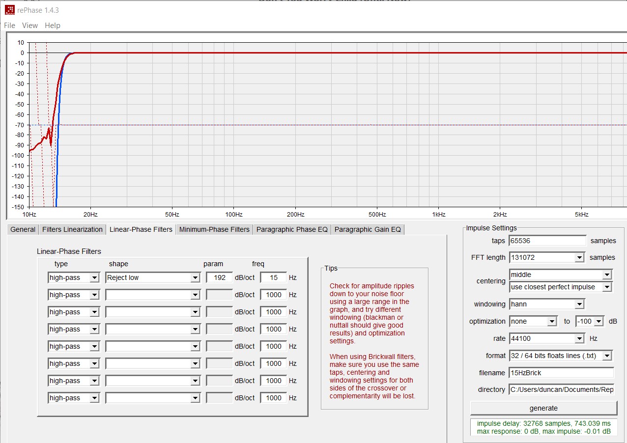

Here are a couple of screen shots that demonstrate that really high tap counts might be called for if you ask for extreme filters.
I don't know if this is the sort of thing plasnu was talking about but it might illustrate the point. The screenshots show the difference between 65536 and 262144 taps on a 15Hz 192dB Highpass at 44100. When you don't use enough taps to properly describe the filter you can get some horrible phase issues outside the passband.

But Wow, that's pretty extreme alright !!!
Brick wall at 15Hz ?? 😱
Well, i'd sure love to have the subs that might need one 😀
