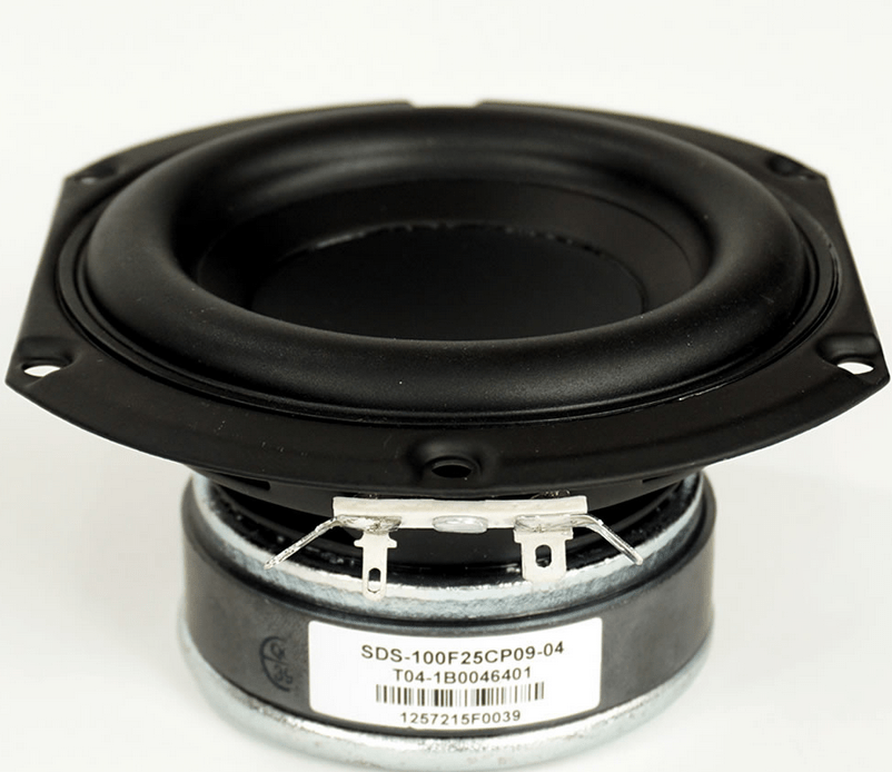

I consider this pretty basic.

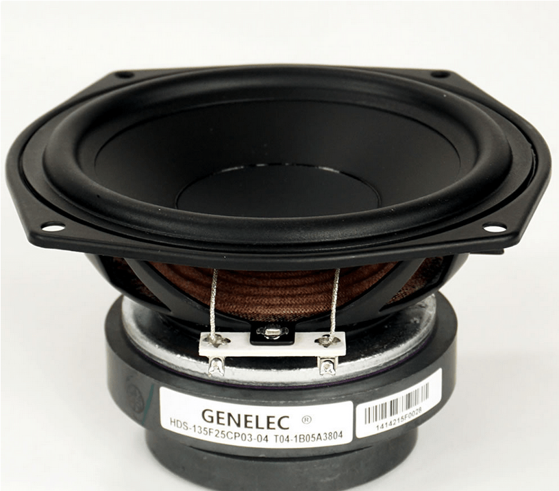

I don't know if they have shorting rings, although even in $15 drivers that is possible (these days).
I have read that this one is also Genelec, although I don't see any markings on it.
(have to investigate)
The Peerless TC9 has a shorting ring/cap which is very impressive for a $15 driver obviously designed for a sound bar or TV application. It also has a vented spider and a decently rigid polymer/FG reinforced basket. I think its the best sounding limited LF fullrange for under $50.

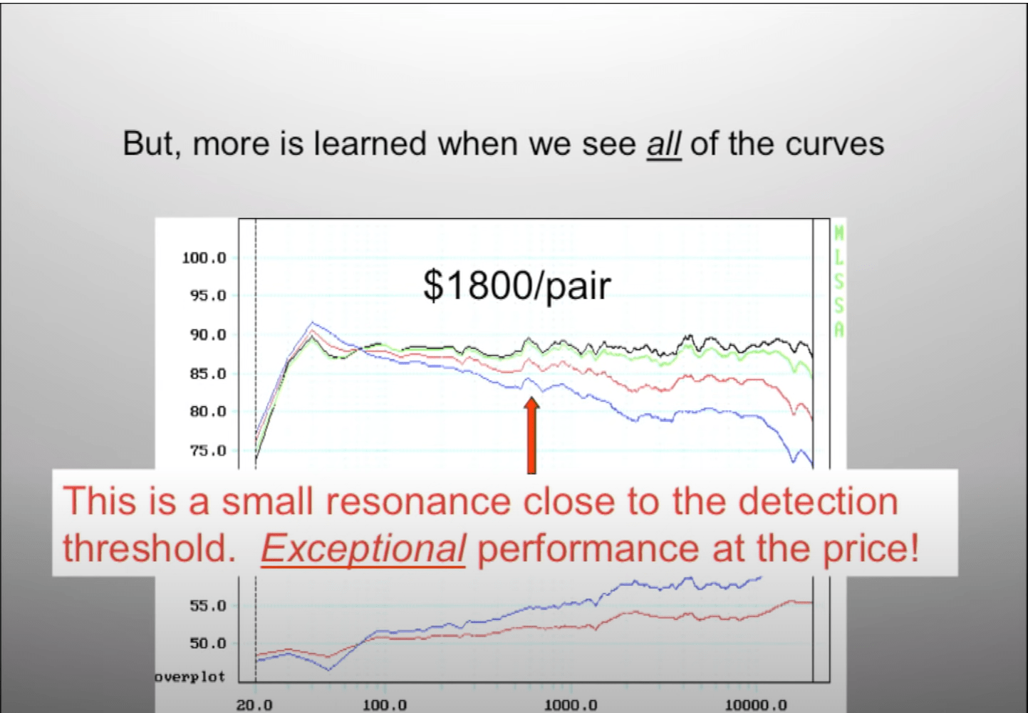

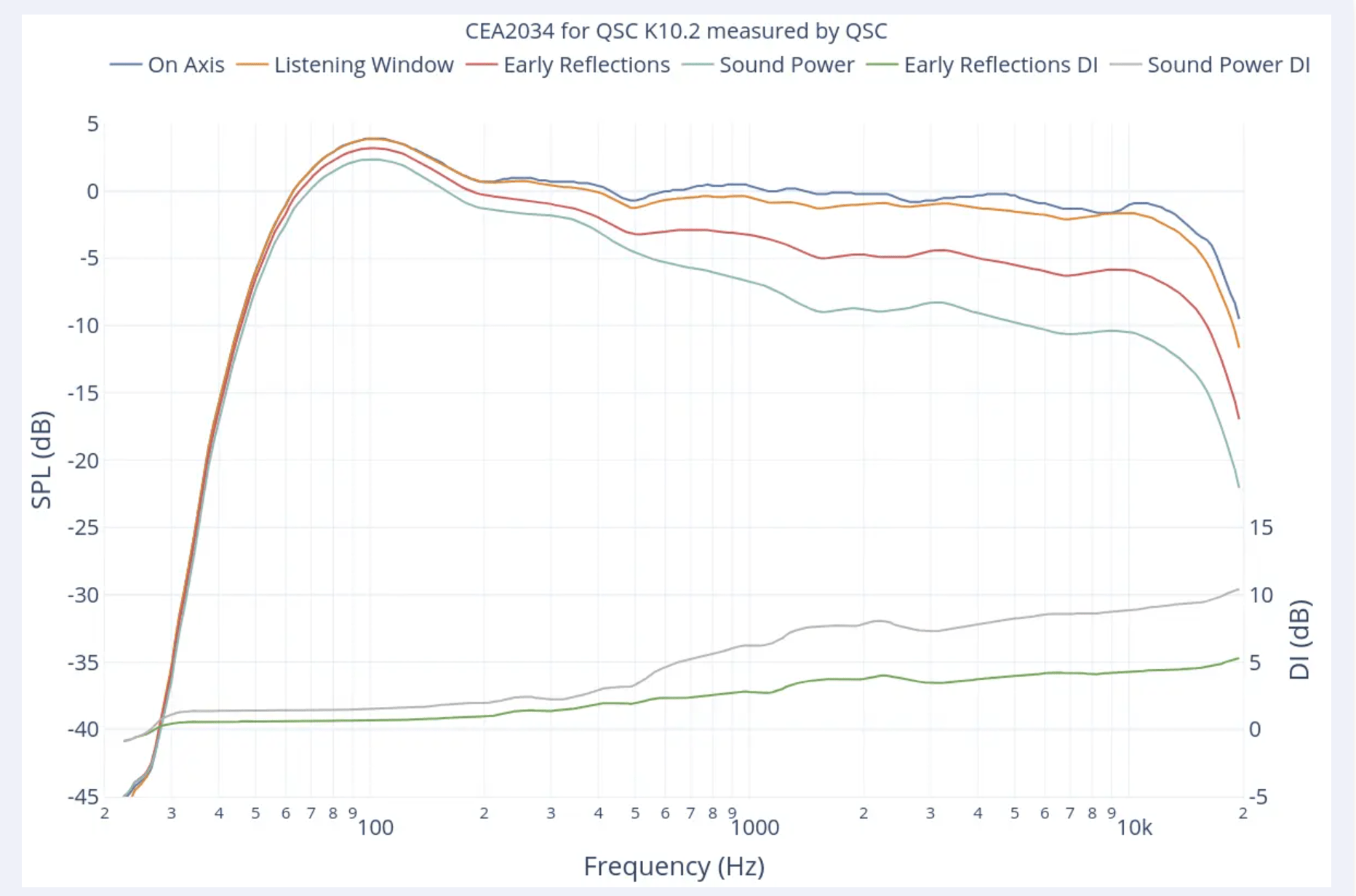

When we say ruler flat, I think we can safely that that ruler flat on axis, is not as important as we once thought it was.

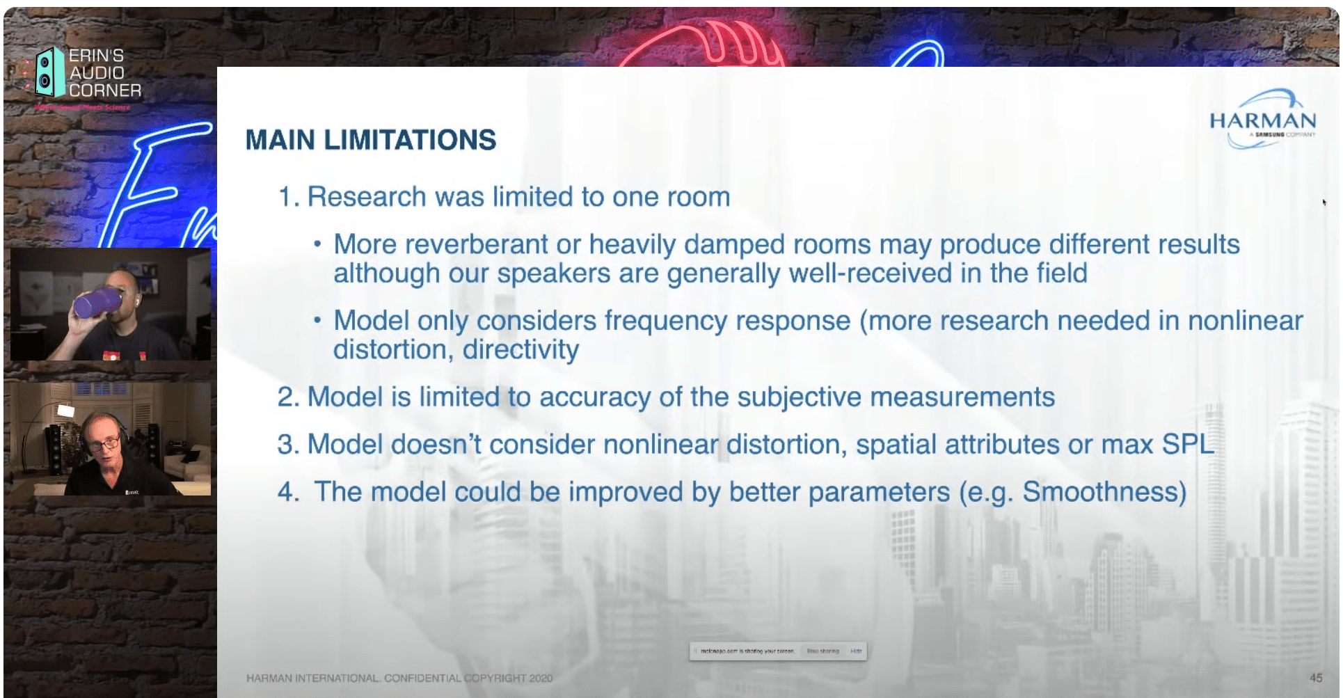

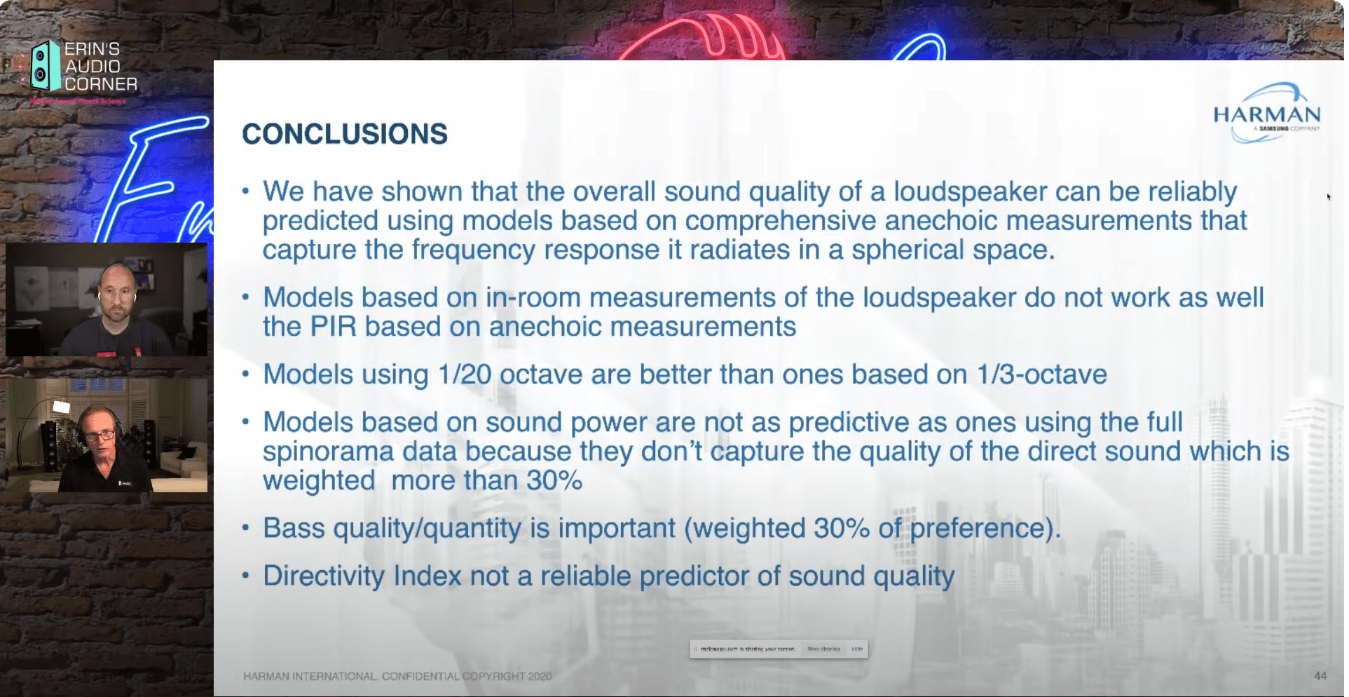

Here's what Sean Olive said, a couple of years ago, about what matters, based on their research in the late 20th century
For brevity, I draw your attention to main slides at the end-
The whole review-
Initially I posted some graphs of some real.. err... under-achievers. Then I thought- Nah- you can watch them here:

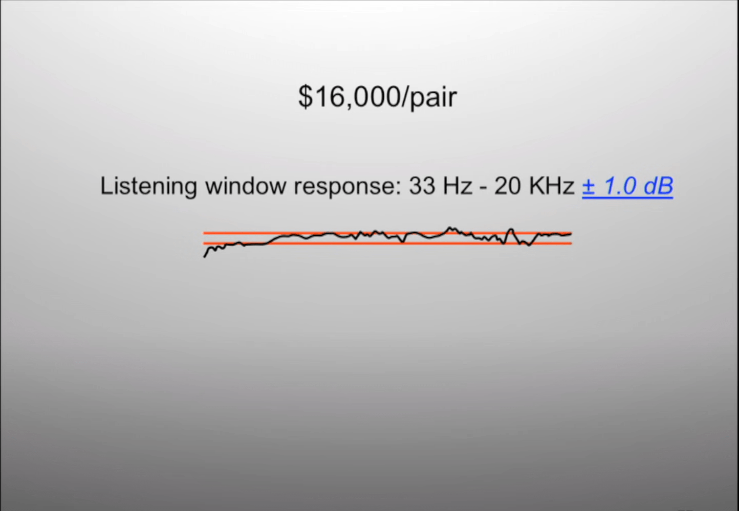

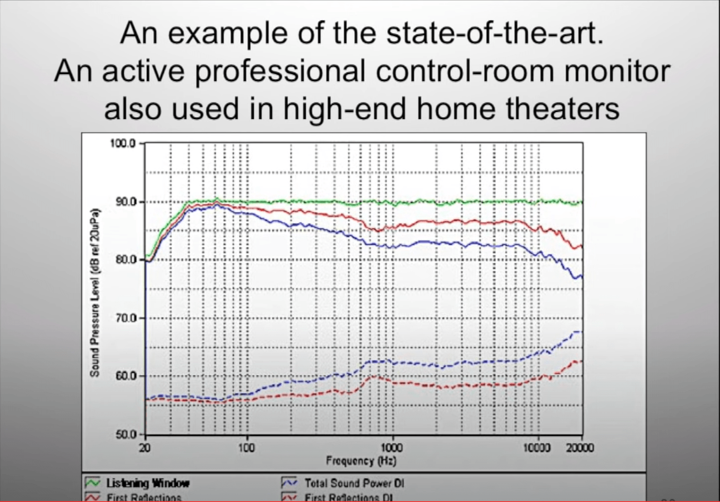

I'm reminded of what Floyd Toole's said, during a lecture at the Centre of Interdisciplinary Research for Music Media and Technology @ McGill University in 2015. He shows the spec of a speaker, with a +/- 1dB frequency response.
Listening window 33Hz - 20 KHz +/- 1.0 dB
Now THAT is as close to ruler flat as one can get.
Floyd went onto say-
"Now this is an interesting one. +/-1 dB. Now that's getting serious. That's an audacious challenge. And they... just... squeak in, just squeak it (the +/-1 dB spec) barely. Boy! That's a.. that's a brave thing to do. And I'll tell you why it's a brave thing to you. One of the fundamental problems of the loudspeaker industry is.. that... the consistency... it's one thing to design a golden prototype.. and you might get lucky and do a really good job on that, it's a very different thing to clone that in mass production. And uh, you know, when we do some products, this is one, where we guarantee that it's within spec.. and the only way we can do is to guarantee is that we spend a LOT of money in the production process. (retail price is US$16K/pair in 2015) That's part of what you're paying for, It's the consistency."

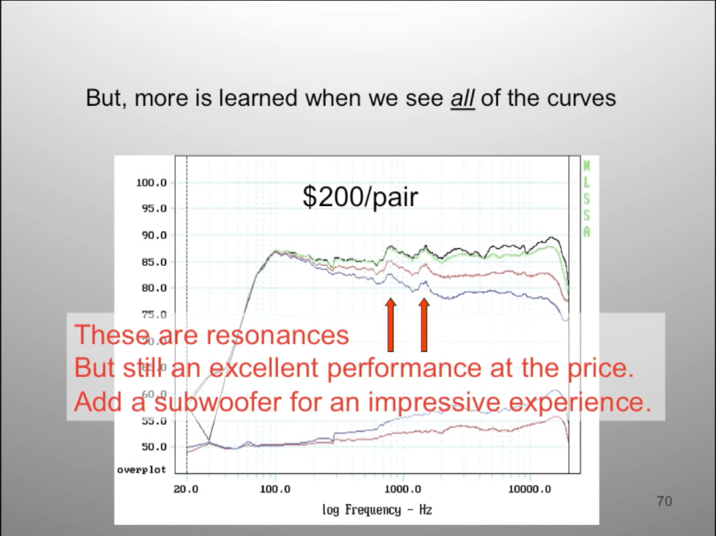

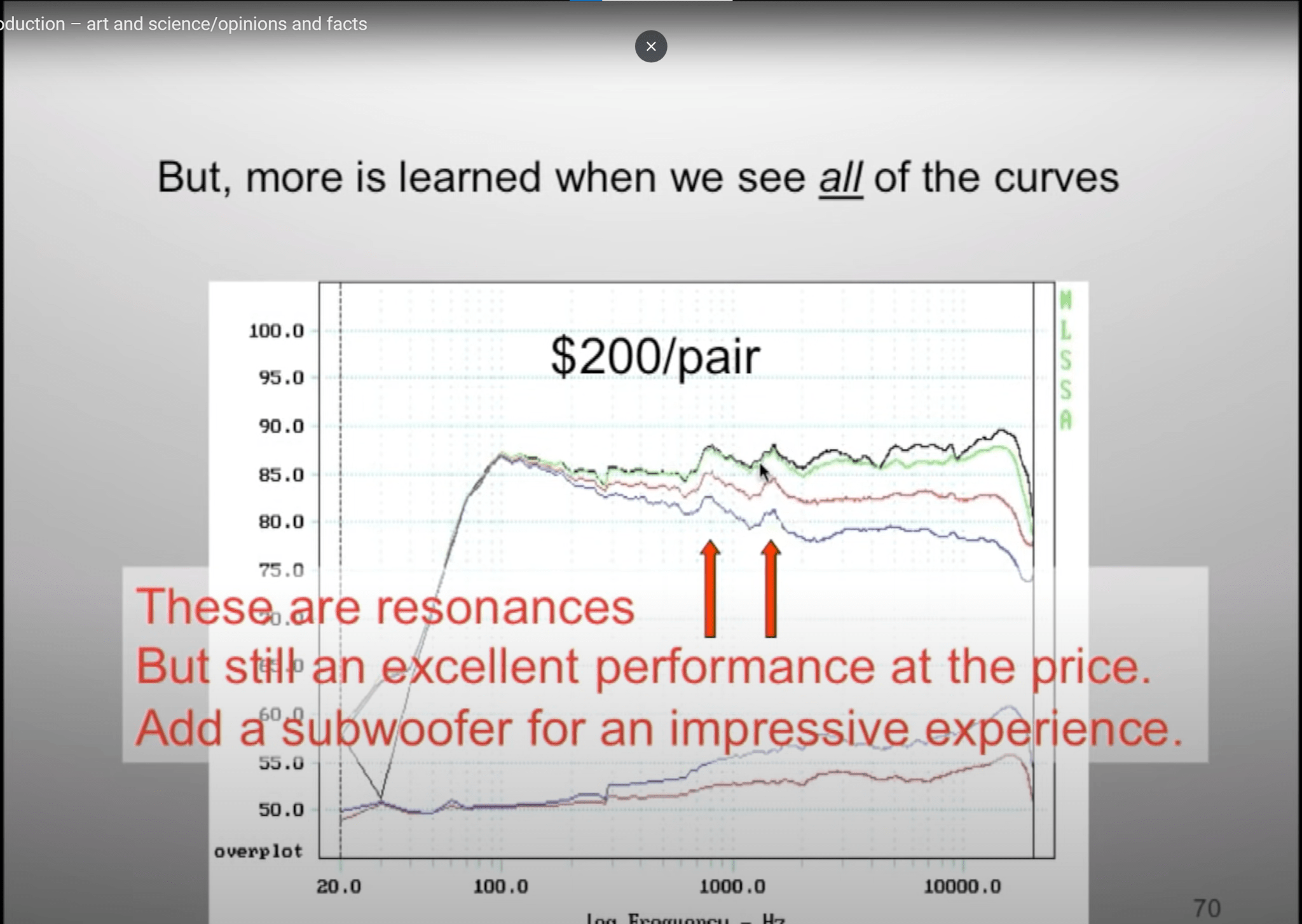

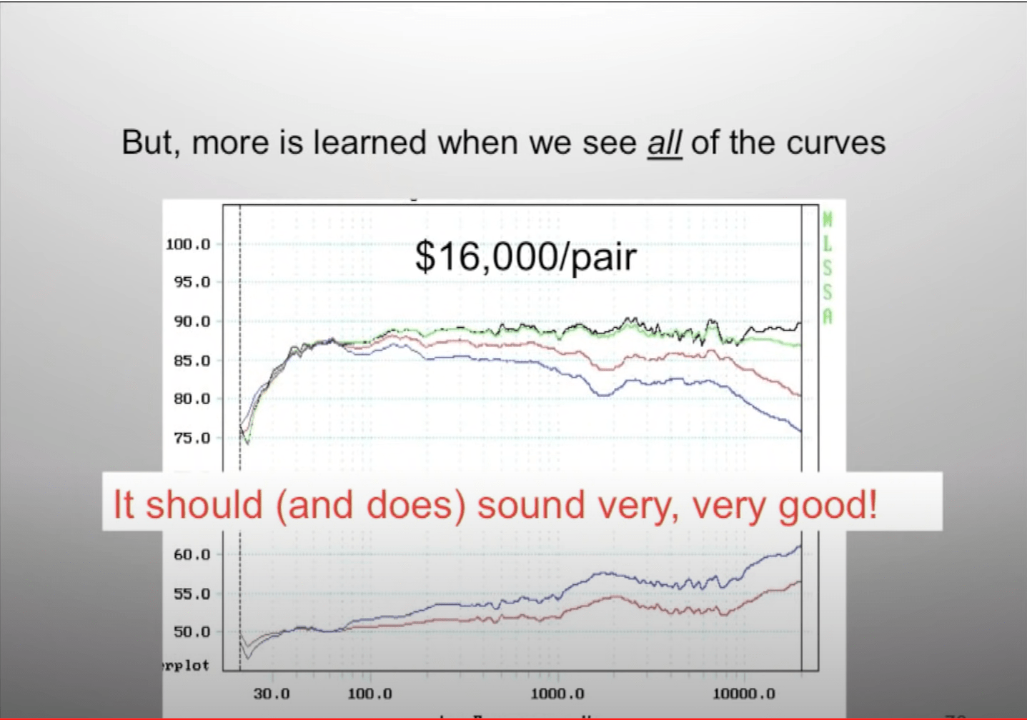

Here is a base-line for a cheap, but reasonable loudspeaker US$100 ea-
"Loudspeaker transducers are minimum phase devices, now that is really technical jargon, but I'll quickly explain, it means basically that if the frequency response, the amplitude response, is smooth and flat.. smooth, no bumps, then there's no resonances. If you see a bump, it will ring. Now if you can have an equaliser which can match the little bumps and get rid of the bumps, then the resonances is gone. There's no more ringing. You've corrected the problem. So this is one of the reason why active loudspeakers, with built in amplifiers and digital electronics, are, I would hope, the future, because that's the only way we could really make SUPER good loudspeakers..."

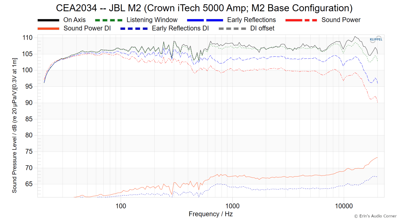

Here's the M2, as measured by JBL/Harman, pre-Klippel NFS
Same model, as measured by Erin, with his Klippel NFS:

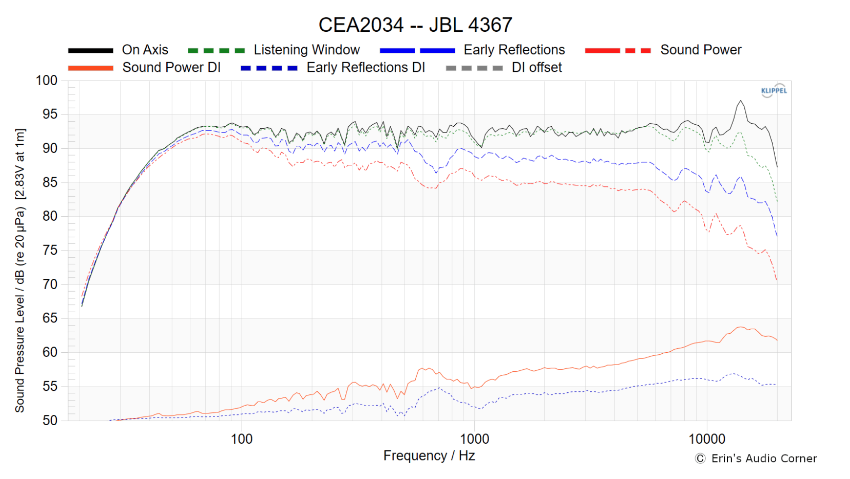

Reference:
https://www.erinsaudiocorner.com/loudspeakers/jbl_m2/
OK, it's it's not quite as smooth as Harman's graph. Now before we debate whether its a design issue or unit to unit consistency issue, or production issue, a Harman vs Klippel's NFS measurement resolution issue (all possible reasons for a very smooth vs less smooth measurement, particularly around 400-600Hz, here's a newer (post 2015) JBL speaker, as measured by Erin:
Reference:
https://www.erinsaudiocorner.com/loudspeakers/jbl_4367/
So the 4367 is is arguably better than the M2.

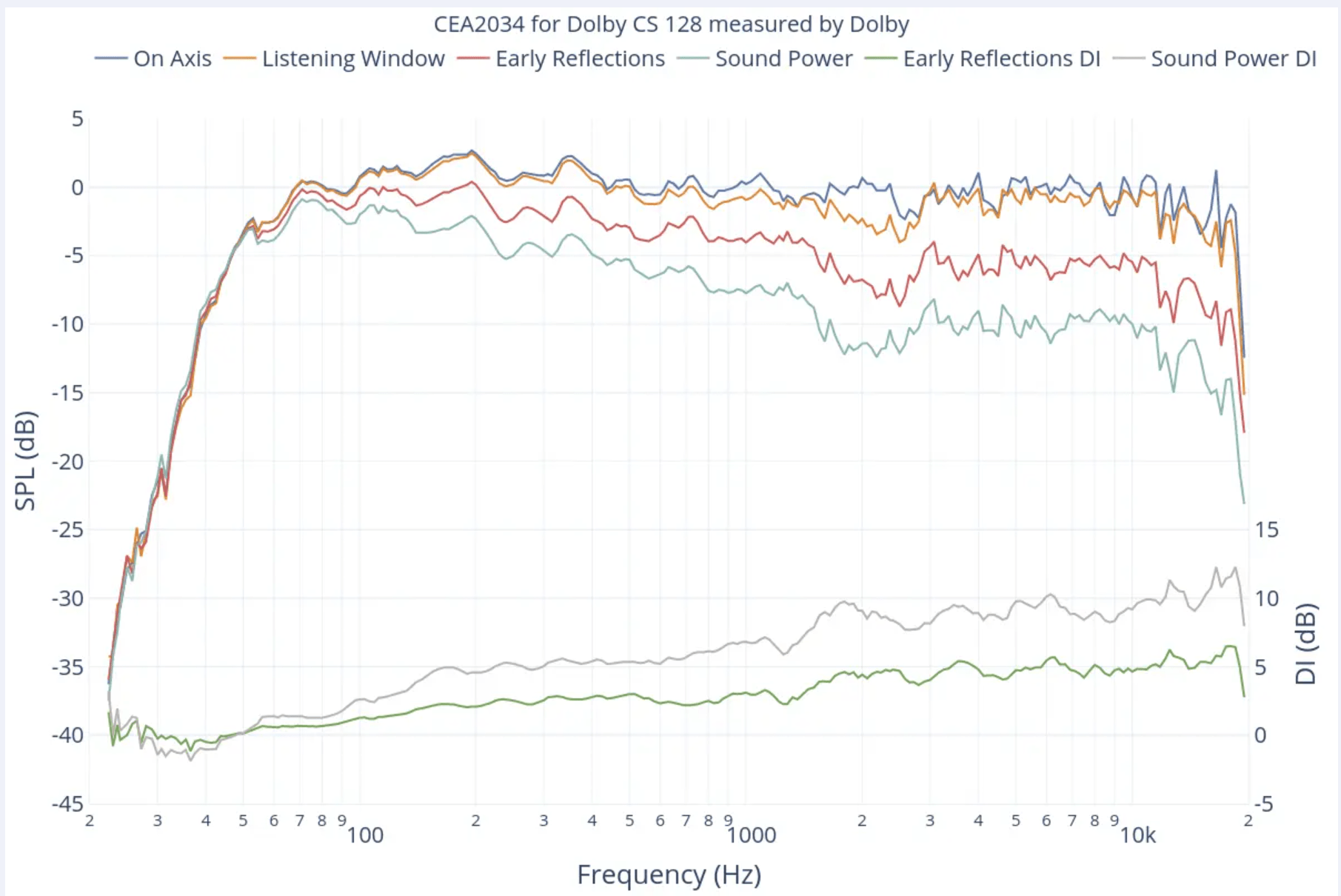

Won't play loud enough for you intended listening area? What about this?
Here's one from Dolby.
https://www.spinorama.org/speakers/Dolby CS 128/Dolby/index_vendor.html
Before Danny suggests that he could "improve" this one with his boutique crossover parts that he sells, perhaps he should take a more than a few heavily smoothed measurements. 😊

(1) Some manufacturers spend quite a bit of time to measure and tune their production loudspeakers to match their golden design. Then they keep track of the serial numbers in case they need maintenance or repair down the line. This all costs money, but surprisingly not so much if it's done as a "production plan" not a post production QA repair.
(2) That guy measured the Maggie 1.7s with some mean dip... but I wonder, how did he get that measurement? Was in a close in @ 1 meter measurement or an in room power measurement? Does he take into account how the speakers are designed to power the room?
(3) In the 80s I bought an equalizer with a built in spectrum analyzer, pink/white noise generators and a calibrated mike. I proceeded to equalize my speakers flat from my listening spot. I hate it. So, my next step was to use the analyzer, white noise and mike to move my speakers around for the smoothest sound and then put a finishing touch by ear. It turns out they ended up very close to the starting point. After that, I put the equalizer away and never used it again.
Dave.
As you probably know, as I was taught many years ago, "As soon as something is published in a textbook, it's already out of date"
That might sound like a cynical comment, but what that sentiment means, is that by the time all the research and data is gathered and collected, peer reviewed, and analyzed and digested, written into chapters, edited, proof read, gone to the supervisor, backwards and forwards and edited, then to the publisher, etc. well that's usually in time period of YEARS to DECADES. So by the time it's published into a book form, it's already out of date.
So I assert that half of what is published in Floyd's seminal textbook is wrong. Or more fairly, in 2023, half of what is that book might be be not quite right. The problems is that we just don't know what half.
It's like the thing about THD. Ok so we know it doesn't correlate well with listener preferences. Let's be honest. It's a crapshoot.
But does that mean all forms and levels of harmonic distortion are irrelevant? I don't think that's the same thing.
