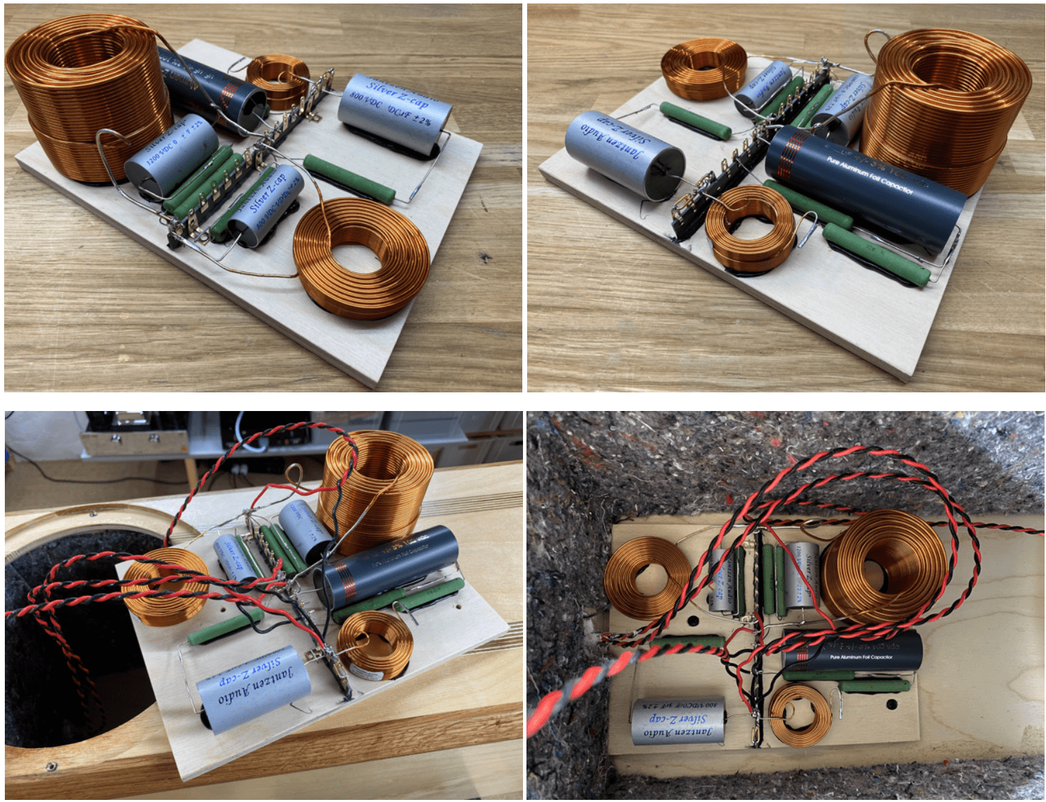

This is the exact opposite of my experience.My personal experience is that crossover component quality upgrades can make a huge difference... cheap speakers have atrocious crossover quality. Speakers with decent-quality drivers can always be improved immensely, just by upgrading capacitors, the cored-inductors with air-inductors, and internal hook-up wiring.
These guys use pretty decent-quality components...
I used to make inductors from annealed silver ribbons 🙂
These days, the PA active speakers are the way to go... but not many high-enders are ready to put those brand-names into their systems.... egos at at play here.
You can get excellent performance out of basic crossover components, with the right component choices, that don't cost all that much.
You can also spend an absurd amount on boutique crossover components that will only sound marginally better, if at all, compared to well chosen basic crossover parts.
Troels likes to push the absurd end of the spectrum as he makes profit from selling crossover components in one way or another.

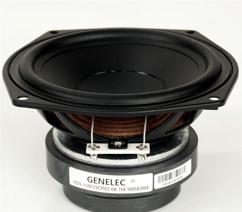

Genelec has figured this out for years (decades?)
They use extremely basic Tymphany/Peerless drivers.

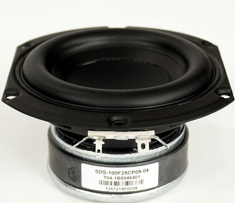

I suppose it depends on what you mean by basic. I was under the impression that the drivers they use still use shorting rings. At least the distortion measurements I've seen show as much.Genelec has figured this out for years (decades?)
I consider this pretty basic.
I don't know if they have shorting rings, although even in $15 drivers that is possible (these days).
I have read that this one is also Genelec, although I don't see any markings on it.
(have to investigate)
