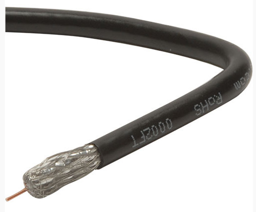

Yes, this is what Comcast, Dish run locally and available with F connectors in various lengths or in bulk at Lowe's. Don't know about Home Depot.

anything that is flexible has gotta be good if you need that sort of thing, I prefer my coax to be rigid though, as I've said in a previous post I was using RG-58 (flexible) on an RCA connector for a while and noticed just how little of an improvement it made to the sound over the cheap $12 rca cables that I bought, but it was an improvement none the less.
Now that is compared to cheap chinese rca cables, which considering the RG-58 was unused Antenna cable and cost me nothing was a good bonus, So I am going to not take any chances and simply use the RG-6 that I have on hand, but yes braided center conductors are a lot more convenient!
Which might sound silly to most of you, me using RG-6 quad over RG-58 or some other flexible coax? he must be nuts!
We should make sure that everyone who participates in this thread understand that the reason for me using RG-6 quad was because I had it on hand and because I have a fondness of the BNC connector vs RCA and that I wanted to go as large as possible with BNC so as to remove the possibility of RG-6 having a benefit over RG-58 when it comes to shielding.
There might have been a fondness of having a low as possible ohmage center conductor in there too. I like copper tis all.....and so does electricity it seems.
I live in a very RF active region having smart meters behind me and computers infront of me, 240v mains cabling through the walls around me, and cell phones on my desk, oh and ham radios, various ethernet cables strewn everywhere, dimmers, microphone cables, antenna leads... I could go on.

Well I have settled on RG-6 for now and will be seeing what slight improvements if any that will be making as I intend upon installing them in my current amp and the tube amp that is soon to arrive.
