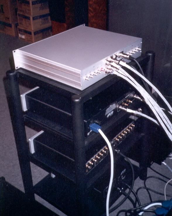

I have thought about buying a few feet of Belden 1694A for my new interconnects.
My problem is trying to find silver body Bulkhead BNC Females with teflon dielectric and a gold plated pin.
I can find all sorts of other combinations of build materials.
For that matter RG400 50Ω Coaxial is very good for mating with BNC connectors.

Well I have settled on RG-6 for now and will be seeing what slight improvements if any that will be making as I intend upon installing them in my current amp and the tube amp that is soon to arrive.
I'm pretty sure that adding or removing capacitance and resistance to a circuit no matter how slight will affect audio especially at line levels of 1vPP, I'm just disappointed that there isn't a standardised open sourced testing database for cable materials and connector types.
As for bnc affecting electrical response of audio signals I think that it matters a great degree to the amount of friction that is applied to the center pin and what the center pin is made out of.
Now the reason why I am bagging RCA is because there is so much incredible variations in material quality and applied force and even resistance between one or the other on a small scale that it boggles the mind, ontop of that we are just improving on an already flawed and outdated design.
Why are we continuing to do that? just because RCA is the most popular isn't a good enough reason in my book.
With BNC I see this variation occuring far less often and on a far less scale, because the center pin on BNC must conform to specific dimensions or it won't fit into the socket and as for material types i am simply winging it, you would need a proper gold/silver tester inorder to tell if it is genuine.
Which is the long way of saying that I got sick and tired of buying supposedly good quality RCA connectors and having them break on me, getting conned yet again, with BNC there is less chance of that.
I just wish there was an easy way to do this, to know for sure that a certian material type or conductor type will affect audio quality in a certian way, but there is not, so we must live with what we have on hand which we believe will improve an electrical interconnect to the point that it doesn't matter, hence my use of RG-6 quad and BNC.

The center pin on a 75 ohm BNC should be the same diameter as on a 50 ohm one. The shield is also the same diameter. They can be plugged into each other without physical issue, other than the obvious impedance mismatch. Due to the fixed dimensions, the only way to change the impedance from the originally designed 50 ohm to 75 ohm is to change the dielectric. This is why a 75 ohm BNC (both male and female) omit the white plastic dielectric that you normally see, and uses air as the dielectric. Refer to this picture. If using 75 ohm cable, you should try to use 75 ohm BNC (both male and female). They should not be that hard to find, since they are very widely used in telecom.
