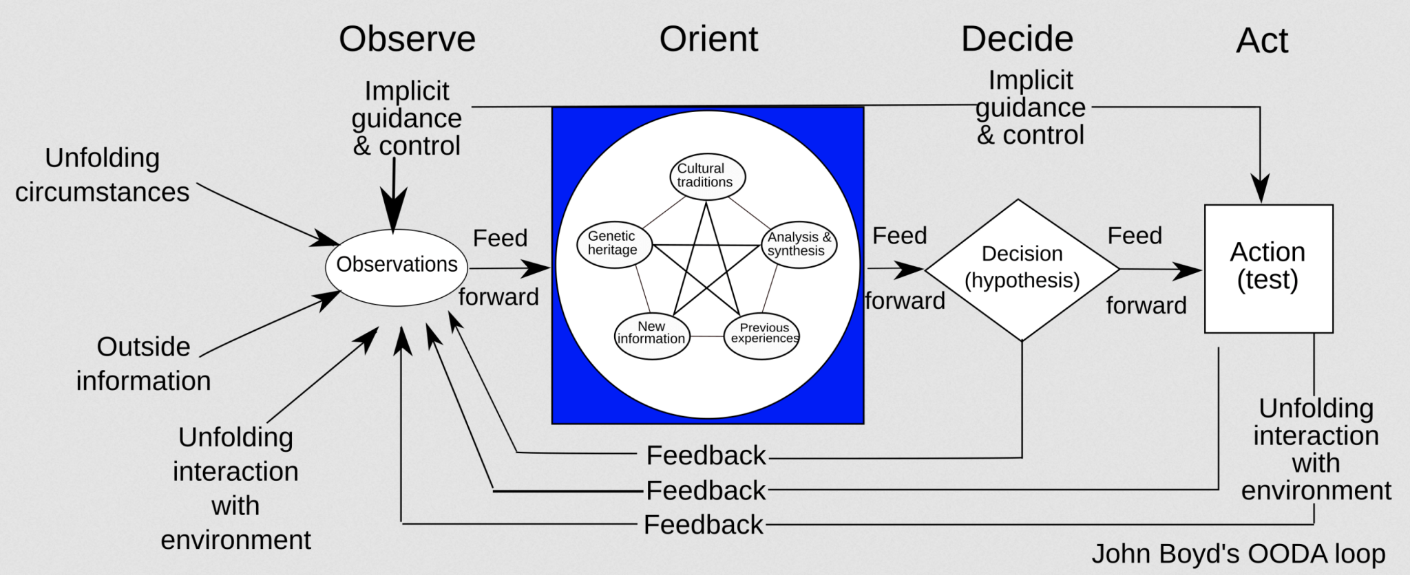

But still extremely valuable with some personal conventions applied.I personally would be wary of using threads from this forum as references for doing loudspeaker design--without some other adjudicated source to reign in the BS that I've personally encountered in the "rules of thumb" that get passed around as if they're truths.
This thread is very much about orienting.
Quoting Col. John Boyd's OODA loop is about as far from a good DIY loudspeaker design as you can get. I recommend shortening the number of design and manufacturing steps as possible to increase the probability of novice success. Boyd's writing was about aircraft combat maneuvering (something that I spent some years in--in a prior lifetime).
Designing loudspeakers first by the way that they look is another well-known recipe for failure (acoustically and/or economically). I recommend STEM courses in night school instead (and drugs to treat any existing OCPD that comes with judging things and people by the way they look).
Chris

OP is asking or orientation to resources based on observation that this forum tends to go hard-mode quickly. Based on that he will presumably make a decision on what to do with the feedback in this thread, possibly put learnings into action, then observe the quality of results and repeat accordingly. My point is that the value of this forum does not need to be disregarded entirely if it's placed within a larger understanding of one's own frameworks for learning.Quoting Col. John Boyd's OODA loop is about as far from a good DIY loudspeaker design as you can get.
It's by no means a recipe or speaker design. Substitute OODA loop with any number of frameworks/diagrams for iterative development. Or use none at all and just enjoy the hobby. I've always loved the visual metaphor of the OODA loop and it's been used as a reference in a number of frameworks (scrum, etc.) for that reason. Take it with a grain of salt.
I don’t get it. You are proposing a beginner, a novice, have a computer, software of various kinds which: may not run on their existing computer, may not be free, and they know nothing about it or the underlying science of why it does what it does. They also need a microphone of reasonable quality, two stereo amplifiers instead of one, lots of cables, and a crossover and eq box. Beginners in your world may have unlimited funding and resources but I bet most in the real world do not. For the first kit this is simply too much for the average noob.I've also found that many offered kits (flat packs, etc.) are based on designs that are quite dated. Many of these are designed around passive crossover networks only (i.e., no option for DSP use). I would personally recommend sticking to kit designs that were originally created less than 10 years ago.
